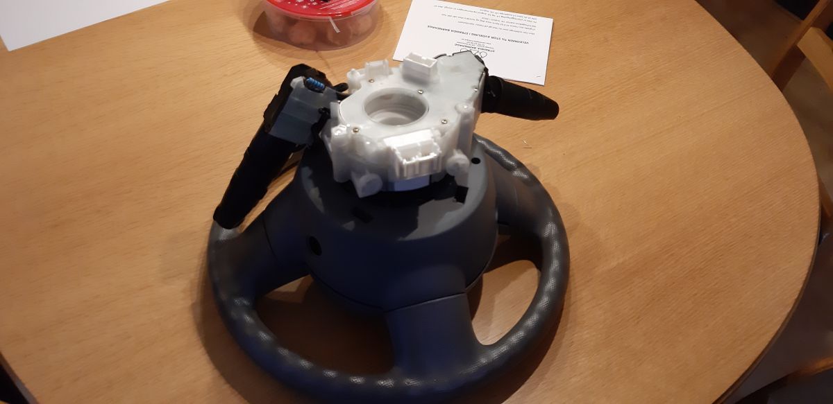

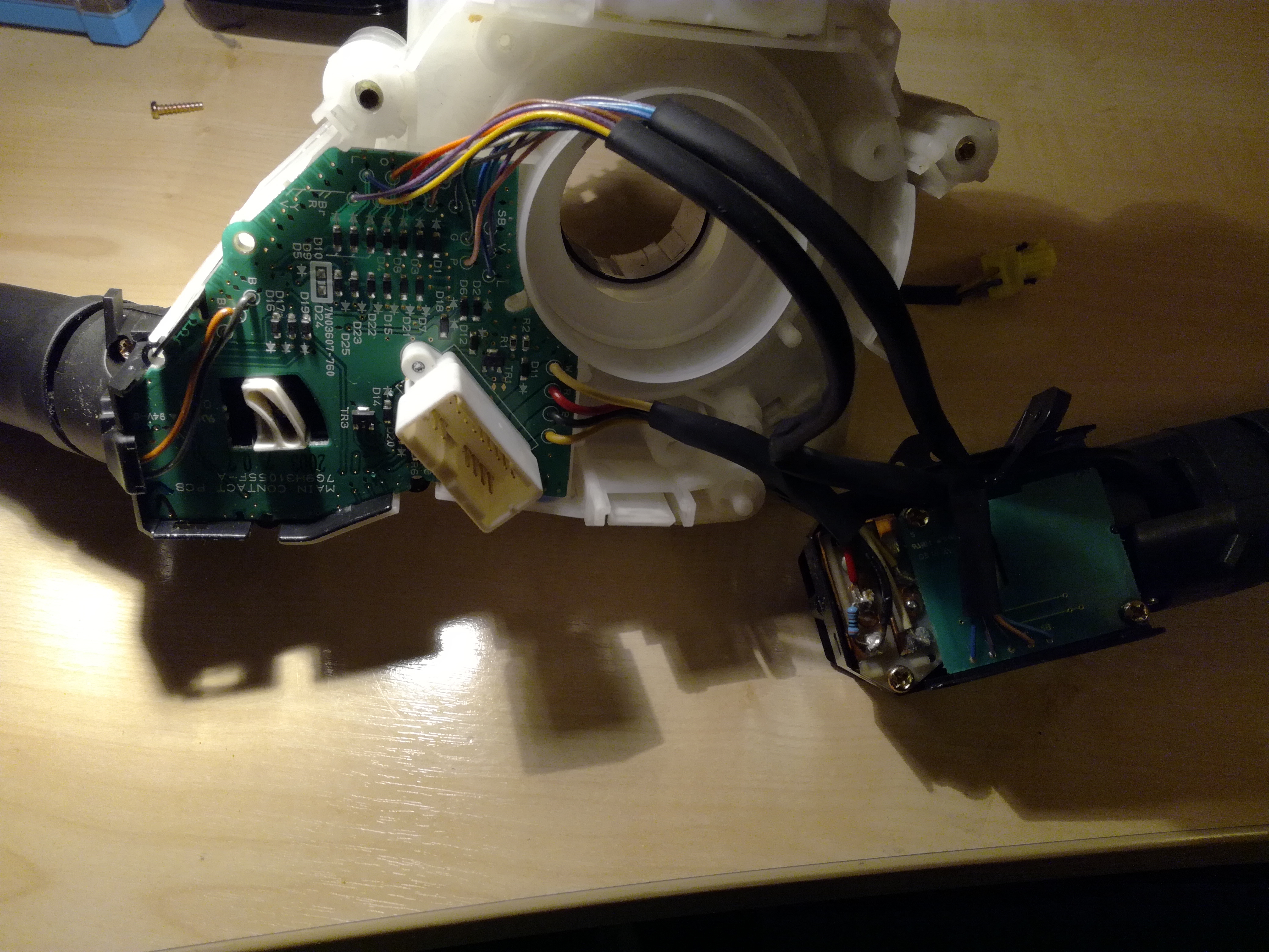

  • #5 17080515
    diakov
    The problem can be solved in a simple way by soldering the taj resistor as in the post https://www.elektroda.pl/rtvforum/topic1584294.html it was written by a colleague diodakus.
    I had exactly the same problem. The windshield wipers turned on automatically after the washer motor shorted against moisture. I soldered a 3k? resistor directly on the wiper switch board between the red and black cable, because I did not want to cut the insulation from the cables. These cables are the mass of the washers and + 12V. There is a lot of space on this PCB to solder this resistor. I attach photos for better illustration. After soldering the resistor, the problem never happened again and I did it over two years ago.
    best regards

    Rid up the topic, I just wanted to confirm that the resistor method works. I thought it would take place without removing the steering wheel, but unfortunately not. On the plus side, everything went smoothly and without problems. It started with the fact that with prolonged use of the washers, the wipers started to run automatically and recently, with heavy rain, the wipers turned on immediately after starting the car and this decided to insert a resistor in the system. 2004 Nissan Micra K12: Unprompted Activation of Front Wipers After Rainfall or Car Wash 2004 Nissan Micra K12: Unprompted Activation of Front Wipers After Rainfall or Car Wash
  • #9 18377241
    dawid5995
    My joy came prematurely. After installing the resistor, the battery is discharged overnight, where previously there was no problem with firing even after long stops ...
