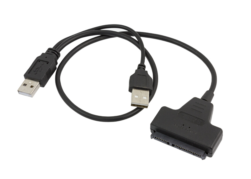

    There is a cable in the attachment.
    The question is, will I connect a 3.5 inch SATA 2/3 drive to this cable?
    Theoretically, having an additional power supply on the hub, it should go on.
    But does this plug fit, the wide one? Seemingly it's one and the same
    however, I prefer to ask.

    I have been using this cable for a long time and I can always connect a spare USB drive. Of course, this wide plug has to fit into the slots on the drive.

    Of course, if it's for a 3.5 inch drive then it must match.

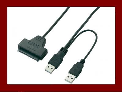

    ADAPTER CABLE USB HDD 7 + 15 pin 2.5 "SATA - will the 3.5 drive be fine?
    17 Aug 2016 00:05
    - this is the question with which I start the thread.

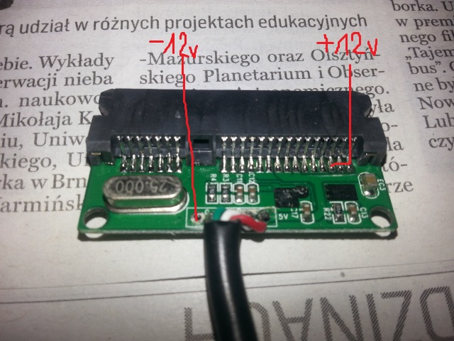

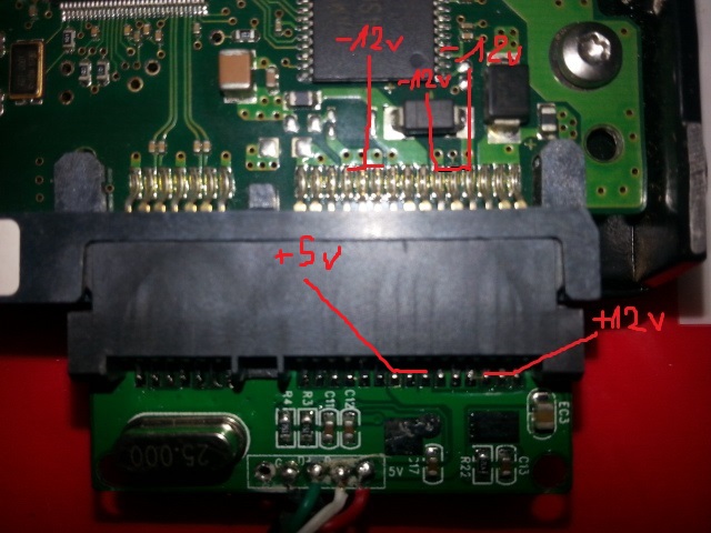

    I wanted to advise you if I was doing well. I want to connect a 3.5 "disk to this sata / usb adapter and give the missing molex voltage from the computer power supply as in the photo, but I am afraid if I am doing it correctly and I will not burn the usb in the laptop.
    • Compatibility of 3.5 Inch SATA 2/3 Drive with USB Adapter Cable and Additional Power Supply 20180117_175239.jpg (129.16 KB) You must be logged in to download this attachment.
    • Compatibility of 3.5 Inch SATA 2/3 Drive with USB Adapter Cable and Additional Power Supply 1.jpg (62.6 KB) You must be logged in to download this attachment.

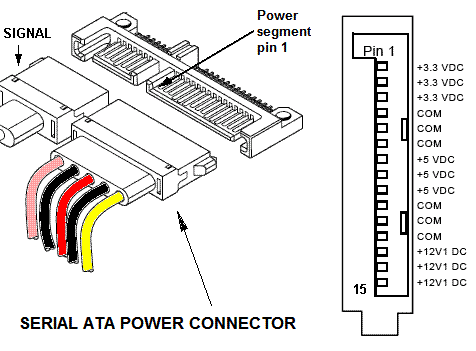

    +12 only on the three right pins, the next one is on GND and delayed start support

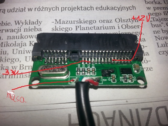

    Thank you for your help, is this connection enough without + 3.3v
    • Compatibility of 3.5 Inch SATA 2/3 Drive with USB Adapter Cable and Additional Power Supply 20180117_175239.jpg (126.79 KB) You must be logged in to download this attachment.
  • #12 16970631
    Freddy
    Posts: 19997
    Help: 1394
    Rate: 2821
    Of course it's enough. 3.3V voltage is not used in 3.5 "drives

    It works for sure, I have been using this connection for over a year and it only uses 12V to power a 3.5 "SATA drive.

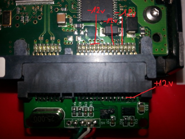

    Something wrong, I connected in turn -12v as in the photo and the disk does not move, can these three masses together give?
    • Compatibility of 3.5 Inch SATA 2/3 Drive with USB Adapter Cable and Additional Power Supply 20180118_134755.jpg (109.48 KB) You must be logged in to download this attachment.

    You are to connect the ground (GND) and + 12V
  • #17 16970734
    dell44
    Posts: 338
    Help: 13
    Rate: 30
    Where to give this mass GND best and whether + 5v from usb must be started because I do not risk it yet :D

    For me, the drive starts with + 5V, and I do not connect to the USB in my laptop because I have the + 5V from the molex of the computer power supply, so I do not know if the USB in my laptop will not burn?
    Added after 17 [hours] 45 [minutes]:
    I gave all the voltage more or less like in the photo from the computer's power supply, the drive is detected by the phone, but can I connect to the laptop where + 5v also comes out. will not burn the laptop usb?
    • Compatibility of 3.5 Inch SATA 2/3 Drive with USB Adapter Cable and Additional Power Supply 20180118_134755_1462951.jpg (110.51 KB) You must be logged in to download this attachment.
