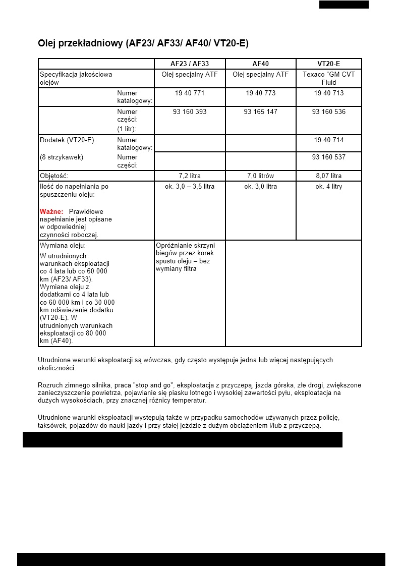

    Hello, I have a question. I have an Opel signum 2.2 dti with automatic transmission. The car is from 2003. I would like to know what the situation with the oil change in the box looks like. The car has 250,000 mileage. I am asking for some advice and information. Regards PŻ

    We replace every, about 60,000 km.
    • Opel.rar (582.44 KB) You must be logged in to download this attachment.

    The AF33 box (five-speed) was installed in your car. JWS ATF oil (the manufacturer does not matter), you will not change the oil filter built into the gearbox.

    It is replaced every 60,000km. Each oil changes its color under the influence of work, usually it darkens, which is a natural thing (your mechanic should know this. It seems to me that he does not know how to go about it and may outsource it to someone else)
