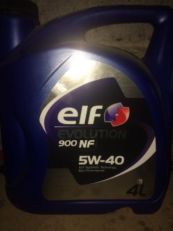

    I'm just like in the picture. Recommended for this engine is 5w30 or 5w40. Remember only in exchange every 15 thousand. Opel Vivaro 1.9dti 2002 - Which engine oil with a mileage of 400,000 km

  • #14 17404295
    cezariuszx
    I have a service book for Vivaro 1.9 year 2004 recommend elf 5w40 oil
