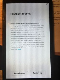

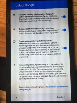

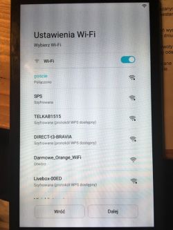

    the client brought what was in the title.

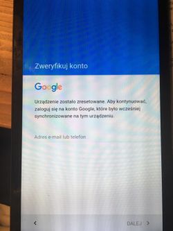

    Device reset to factory settings.
    FRP lock
    I was able to find out the gmail address using her support email.

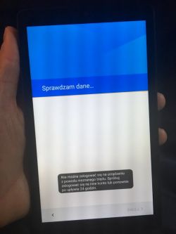

    After trying to login to this address, the device throws an error that something went wrong and to try in 24 hours and so over and over again. I waited 24 hours as if someone was asking.
    I did the factory reset again
    I tried to play softboot in HiSuit via fastboot - it throws an error that this device cannot be played.
    Soffta can't find anywhere. Only some Russian and paid, and after that I do not know if it will move from the SD card.
    I've watched everything on YT for this model does not fit anything.
    Any ideas ?
    Just take this FRP dziadowskie and this tablet will probably go.
    The tablet has no GSM modem, only wifi

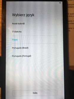

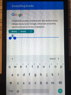

    I wonder how you can't reach the browser in any way. See photos.
  • #4 16984143
    barton21
    Level 26  
    Posts: 688
    Help: 79
    Rate: 192
    Penultimate photo. Clicking on the place where you have to enter the telephone number or account name. The keyboard is displayed. You click the keyboard settings. The settings are displayed. You will check any line of the displayed text and hold it down. It displays the meme in which you have cut-paste-copy-share-search. You click search. You start a googke search. You enter the name of the browser installed on your tablet. The browser icon appears, you click and have it.

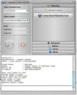

    Thanks for the desire but unfortunately not expensive buddy, this is new software without such holes ... or something fresh maybe via proxy? or maybe the new soft somehow I don't know. I found something like DC UNLOCK, but first of all it is paid and secondly it can only remove "factory reset protection .." which just works because I was doing factory reset, I do not know if there was only something about encryption, but it went and went has reset.

    And what is this equipment buddy? I have z3x but nothing else.

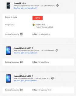

    As you enter the device, there is no remove button, or I can't find it. I read somewhere that the only option is to delete the account on the device

    Furious, Sigma, Chimera, DC.
    Look for equipment typically used to support Huawei.

    As soon as you enter the device, there is no remove button
    You have to do it through your browser by logging into the account to which this device was assigned.

    None of these things my friend: =. The customer still has a phone and it can be removed, while the tablet cannot.
    After I called the authorized service, the Lord said: yes, the device will not log in to the changed password, because it is associated with that old one and without the Internet ---- I'm entering the word - - sir, there is the Internet. Googole swallows the password only crashes error in which it informs that you will be able to log in to the new password in 24 hours. Unfortunately it can't.
    For the service, FRP photos want PLN 70 (insolently) - - - as it is obviously some BUG :) hehe.
    Maybe gentlemen, some ways? e.g. through a proxy? or with disconnecting the Internet, or maybe you know how to enter this Chinese hard rest because there is some emui here and there is no wipe-a - (I managed to enter Chinese once).
    Huawei BG2-W09: FRP Lock Bypass Issues, Factory Reset, HiSuit Fastboot Error & Gmail Login
    It occurred to me to try to pat the old password, but this can only be done after a hardreset, which I can't do, and when connecting to google disconnect NET and try on the old password.
