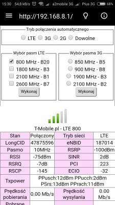

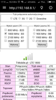

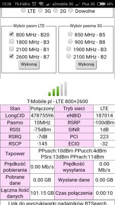

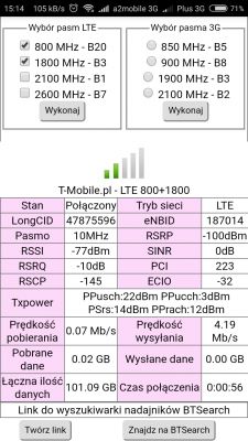

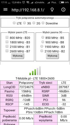

    Hello, I'll start with the fact that I'm new here and if I wrote in the wrong section, please correct it.
    Well, I took the above-mentioned internet for tests with the option of up to 20 mb / s (in the living room they told me that 60mbs does not make sense because the transmitters are overloaded in my location, but you can always change) the B525s router. At night I was getting over 20mb / s DL, but the Up is low because max 6mb / s.
    I forced all LTE bands and the best was 1800 + 800mhz, 800mhz and 800 + 2600, below I will add photos from tests and the app.
    1800 + 800
    T-Mobile Home Internet: Best Antenna for B525s Router, LTE Bands 1800+800mhz, 800mhz, 800+2600mhz
    800
    800 + 2600
    And my question is, why is it connected to the transmitter from Żeromski in the middle of the city through which I have 2.85 km in a straight line, and not to another which is closer (there are probably 4 of them)?
    My location is: Radom, ul. Skaryszewska 80-90 (does not give the exact house number for private reasons)

    Force the LTE1800 and the LTE2600 itself. These three measurements showed association with or aggregation with LTE800 as baseband. Signal at home is weak. Do the tests outside the window, also with the LTE800 itself.

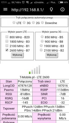

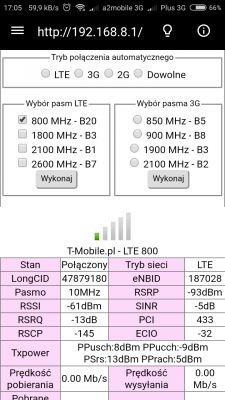

    I have already done tests on the window:
    1800:
    1800 + 2600:
    2600:
    800:

    LTE1800 and LTE1800 + 2600 from Słowacki 257, poorly clogged BTS. LTE800 from Wrocławska 3, also linden. The only chance, as you can see, is Żeromski. generally, it can be seen that in Radom, t-mobile has problems with speeds on LTE.

    The parameters of the signal from Żeromski are very weak, especially in the higher bands, and this is one of the LTE2600 from Słowacki 102 (eNB 187016). Antenna necessary.

    The question is, do you want to use LTE2600, LTE1800 or LTE800? Because the result on LTE800 from Żeromski was good. Although the 3 o'clock test is unreliable.

    The 1800 + 2600 band from the Slovak 257 is definitely winning, I tested outside the window and at 22 m and it came out 18downl and 20up (LTE 4 lines), so I will buy the 1800-2600 band. Do you recommend a specific model?
