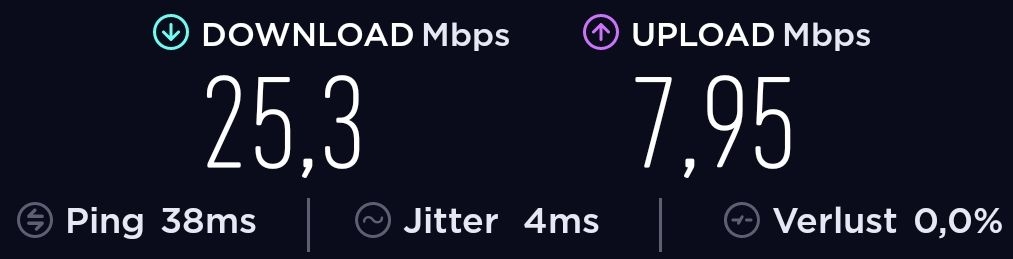

    hey,

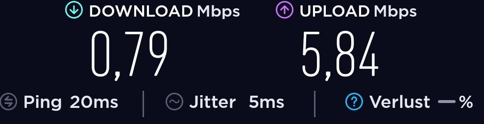

    the antennas arrived, but the wings ;) provisionally, having 1 antenna in my hand, I have these parameters
    Best Antenna for B525 Router: LTE 1800-2600 MHz Options, Recommendations & TipsScreenshot...121344.jpg (489.92 kB)You must be logged in to download this attachment.
    this SINR jumps me ray 4db once 40dB, but maybe I have a restless hand. I headed for Wrocław, but it still connects to Starogostyńska.
    Can I mount it like that?
  • #11 17382070
    matek451
    Posts: 31278
    Help: 4356
    Rate: 5816
    The SINR varies depending on the load on the BTS. Fix the antennas permanently on the mast, set to Starogostyńska Street and check all bands in turn and aggregation. Also try with this BTS on Wrocławska. And also share the results with your colleagues without cables.

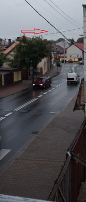

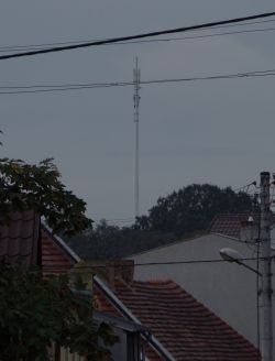

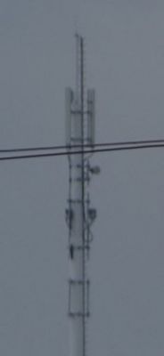

    By the way, I noticed a new mast; (I can see it directly from the balcony without any obstacles. It was supposed to be lifted 2 weeks ago and still closed. Looking at BTSearch it is PLAY ID: GOS3004, Leszczyńska 1. Who, what some info? I will have to translate these antennas to the other side ;)

    I called PLAY, the mast on the Leszno street is not working 100% yet. GSM and UMTS at the moment, LTE is to be launched next year.

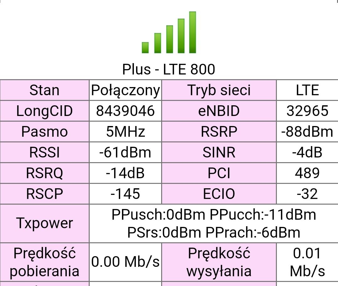

    Oto parametry Plusa:

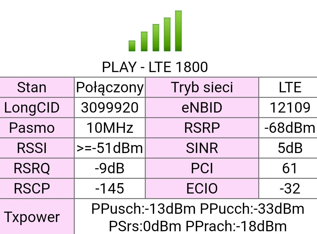

    A to Play:
