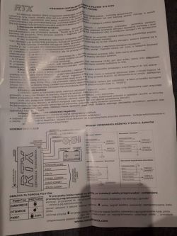

    There is a problem with the central locking assembly. I bought a car with only the central key in it. I bought a controller with remote controls and now ask where they are / plug in the control cables because according to what I received from the seller it is in a bundle with the door and the rest on various forums advise in the comfort module under the passenger shelf somewhere ...... (only different are given pins) or a shortcut button from the center of the cab is to be connected to the switch for closing the door in the middle of the cab (this button BMW E46 2000 central assembly - bmw e46 central locking assembly BMW E46 2000 central assembly - bmw e46 central locking assembly together with the emergency lights - I will add that there are 5 cables).

    Connect the controller to the door harness as you have provided.
    In the module behind the pin 54 compartment open 36 close.

    it's about the bundle that goes out of the door in this 5:35 rubber hose
    link
    Added after 8 [minutes]:
    who knows under this button BMW E46 2000 central assembly - bmw e46 central locking assembly
    5 pins are attached to it, only in which what? I am aware that then the turn signals will not flash but it is only about closing / opening the door without signaling

  • #8 17033714
    SKRZYNIA
    Posts: 761
    Help: 70
    Rate: 198
    Just as given by the seller, i.e. plug in the beam coming out of the driver's door - checked many times in this model by me
    since the door .... will it be a valid connection as it says?

  • #12 19813115
    SKRZYNIA
    Posts: 761
    Help: 70
    Rate: 198
    Control 2x mass from the driver's door, you have a good diagram, I always do this model and it works !!
