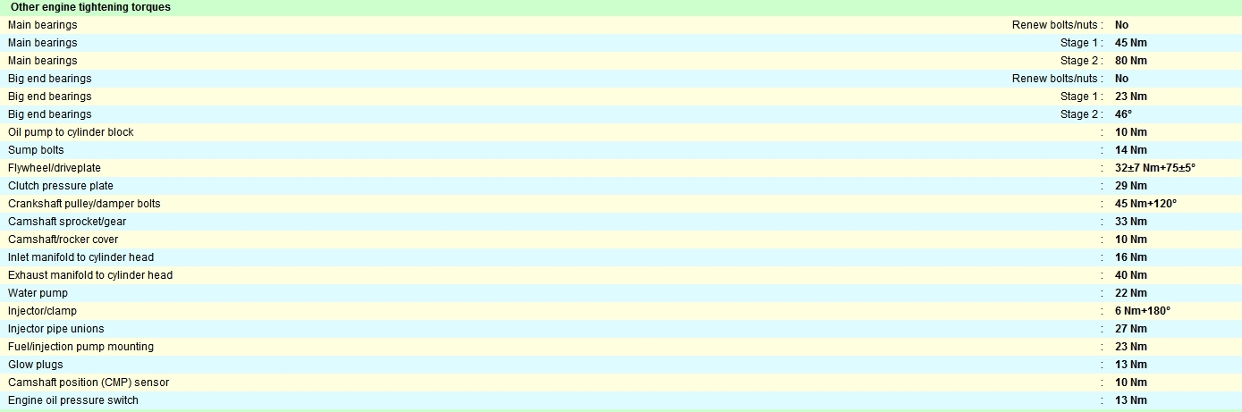

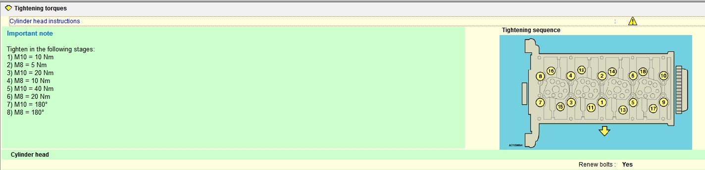

    Hello, I need the tightening torques of the bolts technical data mainly engine crankshaft head etc.
    #2 16992870
    DriverMSG
    You will find the necessary data in the tables below:
    Citroen Jumper 2.2 2007: Engine Crankshaft, Head Bolt Tightening Torques & Technical Data Citroen Jumper 2.2 2007: Engine Crankshaft, Head Bolt Tightening Torques & Technical Data
