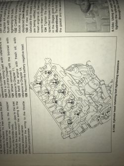

    I searched the whole forum but I did not find the time to tighten the head, valve cover, water pump, thermostat housing, collectors.
    Unfortunately, they don't like anything in the service, so I know that together with the head gasket there should be a card. Tomorrow I collect all the parts and I would like to assemble it well.
    Renault Megane kombi 1999 1.6 16v k4m 700. Thanks for the answers and the hints.

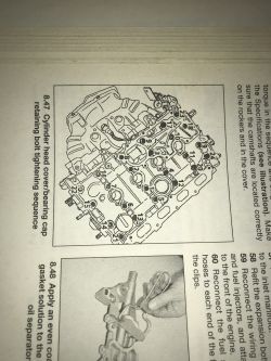

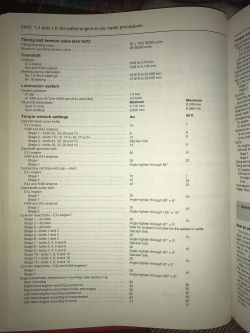

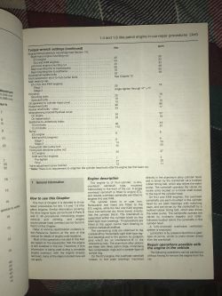

    I have a Haynes service at home, but I won't be until tonight, then I will throw a scan of the appropriate page from this book.
    As far as I remember, there the head tightens with a moment + 1/3 of the turn of the screw, but I will definitely give it for the evening.
    Added after 2 [hours] 18 [minutes]:
    Renault Megane I 1.6 16v - Tightening torque of valve cover, water pumps and oth Renault Megane I 1.6 16v - Tightening torque of valve cover, water pumps and oth Renault Megane I 1.6 16v - Tightening torque of valve cover, water pumps and oth Renault Megane I 1.6 16v - Tightening torque of valve cover, water pumps and oth
    Please, here are the promised scans. If a colleague had problems with English terminology, I am explaining, but I think Google will settle the matter faster.

    Thanks so much for your reply, that's what I meant.

    Everything fired up ok
