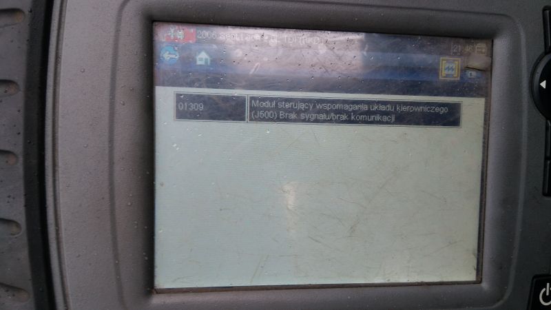

    Hello, I have a Seat Leon 2 from 2006. 2.0 tdi I have a problem with assistance I just got a red steering wheel error and I don't have any assistance. At the moment I checked the fuses and plugs entering the electric power assist motor on the ironer and in one plug there is electricity and in the other there is no. Must there be electricity in both? Is this another reason for the lack of support? Please help

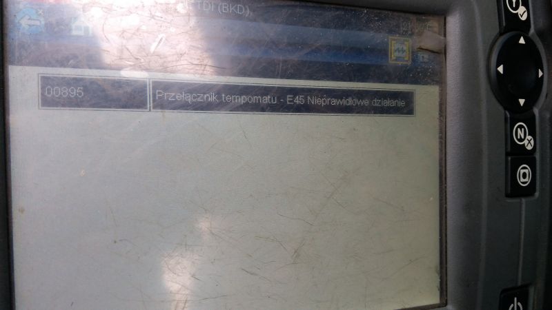

    Hello, I was check for errors there are two: power steering control module (j500) no signal / no communication. And the second is probably not very important but I will write: cruise control switch- E45 malfunction. That's it and I am asking for help, maybe you know something.

    Where are these errors in which modules? Is support going to connect?
  • #10 16997157
    Pawel wawa
    Posts: 16093
    Help: 1262
    Rate: 4423
    So only ;) three possibilities, communication harness, no power supply or controller enabled. Oscilloscope and indicator your friend :)

    No assisted connection. You can't connect. I checked the fuses and they are all ok. I don't know in which modules. Is there any module on the steering wheel from this?
    Added after 4 [minutes]:
    What driver might be broken? And the bunch which? What goes from the steering wheel?

    Replacing the electric power assist motor helped. Topic is closed
