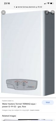

Termet Termaq electronic GE 19-02. It doesn't always fire. Video
John.D.Rush 14709 13
Why does my Termet Termaq Electronic GE 19-02 sometimes fail to ignite when hot water is turned on?
The most likely cause is a misadjusted ignition electrode: bend its tip slightly toward the burner and set the correct gap by loosening the two screws, then retightening them [#17157672] If the heater is still under warranty, do not вмешиваться in the device yourself; have service inspect it and, if needed, replace the servo valve with the remote control [#16997795][#16998758] Because the fault is intermittent, it may also be a controller issue or a gas unit hanging up, so it helps to record the failed ignition attempts for the technician [#16998406][#16997795]
  • #1 16994712
    John.D.Rush
    The stove burns as he pleases. Once it lights from the first shot, and once it doesn't want to smoke at all. Just turn off the water and unscrew it again. like in the movie:
    youtu.be/B6Hws1-LJF4
    There is no spark in the film because of the camera shutter, but it appears with every "shot". Recorded 4 fires:
    The first and last is ok. The second one is delayed. The third one not fired at all. Batteries changed.
    Do you have any idea what could be the reason?

    The solution to the problem is to bend the tip of the ignition electrode slightly (not to crush the ceramics) towards the burner + ewe. adjusting its distance from the above (by loosening 2 screws, setting the distance and tightening the screws). At least it helped me.

    Did you manage to fix the problem? Seems like I have a similar issue. Once the boiler lights up and there is hot water and then again it tries to light up and nothing happens 😌 I live in Estonia and do not know where the previous apartment owner got this gas heater. Also there seems to be no technicians knowing anything about this gas heater therefore I feel a bit hopeless Termet Termaq electronic GE 19-02. It doesn't always fire. Video

    Take a picture of the fittings inside.

    I have the same radiator as in the picture. I have the manual for it, as in the attachment - it may be useful.
    • Terma Q typ G-19-02 Instrukcja-serwisowa-wersja-vulcano.pdf (2.68 MB) You must be logged in to download this attachment.
