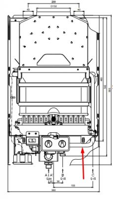

    Hello!
    I am the owner of the TERMET G19-02 Electronic gas water heater.
    Some time ago, there were problems with the main burner lighting. The ignition pilot works, of course, it is cleaned. Replacing the battery did not solve the problem.
    To start this stove, you need to turn off the warm water and lightly tap (set in vibrations) the tube that reaches the stove.
    I measured the coil voltages.
    Coil (orange) - 1.1V
    Coil (green) - if it does not fire, 0.01V, after switching off the stove and tapping 1.1V.
    Here I found the service manual http://www.tukado.pl/file/electronic-aquapower.pdf
    Will it be the fault of the coil or is the problem deeper because it does not get voltage?

    What tube are you writing about?
    Check that the detection electrode is clean, including the entire cable to the controller.
    If the electrode does not confirm the presence of a flame on the remote control, the controller will not allow you to turn on the main burner.

    I apologize for the late reply, but I was still waiting for the battery to be replaced because it was getting worse.
    I meant a tube that brings water to the junkers. It is next to the spark generator. TERMET G19-02 Gas Water Heater: Main Burner Ignition Issues, Coil Voltages & Troubleshooting
    The metering electrode has been cleaned.

    The coil is not guilty of not getting voltage. Because if it doesn't get voltage, it won't open the valve.
    Check for loose cable or temperature sensors.
    one is attached to the heater (heat exchanger) and the other is the chimney draft sensor or rather its lack.
    If you have a meter, check if one of these sensors is not open when the stove does not want to ignite the main burner.
