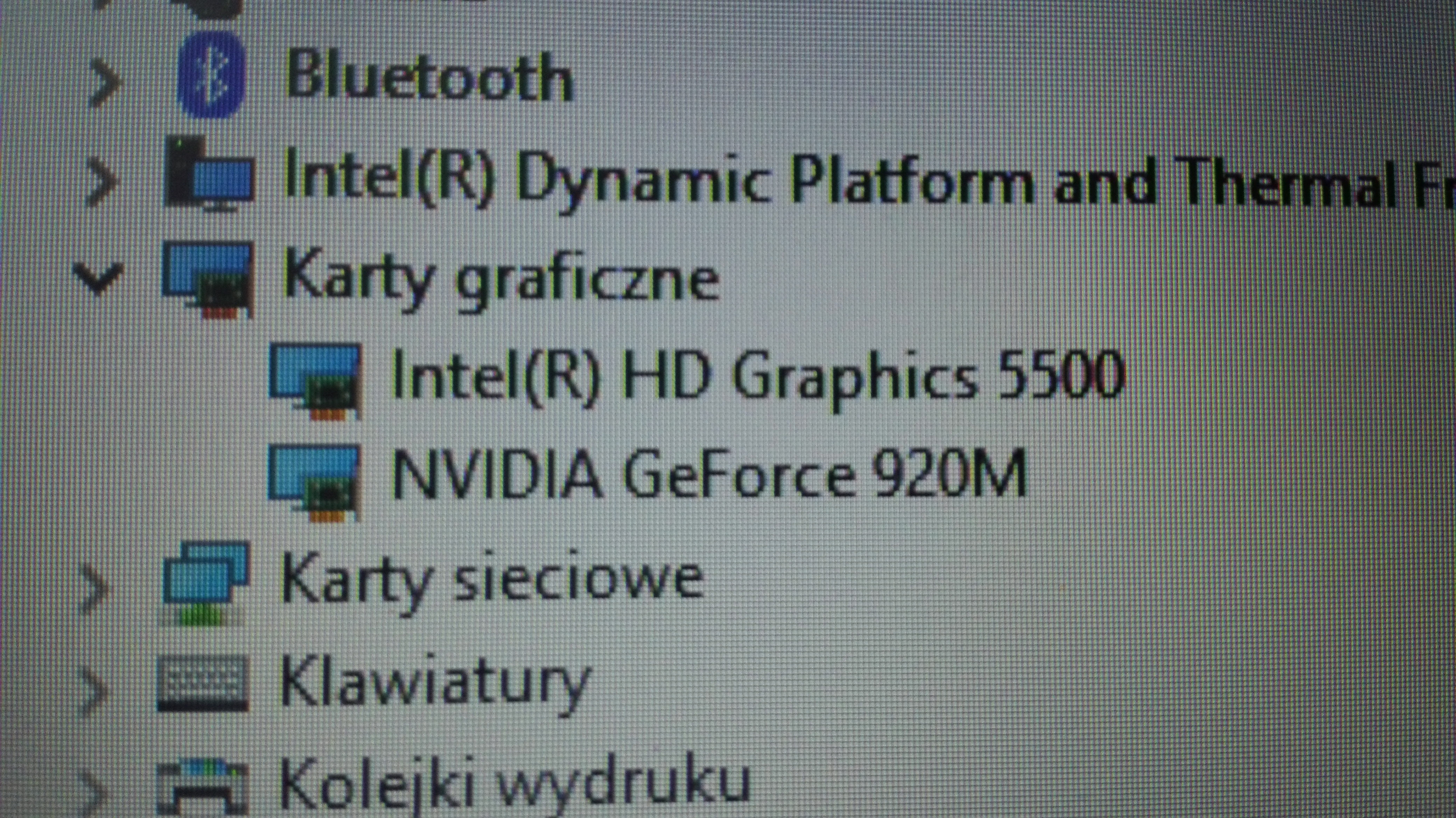

    Hello, I have a laptop with two graphics cards, I'm a bit green in this topic and maybe this will be a silly question, but can these two cards be a problem of low FPS in games? The i5 processor, 4GB of RAM, e.g. Fortnite in full screen, cuts down terribly, you can't even play. Does turning off one of them make any sense? Or not enough RAM?

    The question that 3D graphics uses when playing because it is supposed not Intel.

    The laptops have two integrated graphics cards integrated Intel (low performance) and dedicated (strong playing card). Laptop, ie. Windows will automatically switch "Automatically" to the appropriate card, but not always. In Bios, you have the option to enable called "Enable Optimus" - this option enables / disables Nvidia Optimus technology (only WIN7 systems). In your laptop you can enable the appropriate card from the Control Panel - Screen.
    Integrated HD Graphisc 5500 (inefficient) - for displaying images e.g. on the desktop *)
    Geforce 920M - a more powerful card
    parameters:
    Memory Size: 2048 MB
    Memory Type: DDR3
    Memory Bus: 64 bit
    Bandwidth: 14.40 GB / s
    info. https://www.techpowerup.com/gpudb/2646/geforce-920m
