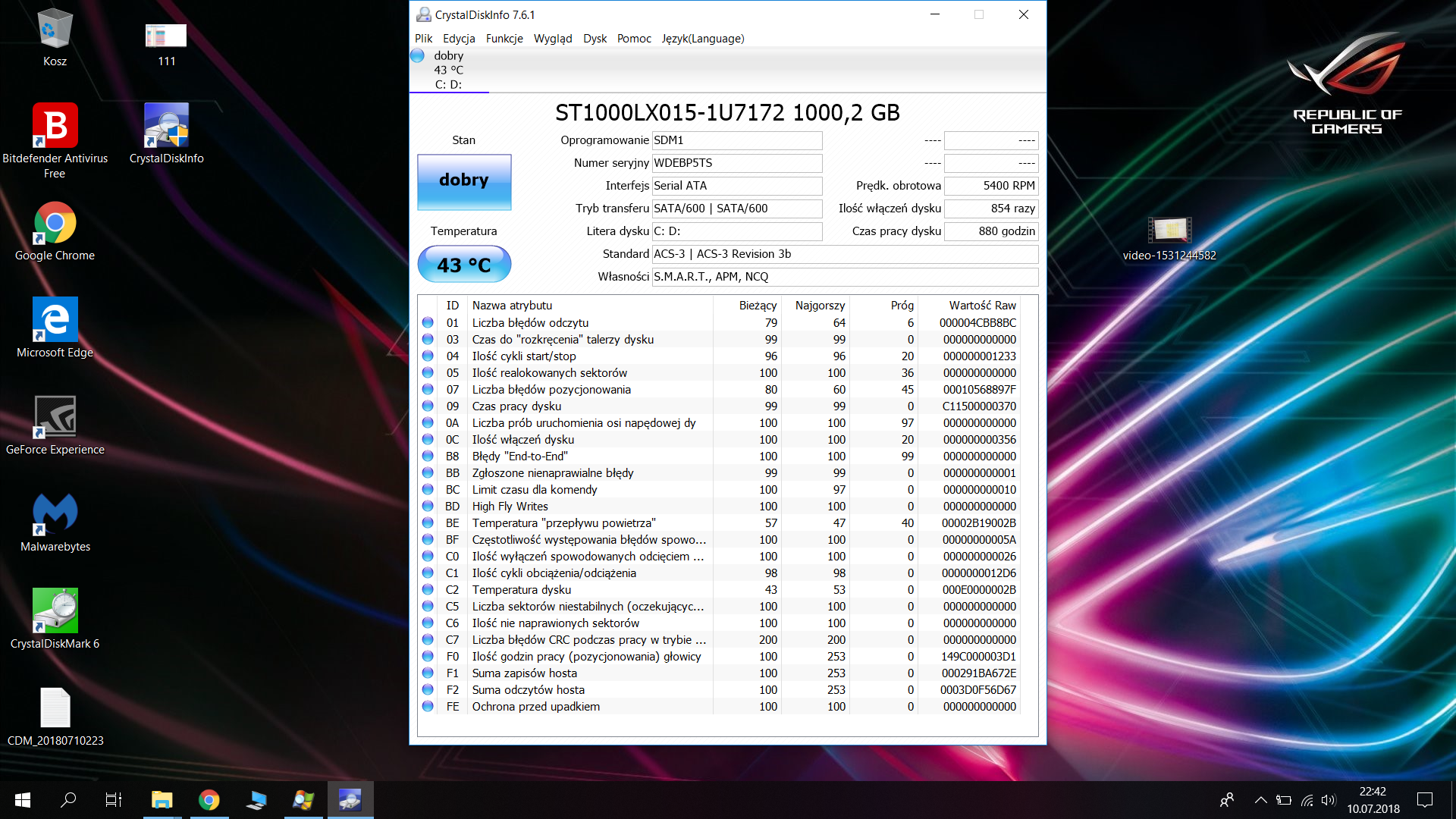

    Send from crystal disc INFO. Not with crystal disc MARK.
    Please provide a screenshot and do not omit ANY attributes and RAW values.
    And screenshots of process explorer xd.

    The attached file is worthless.
    Disk SMART is needed. It should look like this =>

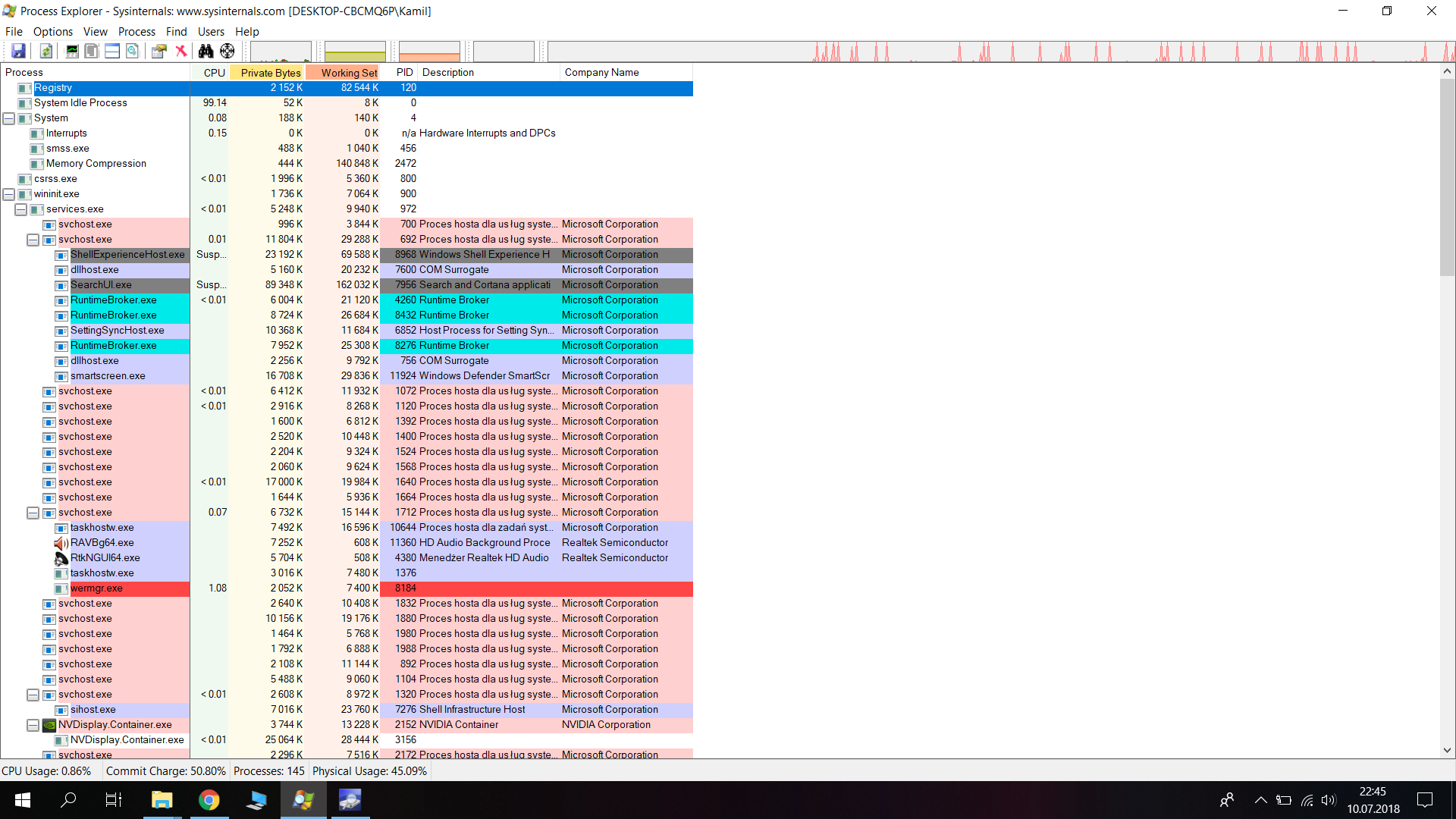

    And this process explorer, how should I show it? I see how sometimes one process is done in red and in green
    • Title: 100% GPU Usage Issue on ASUS ROG STRIX gl503 Laptop - Seeking Help & Solutions 1.png (1.66 MB) You must be logged in to download this attachment.
  • #9 17322410
    kamil090200
    Posts: 14
    here ss from process explorer. I really don't know if I did it right
    • Title: 100% GPU Usage Issue on ASUS ROG STRIX gl503 Laptop - Seeking Help & Solutions 2.png (248.03 KB) You must be logged in to download this attachment.

    The drive recorded a lot of "BF" hits/shocks (despite the fact that the equipment is practically new).
    It should be handled more gently.

    In CDI, change the display of RAW values in the options and you will see the amount.
    Features => Advanced Feature => RAW Value => change to 10[DEC]

    The RAW value is 90. Never mind, it was for reference only ;-)

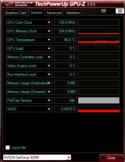

    Give screenshots from gpu-z sensors tab AND screenshots from hwinfo maybe something will be more visible.
    I wonder if reinstalling the Intel graphics driver would help.

    Reinstall the graphics driver because I have otherwise xd. The one from Geforce.

    here is the ss from the integration
    Added after 10 [minutes]:

    Sorry forgot to add you would give sensors only in HwInfo. Could you give screenshots?
    this?
    #25 17322543
    icooz
    Posts: 329
    Help: 14
    Rate: 43
    It's from the intel GPU, but I guess you should try reinstalling the Intel graphics driver because my expertise is not ...
