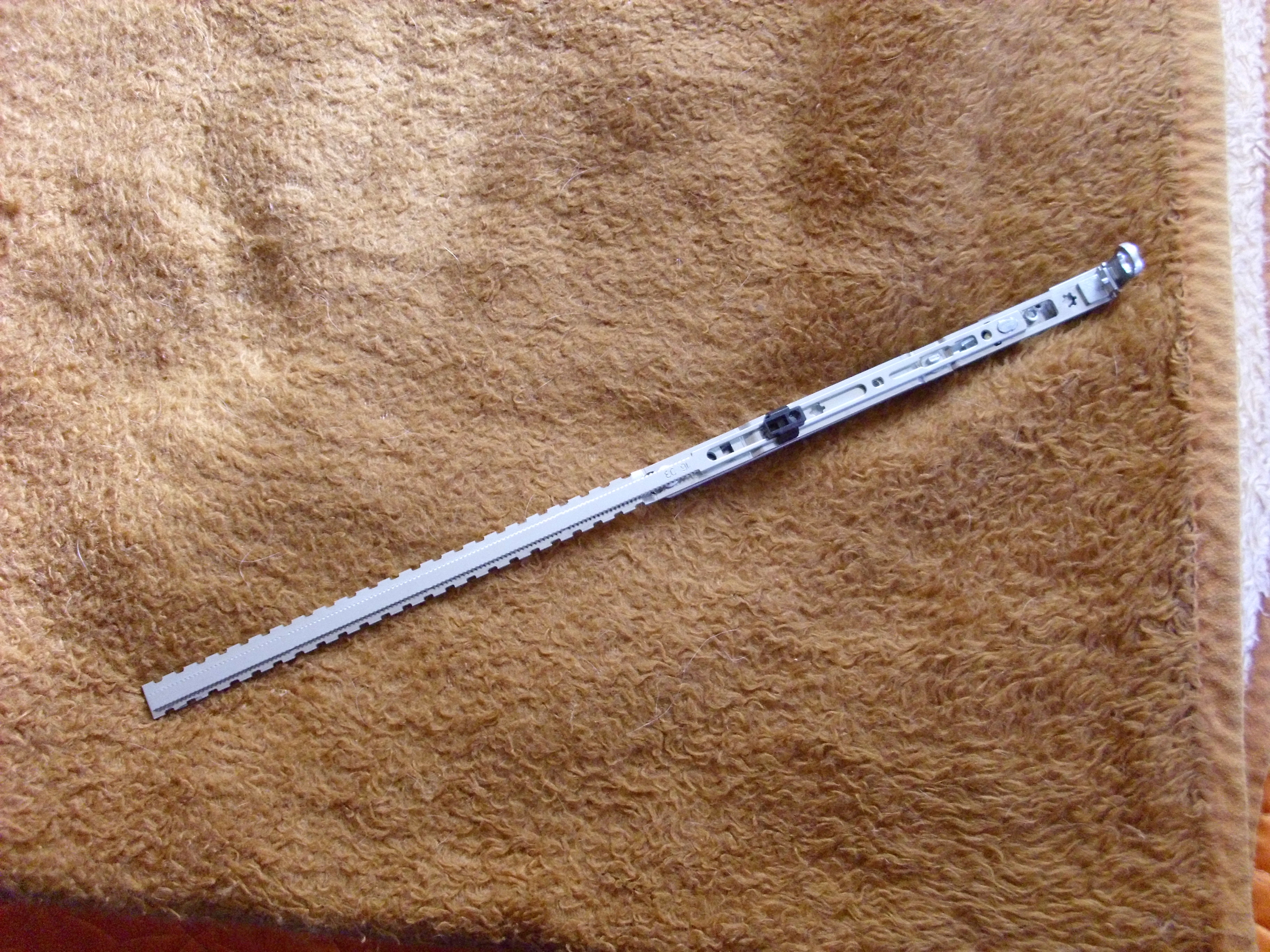

    Once upon a time there was a friend who was sitting on the subject and looked at this fault and told me to buy the part which is in the picture below. I bought this part but until today, due to the lack of access to some specialist, I have not mentioned it. Do you think the above mentioned fault is caused by a damaged part that can be seen in the pictures below?

    To begin with, raise the right wing on the bottom hinge - under the cover is the entrance to the key from above. During adjustment the sash should be tilted.

    DRUTEX Double Balcony Doors: Issues with Right Sash Opening and Tilting Simultaneously
    The mechanism will work well if the red catch 1 and the black catch 2 (bottom) are in the corresponding grooves 1 and 2 (top) it is the door (or window) position open (handle horizontal). If these catches are pulled out of the grooves, this is the "door ajar" position (handle in the up position). The movement of the handle moves these latches.

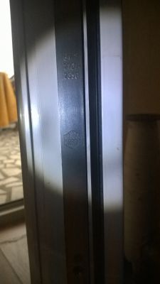

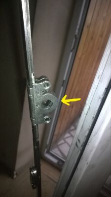

    Thanks for the advice but today I have a bigger problem with single balcony doors also from Drutex (without the tilting function). The point is that the handle does not bolt the door to the end, this mechanism into which the handle pin enters rotates around. 90% of these latches, cloves have formed in this mechanism. I unscrewed the entire espagnolette and you will probably need to look for a new one and now I have a few questions.
    1. Is the part where the door handle enters marked in the photo below the yellow arrow replaceable or do you need to buy the whole complete espagnolette?
    2. Where can you buy such a MACO espagnolette and is it profitable at all (new doors cost around PLN 500)
    DRUTEX Double Balcony Doors: Issues with Right Sash Opening and Tilting Simultaneously DRUTEX Double Balcony Doors: Issues with Right Sash Opening and Tilting Simultaneously

    Unfortunately, you can only contact the Drutex company giving the exact door type or have such fittings (this element). From another company this element may not fit alone, but you can replace the entire door fitting.

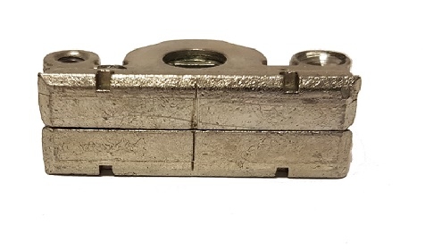

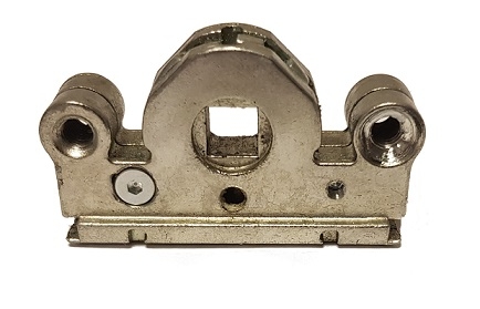

    One more thing, maybe someone knows if in the MACO espagnolette you can replace the cassette itself, because there are several offers on the Internet so-called repair cartridges such as in the pictures below. The repair cartridge is more than half cheaper than the entire espagnolette, but is it replaceable in the MACO system?

    If the cassette halves are applied from both sides and riveted, this is a simple matter. It is worse if it is pressed into the espagnolette, because it often happens. Here it looks like the first solution.
