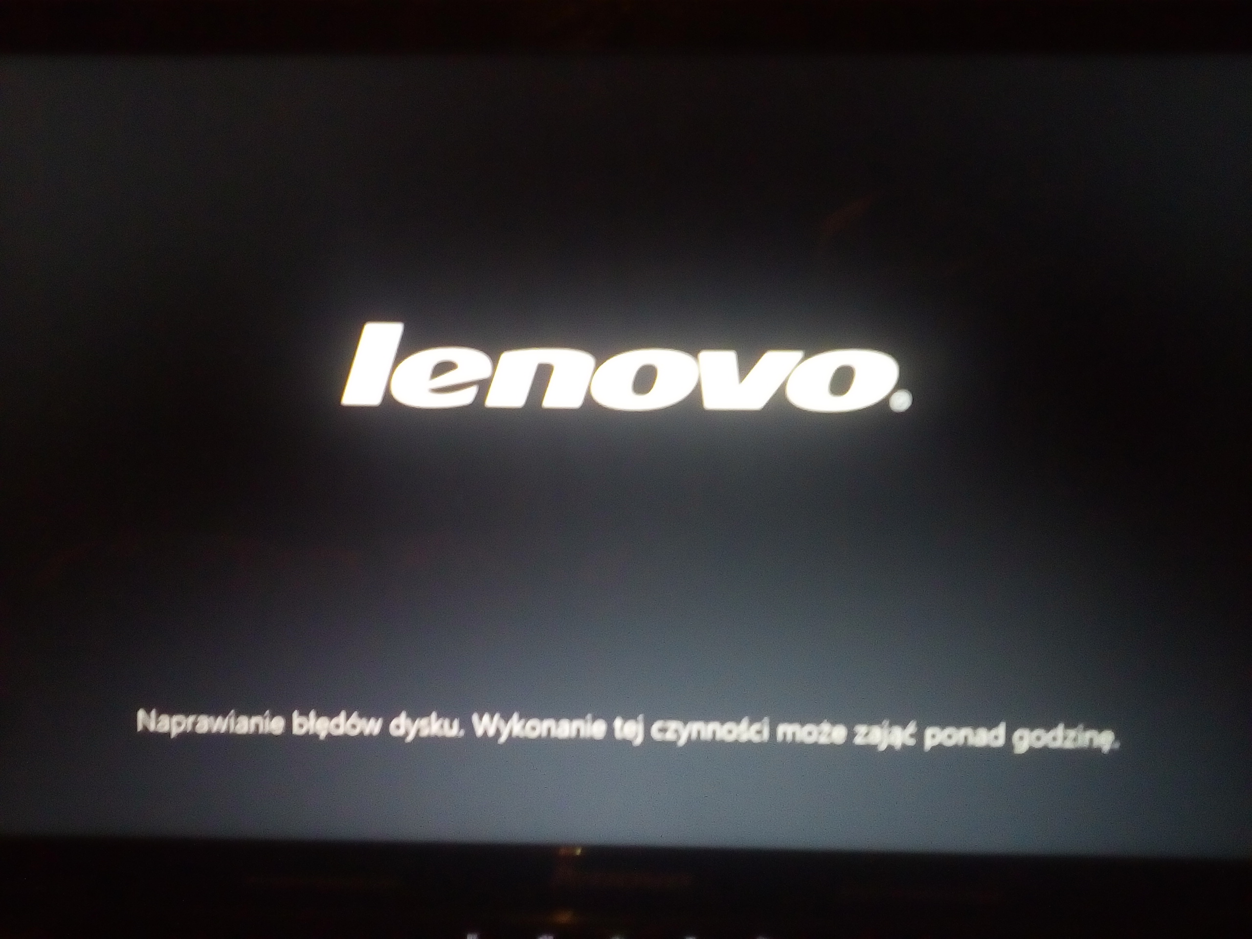

    After switching on the computer there was information about the preparation of the automatic repair, then it was diagnosing and now fixing the disk errors. It may take over an hour to complete this task.
    I've been waiting about an hour and a half and I'm thinking about fragmenting my computer or buying a new disk. What to do?
    Lenovo z580
    Intel core i5

    safbot1st
    Posts: 21951
    Help: 2719
    Rate: 1585
    nutorate wrote:
    I'm thinking about computer fragmentation
    Listen? I do not know what you mean, dismantling the parts?
    Let him finish, whatever "spoils" there. Provide what OS, because if 7-8 rather spoils, if 10, there is a chance.
    If you do not want to wait, by holding down the POWER button you should force it to turn off.
    After turning on, enter the BIOS and turn on the bootable MHDD with USB.
    Give SMART a drive with MHDD.
    You can also remove the disc after turning it off and connect it to a stationary PC.
    In this way, give SMART with CDI.

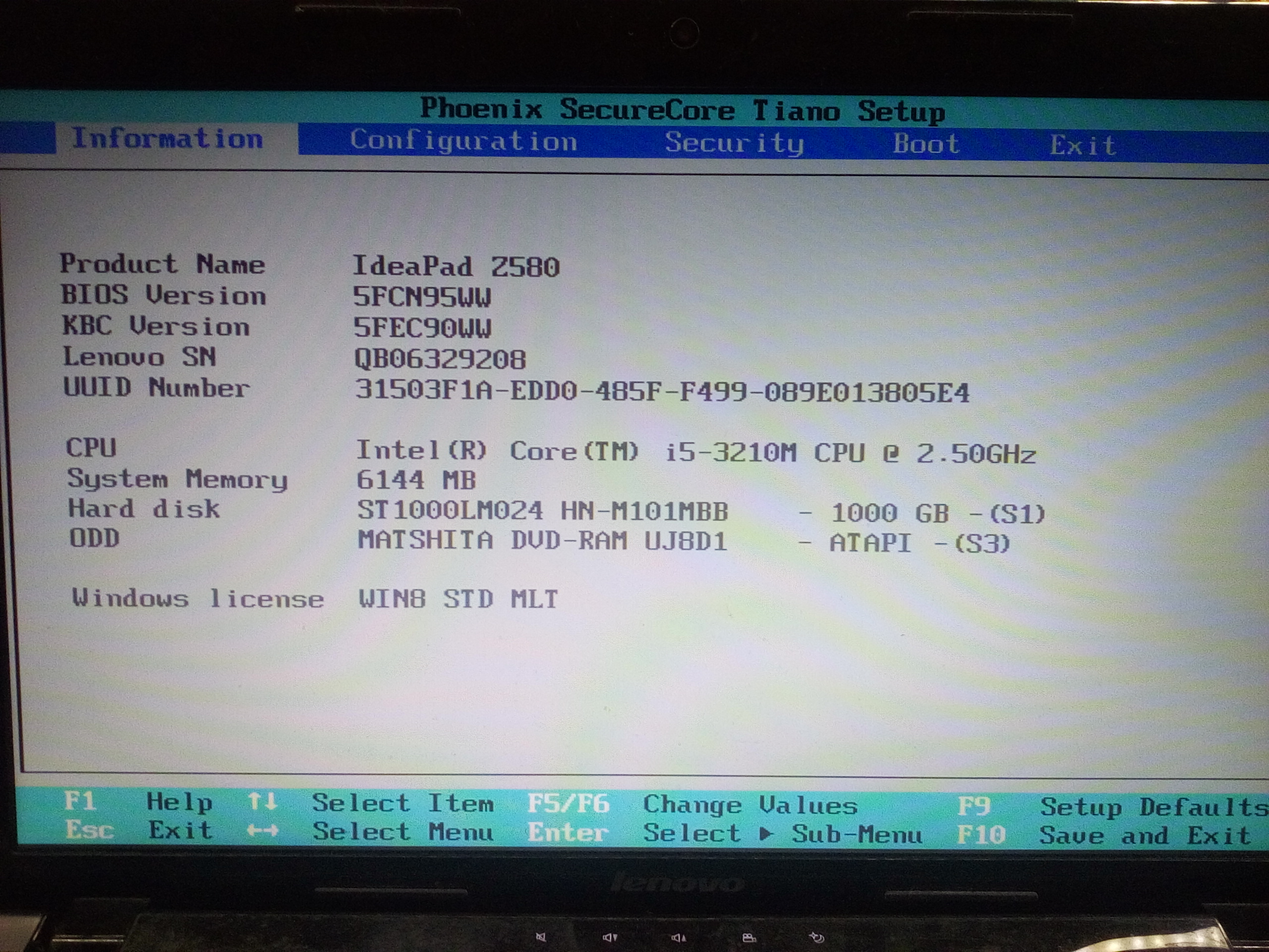

    nutorate
    Posts: 7
    How to enable bootable mhdd with USB and what's the point?

    nutorate
    Posts: 7
    Robert B wrote:
    nutorate wrote:
    what is this about?
    This is the screen with the BIOS information tab. Why are you showing this?
    I do not know what's going on with this mhdd and I showed it because I do not know where to do it

    Robert B
    Posts: 22594
    Help: 2027
    Rate: 1412
    Look up.

    #9 16604025
    michalek1988
    Level 26  
    Posts: 675
    Help: 68
    Rate: 181
    In the "Boot" tab, you choose the order in which the drives are started. there, in the first position, you set the DVD or USB drive on which you have the system in the Live version; then it is from it you run the computer and proceed to check the disk. If it does not tell you much, it will be cheaper and faster to report to the site. PS. With external media you can run any system, it does not have to be Win 8, which you used before.
