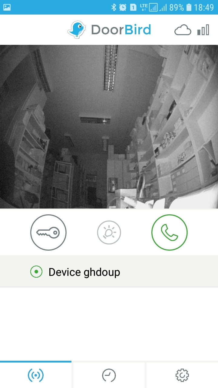

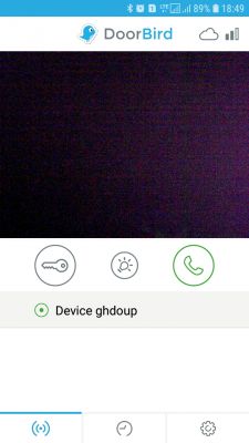

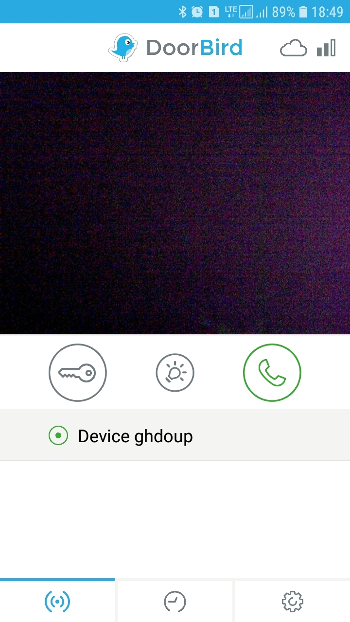

    The video intercom is not monitoring. It's not about catching the details of the yard at night, but showing the person standing in front of / near the camera as more than a fuzzy, blurry bright spot. So it will "bounce" ;)

    DoorBird. For now, there are only external panels (as the receiver they suggest a tablet on the wall), but they seem to work well with some Grandstreams / Yealinks - although we haven't tested it yet. Not the cheapest but worth every euro ;)

    Personally, I prefer, firstly, the usual analog wired solutions, secondly, if IP is also working in the local network. However, a small percentage of customers have any idea about setting up network connections, and more and more want everything on their mobile. The customer is our master, you should have ready options for everyone :) DB will start even a child in the basic scope.
    Screenshot without and with IR.
