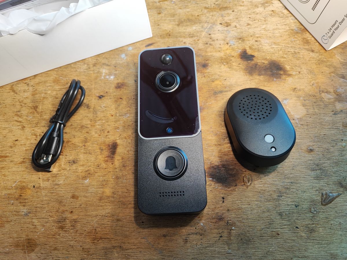

    Ok, here's the box I received:
    WiFi wireless video intercom - test, app and interior WiFi wireless video intercom - test, app and interior .
    The packaging says Aiwit application - where is Tuya?

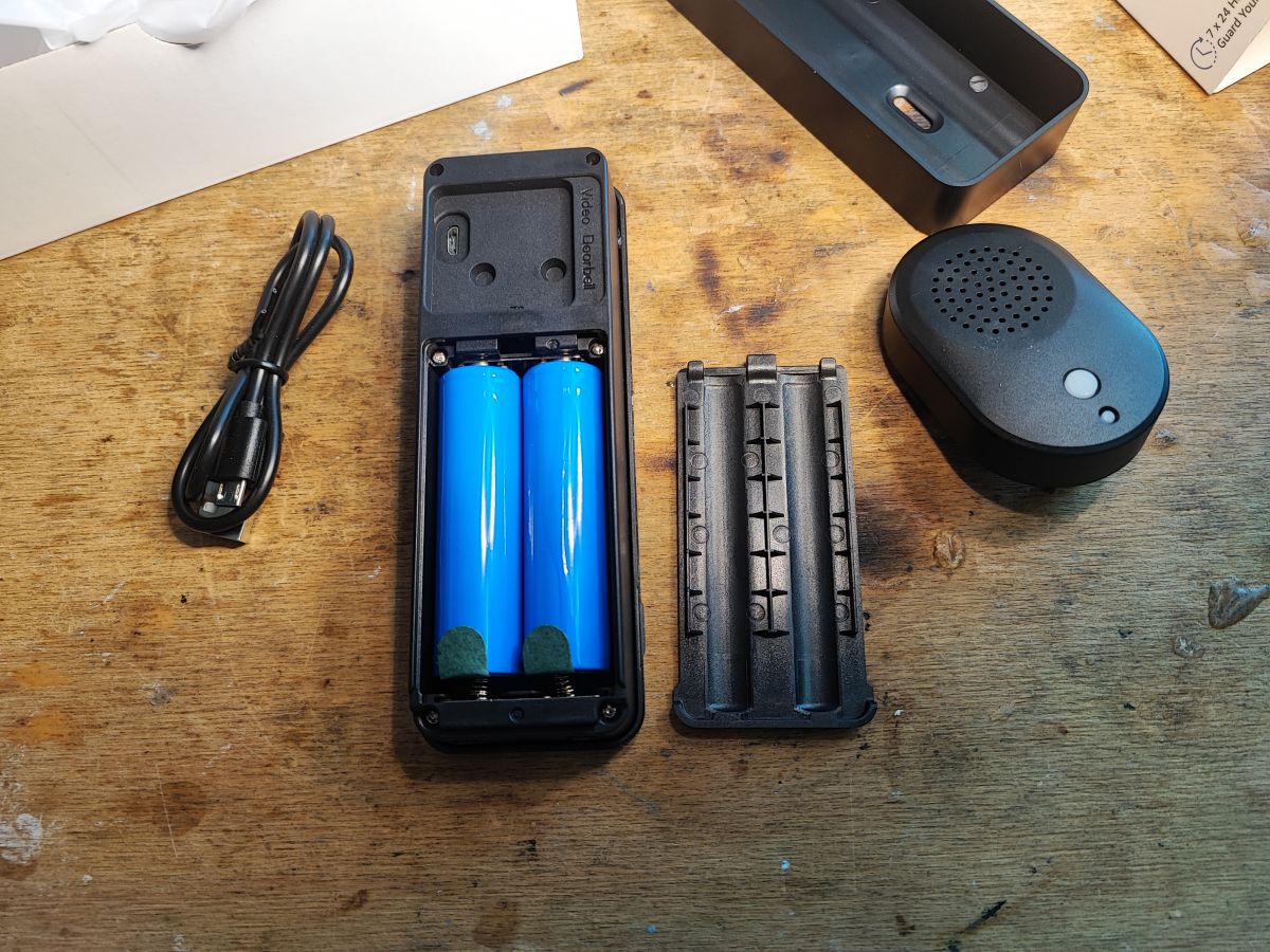

    That item with the USB connector is a bell, it should be in our house. Outside we give a battery-powered camera.
    We unpack it:

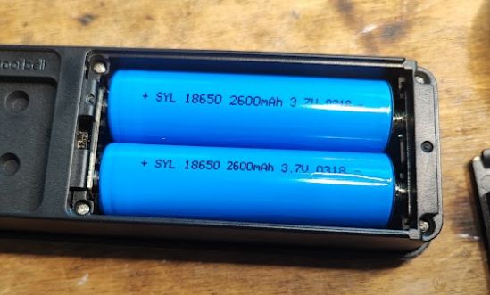

    The cells are already included. This is a plus. Properly protected of course, you have to remove the leaf for the cells to start powering the equipment.
    18650 2600mAh 3.7V. Actual capacity I have not checked.

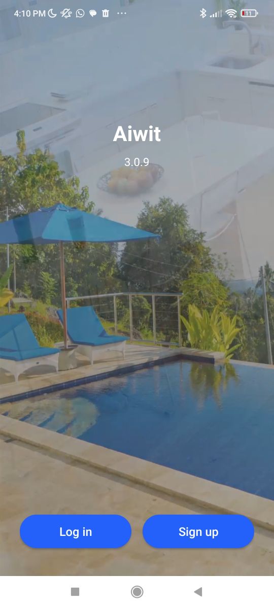

    Pairing with Aiwit .
    So, we install the Aiwit app (according to the QR code from the packaging):
    We receive:

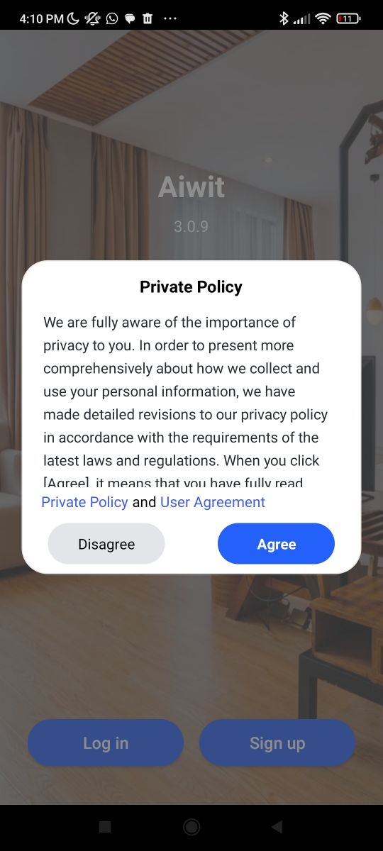

    we accept the privacy policy:
    We create an account, log in. Email is sufficient. Phone not provided.

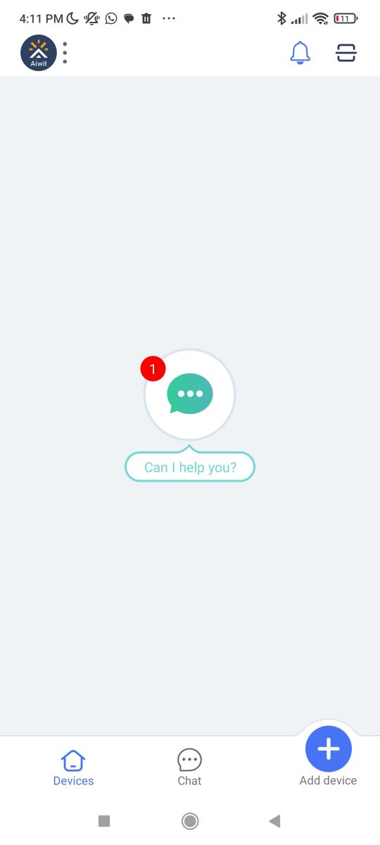

    We already have a panel:

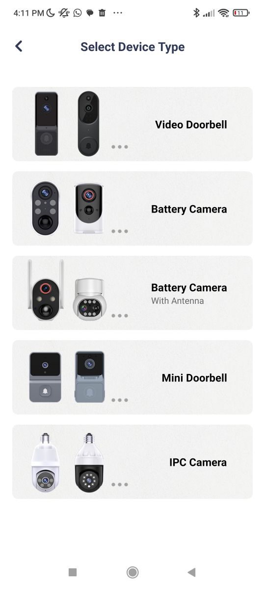

    We go into adding a camera, select the type of camera (from the package):

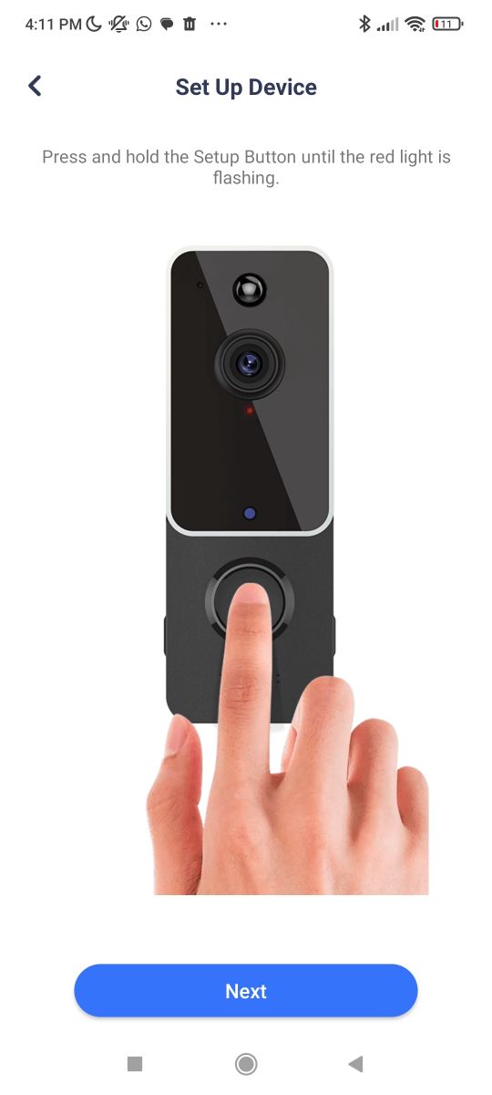

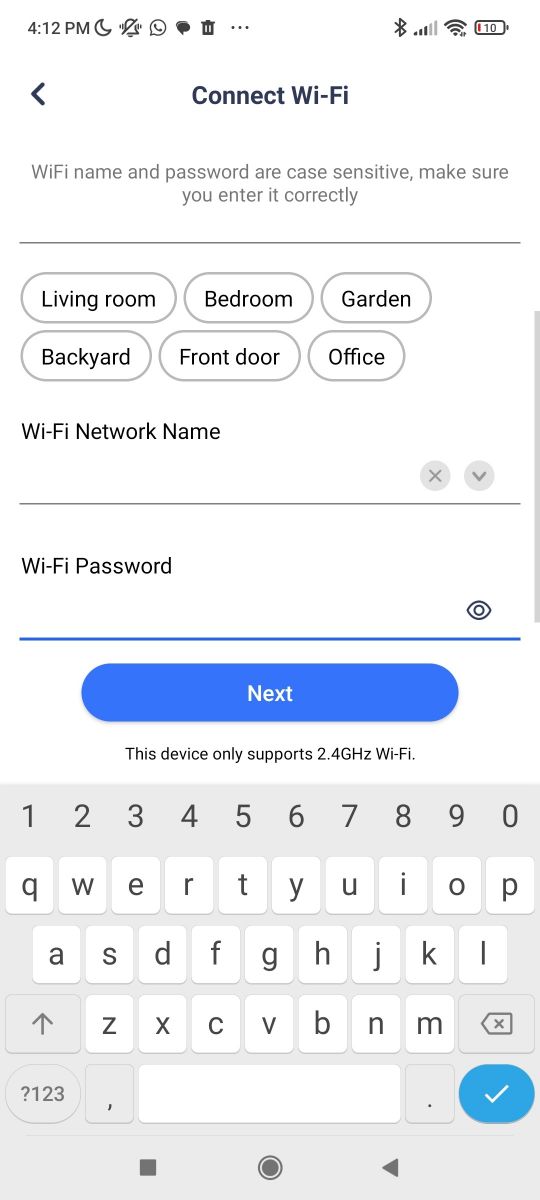

    We put the camera into RESET mode:
    The camera will then give a voice - we will hear "pairing mode" from the speaker.
    We then enter our WiFi network details and scan the QR code from the phone with the camera :
    Here the camera pairs immediately.

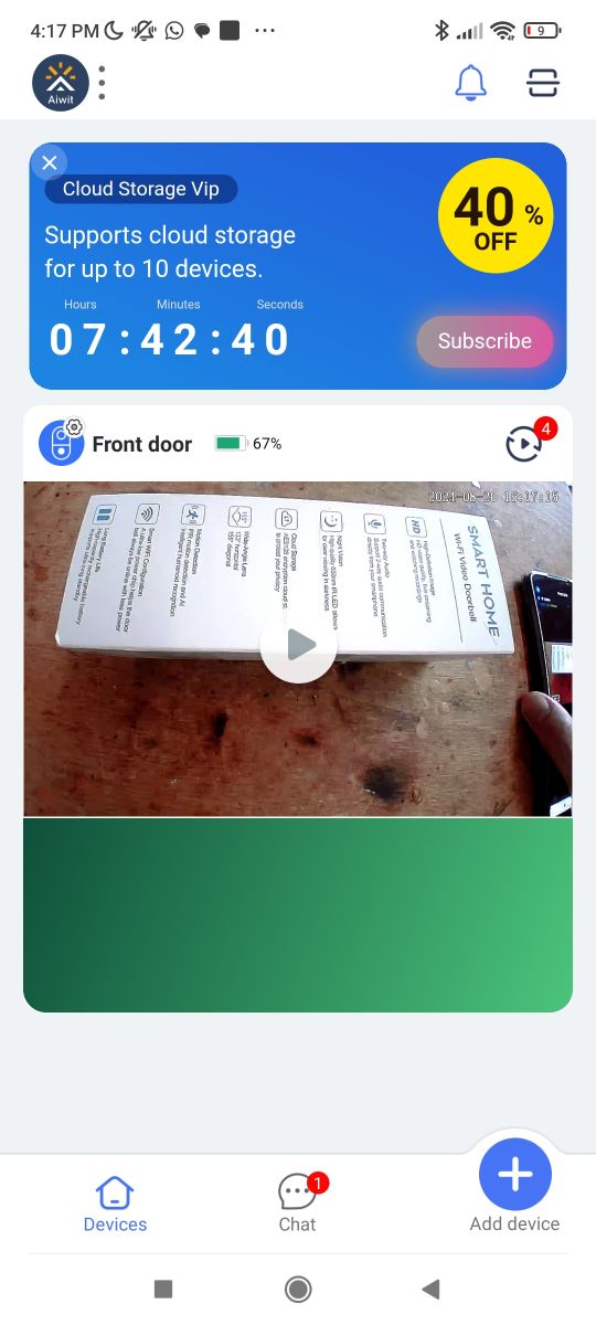

    Ready, paired, it's ok, although the app immediately prompts us for a paid subscription: .
    What do we have in the application? .

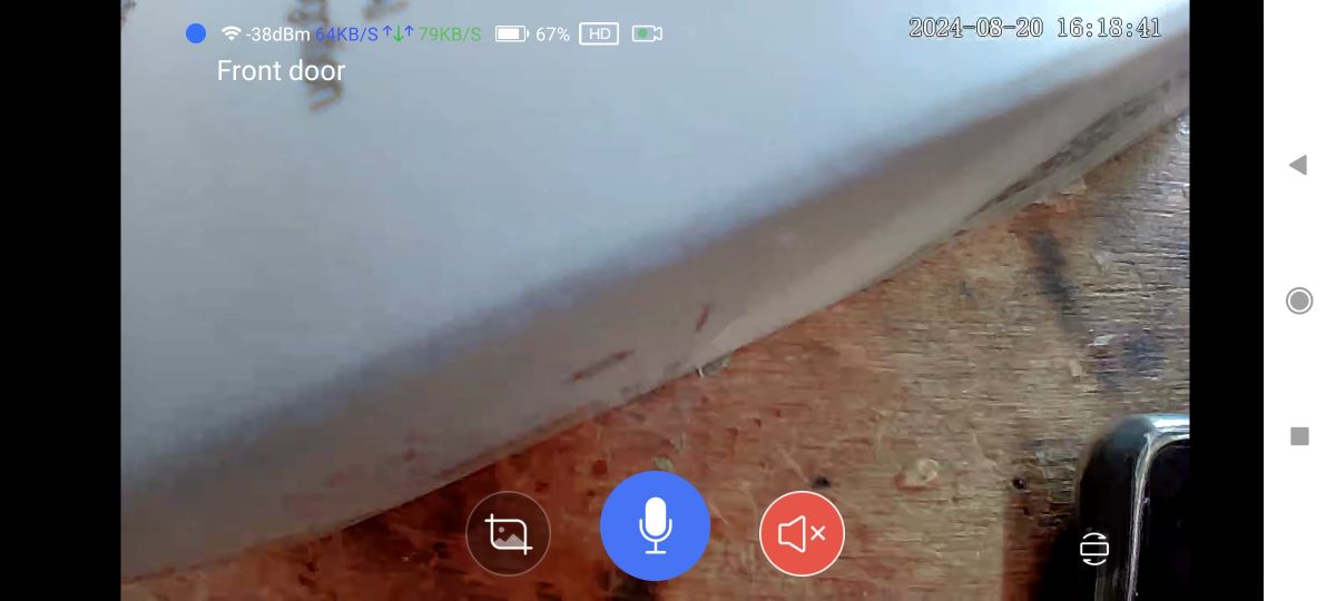

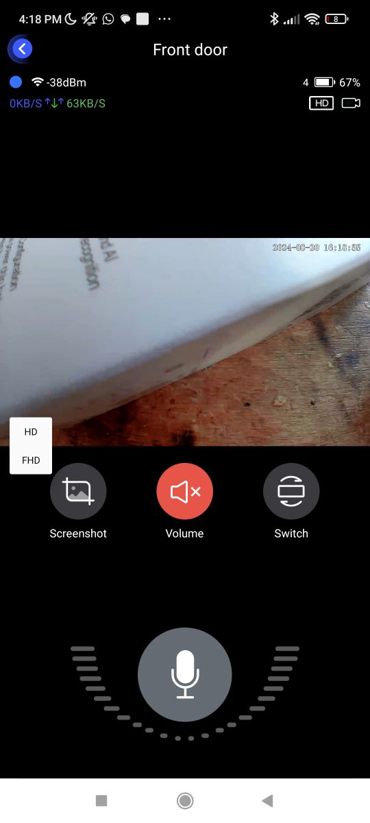

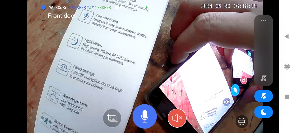

    In the app we have a list of cameras with their current view. In addition, you can see the status of the cells. Let's try entering the single camera view:

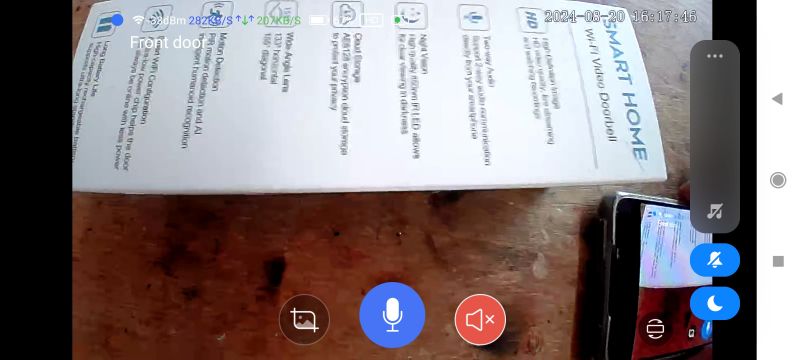

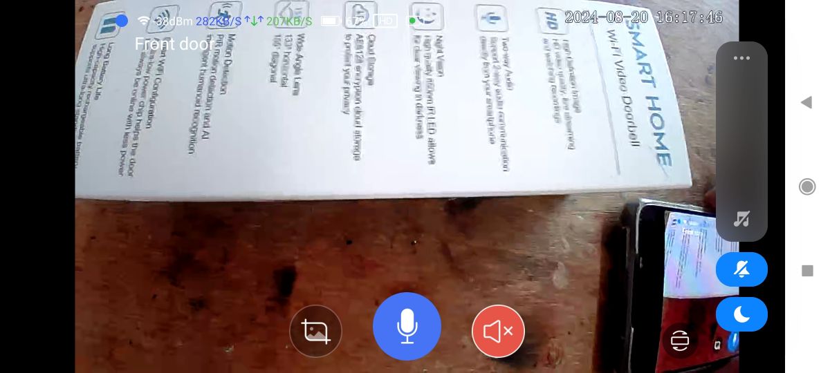

    Communication here is two-way - you can turn on the microphone, chat to the visitor.
    The latency is noticeable, the image probably flies through the Chinese cloud rather than locally. We have a full-screen mode:
    WiFi wireless video intercom - test, app and interior WiFi wireless video intercom - test, app and interior WiFi wireless video intercom - test, app and interior .
    We have the option to change the image mode from HD to FHD:

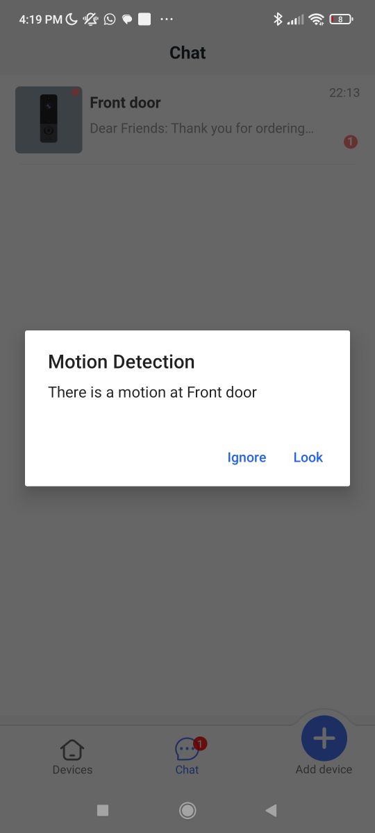

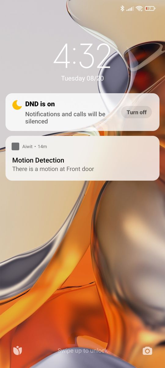

    Traffic notifications work:

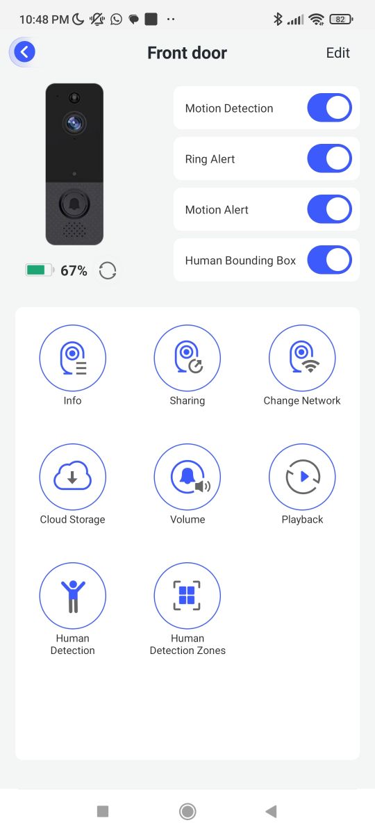

    Now let's see what's in the settings.

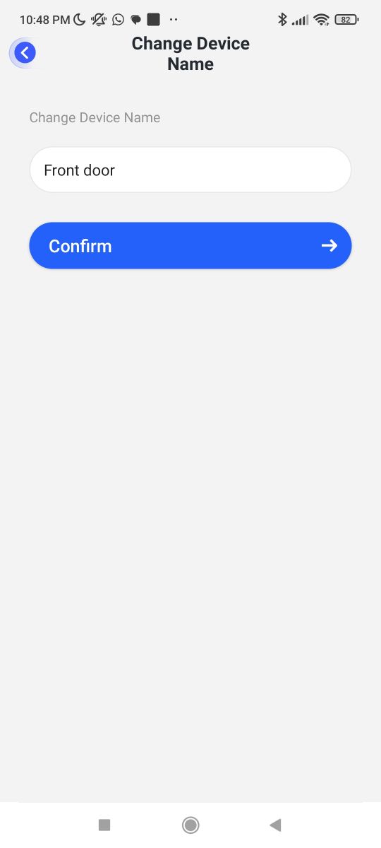

    The settings are quite rich. You can disable motion detection, motion notifications, ringtone, you can split cameras, you can change the network.... change the name of the device:

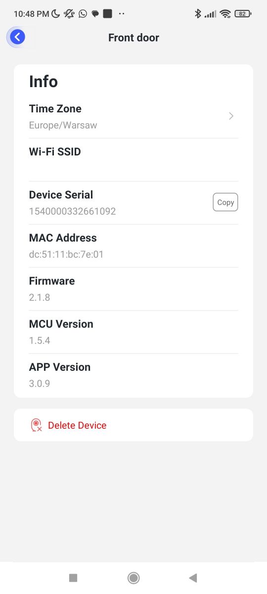

    Preview its information (delete it):
    They can be shared via QR code or, for example, via email:

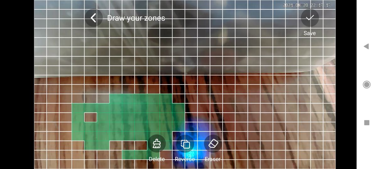

    It is possible to set in which zones the camera reacts to movement, so-called "zones/bounding boxes":
    This is really very convenient. Thanks to this, if the camera also looks partly at the street, for example, then they will not trigger the car notifications.

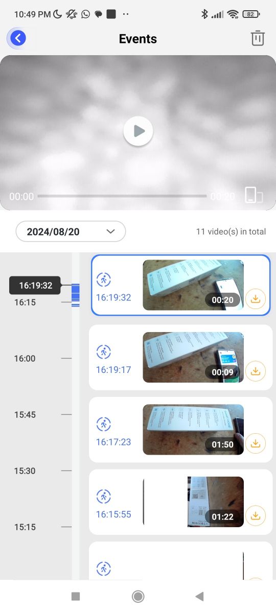

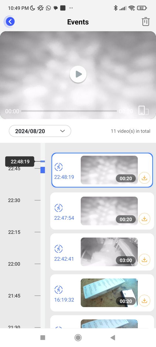

    Cloud storage option - here we supposedly have a history of videos....
    ... but none can be played without paying a fee.

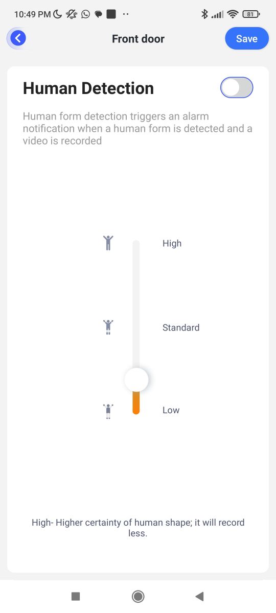

    The sensitivity of human silhouette detection can also be adjusted:

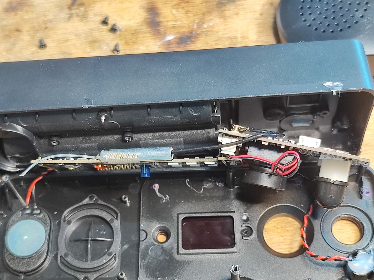

    Inside of the camera .

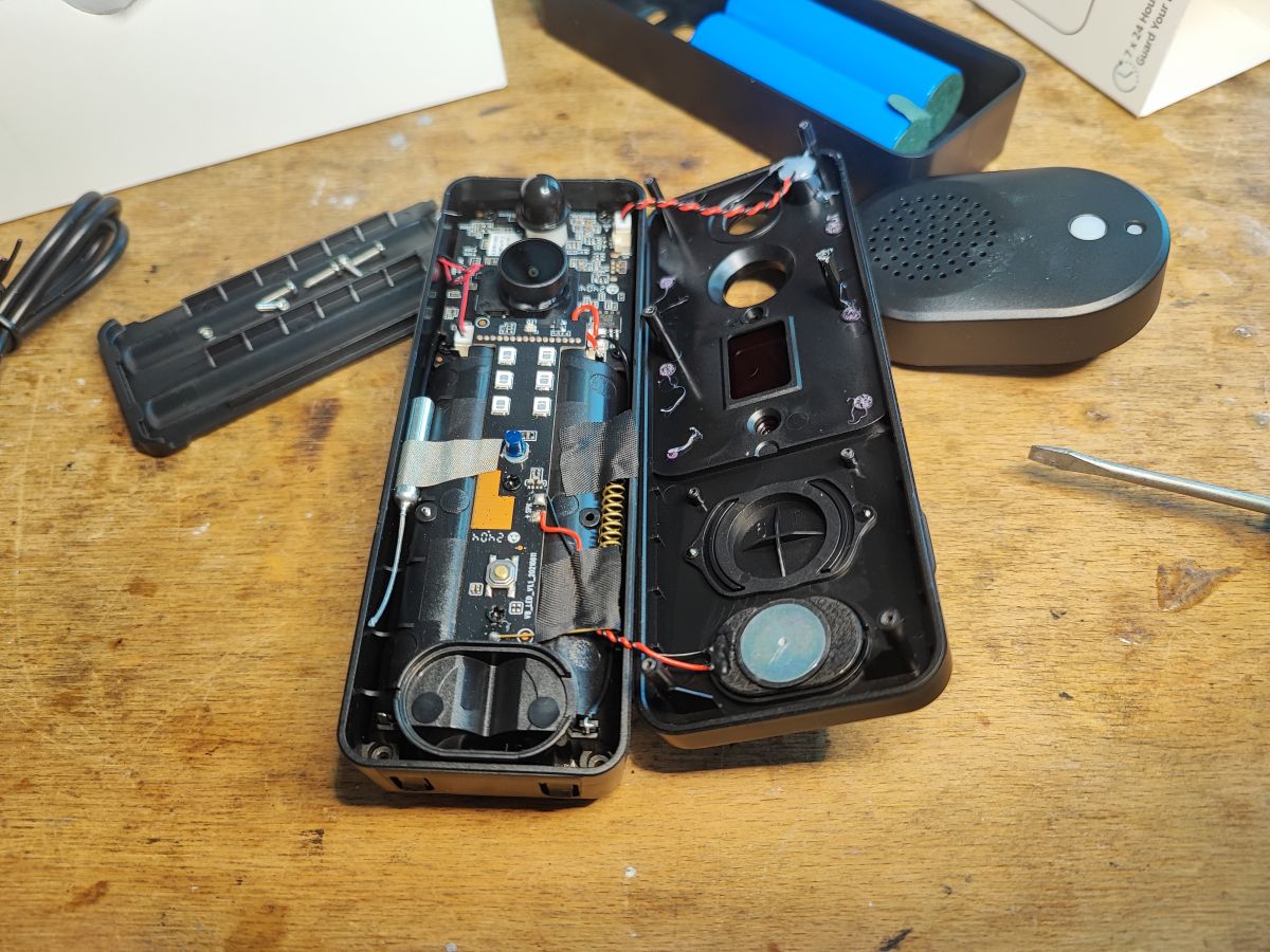

    It is now time to look inside. We unscrew the screws:

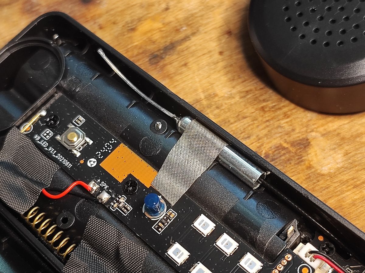

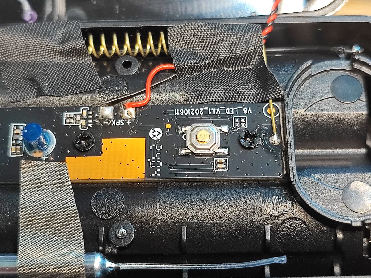

    You can already see the LEDs from the night vision, the microphone, the speaker, let's take a look at it one by one:
    SPK is of course an abbreviation for speaker.
    CPU: BT60?
    You can see the ASC4056 in the picture below:
    This is otherwise TP4054. Cell charge controller.

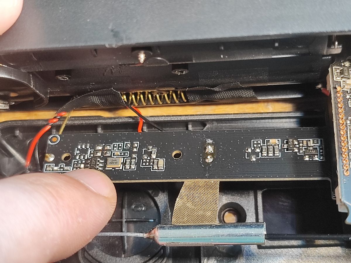

    This is what I'm guessing is a bell antenna on the RF:

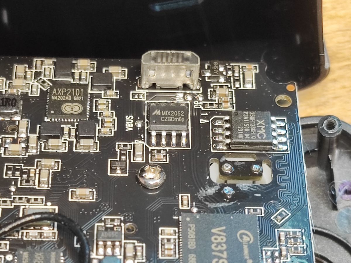

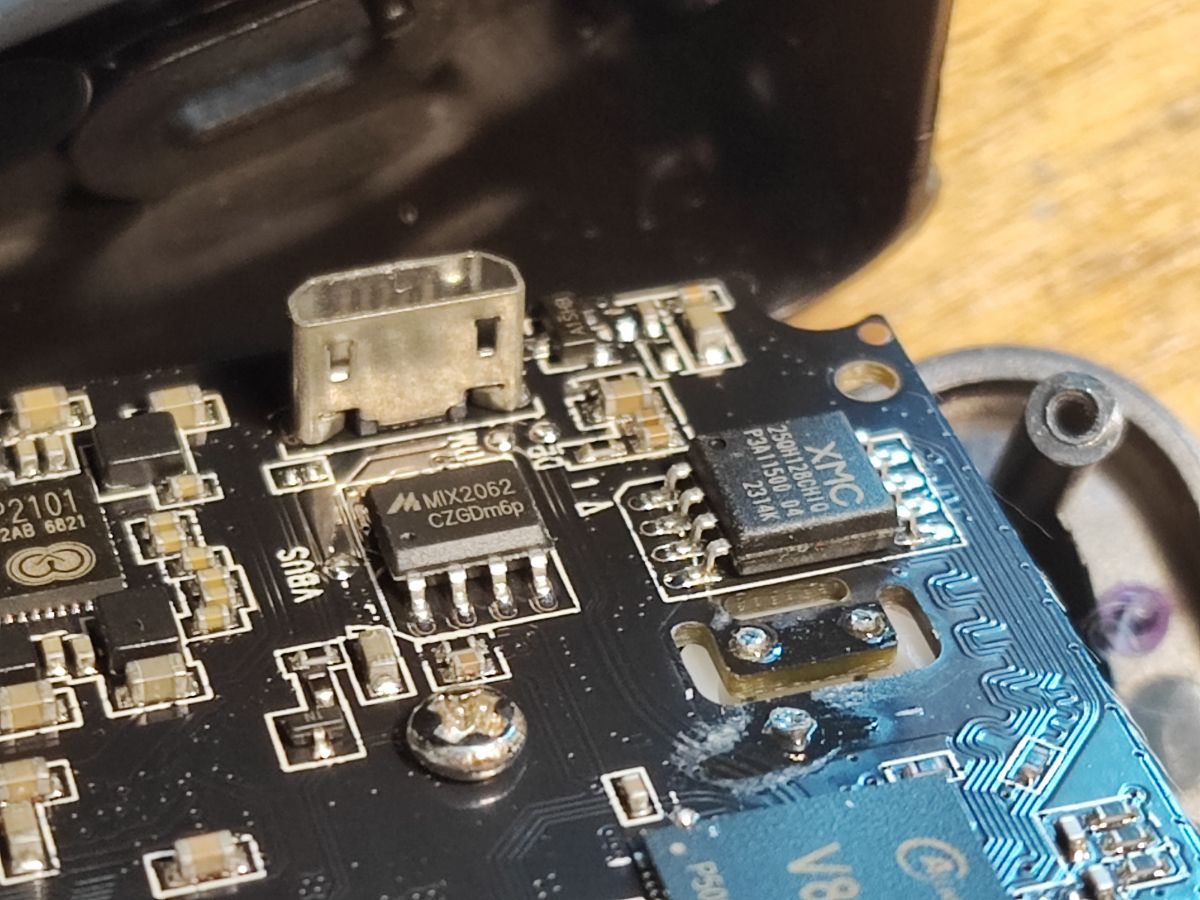

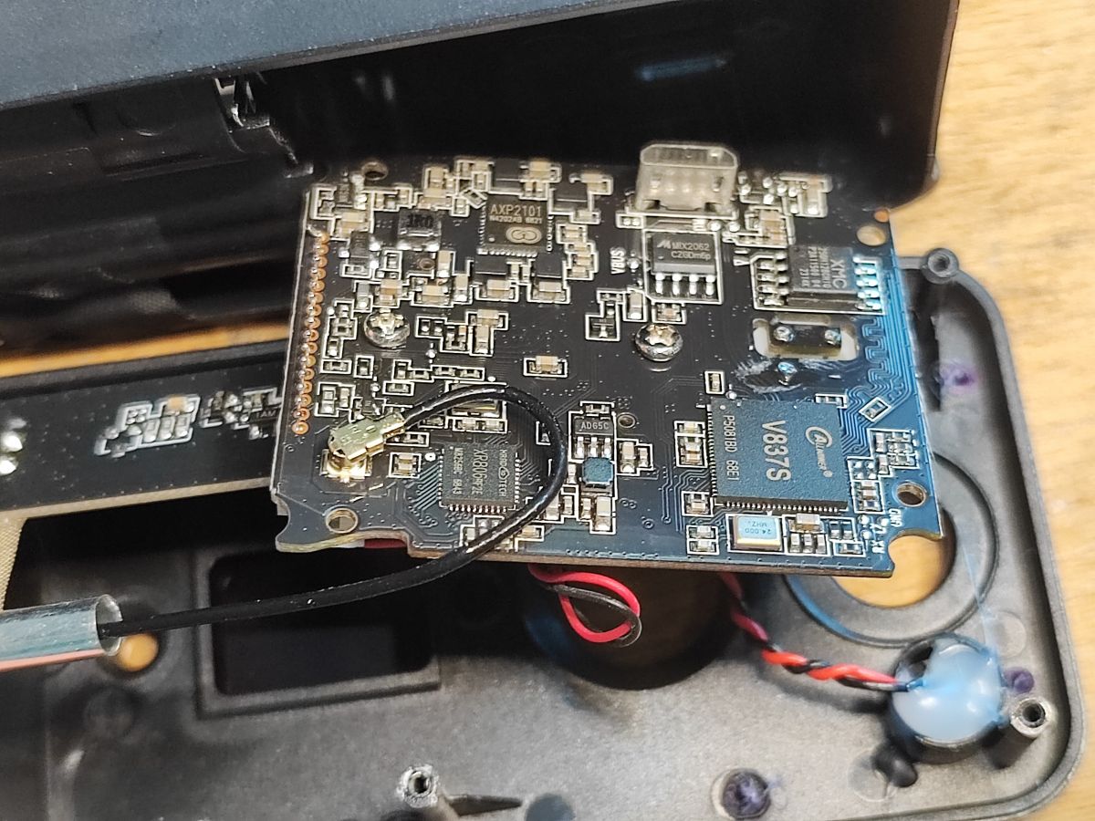

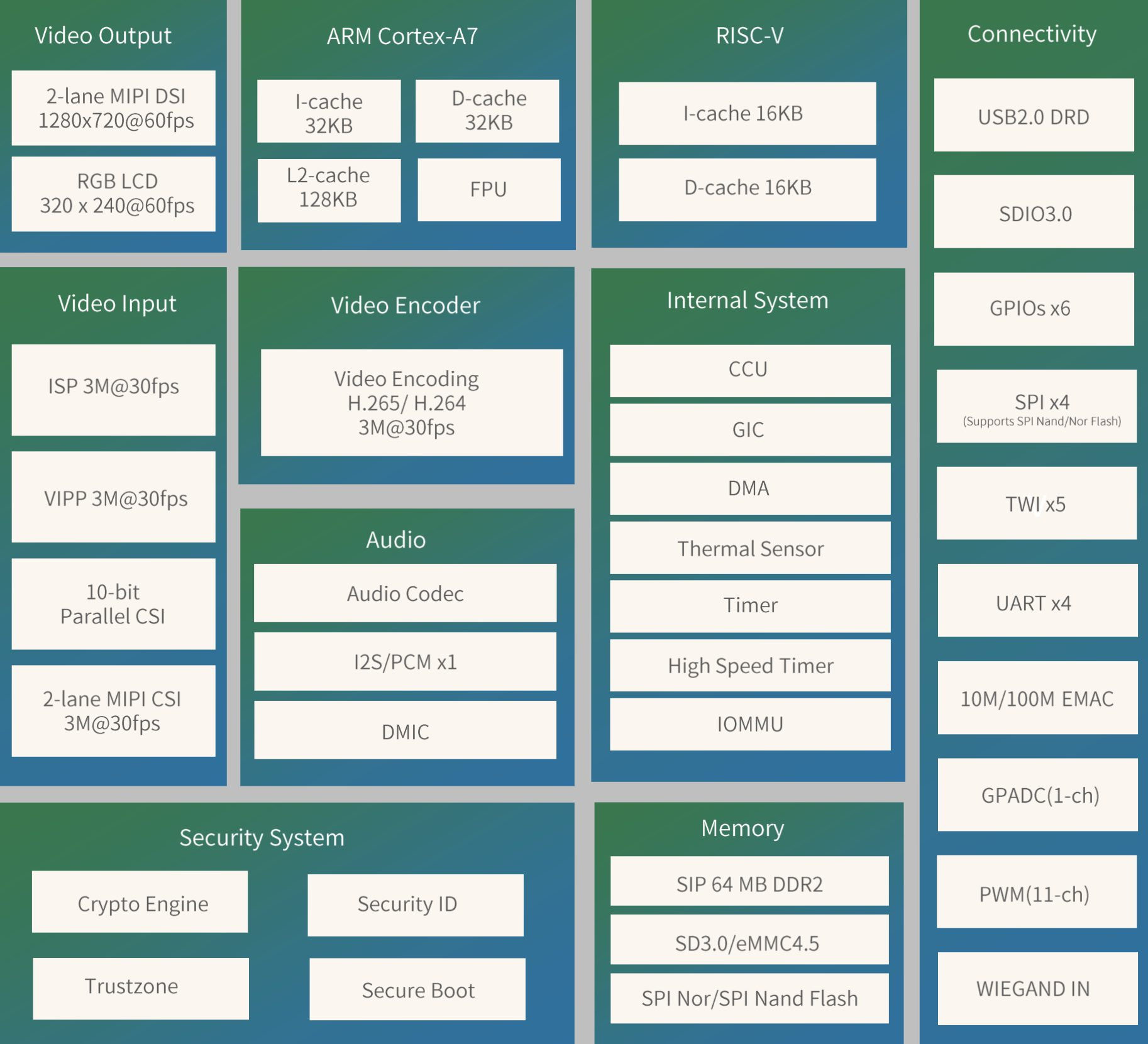

    Now for the most interesting part:
    WiFi wireless video intercom - test, app and interior WiFi wireless video intercom - test, app and interior WiFi wireless video intercom - test, app and interior WiFi wireless video intercom - test, app and interior WiFi wireless video intercom - test, app and interior WiFi wireless video intercom - test, app and interior WiFi wireless video intercom - test, app and interior c4729c891b .
    Here we have consecutively:
    - Alwinner V837S - H.264/H.265 SoC encoder for IP cameras

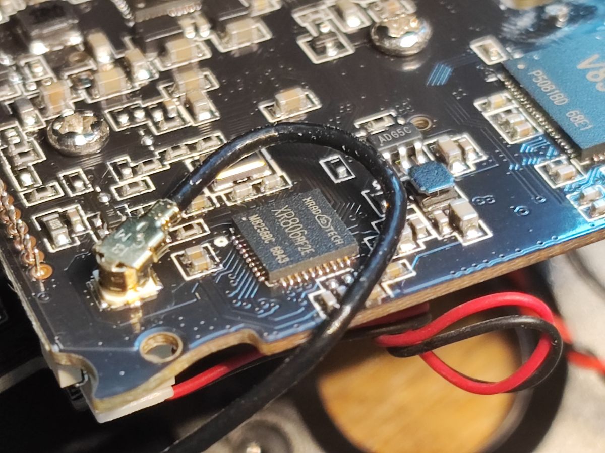

    - X806 XRadio - judging by the location on the PCB, by the connector from the antenna and by other chips from XRadioTech, this is the chip responsible for WiFi communication. Next to it I can also see some kind of inverter on AD65C
    - AXP2101 - the power supply circuit from the cell, please note those coils around, the example diagram of its application will clarify a bit, there are different output voltages:

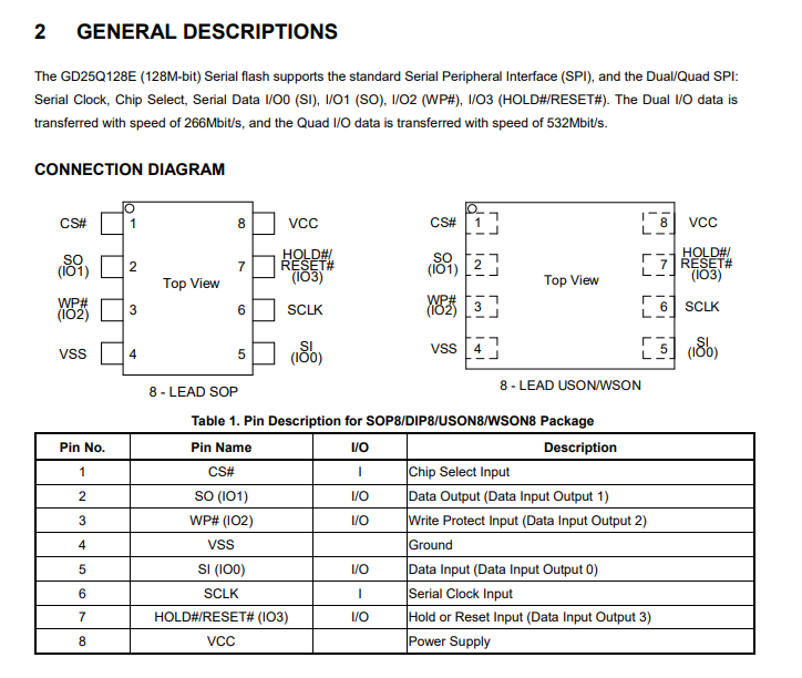

    - XMC 25QH128CH10 - Flash memory, 128Mbit

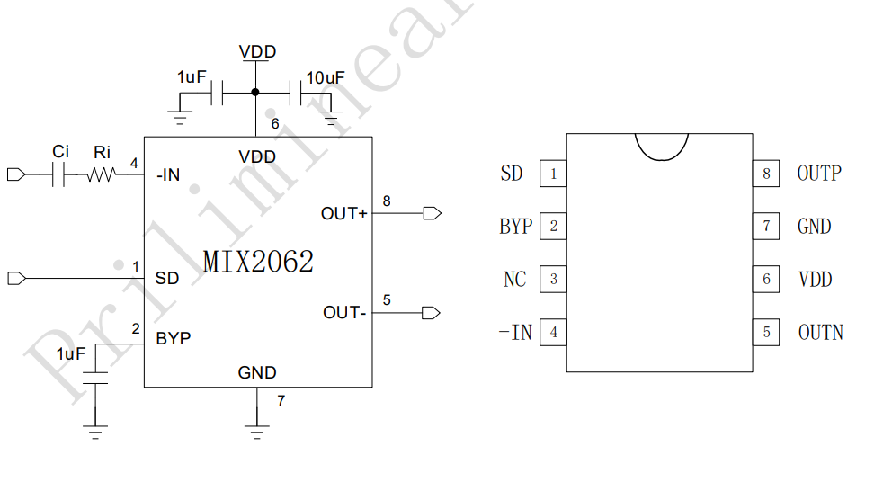

    - The MIX2062 is a Class D audio amplifier for a loudspeaker:
