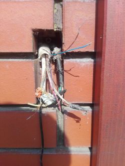

    Outside, I would lead two strands (of course, earth gel-coated 4X2X 0.5 mm). One can be led directly to the video intercom panel, and the other to the first drive of the gate and from there to the second. I would also give a connector (twisted pair again) between the drive of the first gate and the video intercom panel.
    We have some cables piled up under the video intercom panel :( from the house, from the gate drive, from the striker, or from some combination lock or exit button. While it does not matter in the case of a metal post, in a brick post it is not always easy and reliable to connect so many cables under the panel. Therefore, in such situations, it is worth providing, for example, a recessed box in the wicket post from the inside. We run cables from the house and, for example, from the drive to it, and then from there to the door panel, catch and other accessories. (at the construction stage, a 20 mm hard conduit with a remote control is enough). We can also lead both cables (twisted pair from the house) to it and leave it with cable / cables to gate drives.
    Enclosed are examples of such boxes, as well as an example of connecting cables under the panel (not mine :) ), where the connection itself is not always too elegant, and then it is not always easy to screw the panel itself on.
    Since you are at the stage of building a fence, make sure at this stage:
    wicket on adjustable (screw) hinges, the anchor of the catch and installed in such a way that this catch can be replaced in the future, handles instead of handles) Modifications at a later time can be expensive and not always aesthetic and fully functional.
    This does not exhaust the topic, but I hope it brings it closer.
