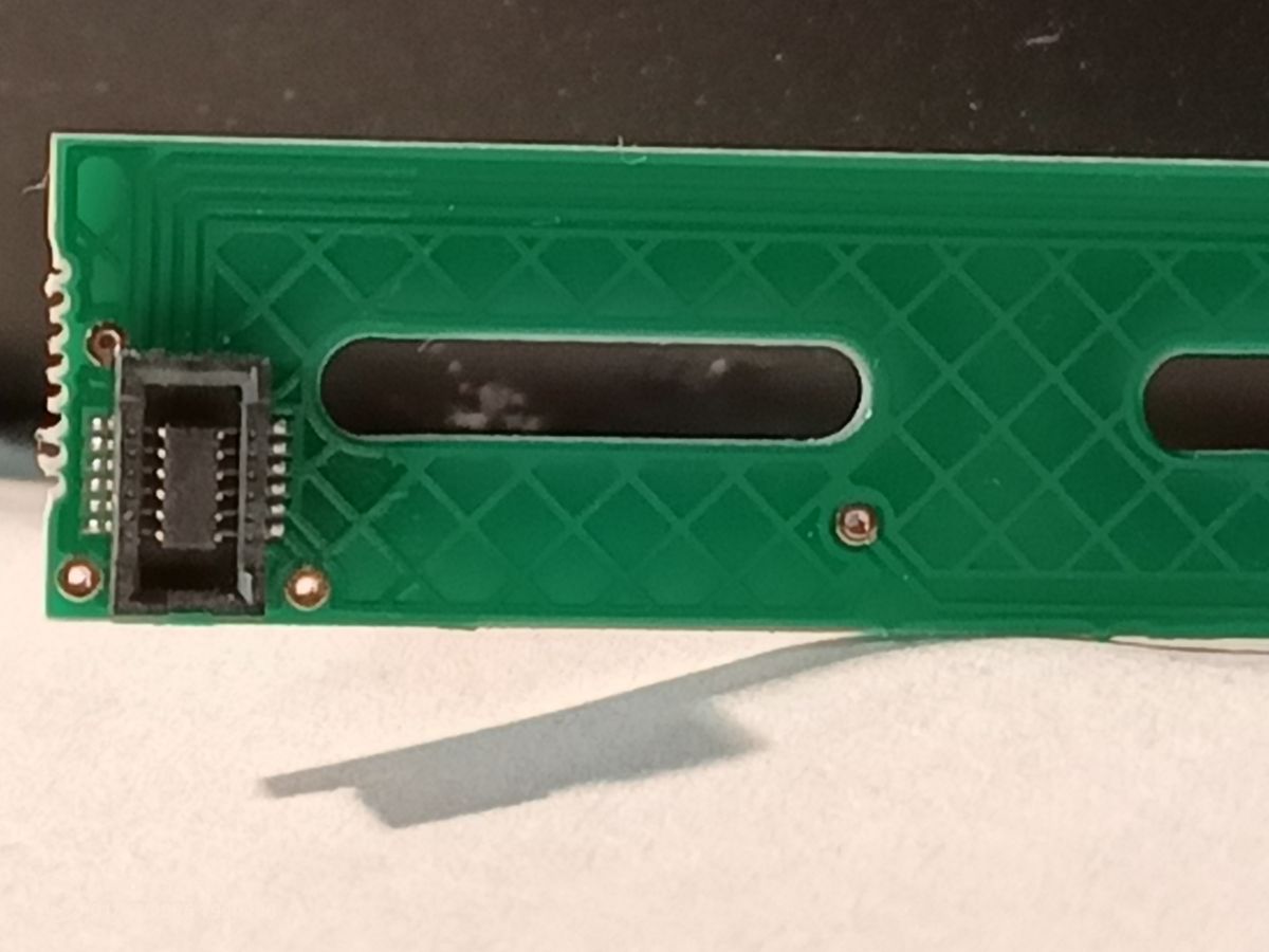

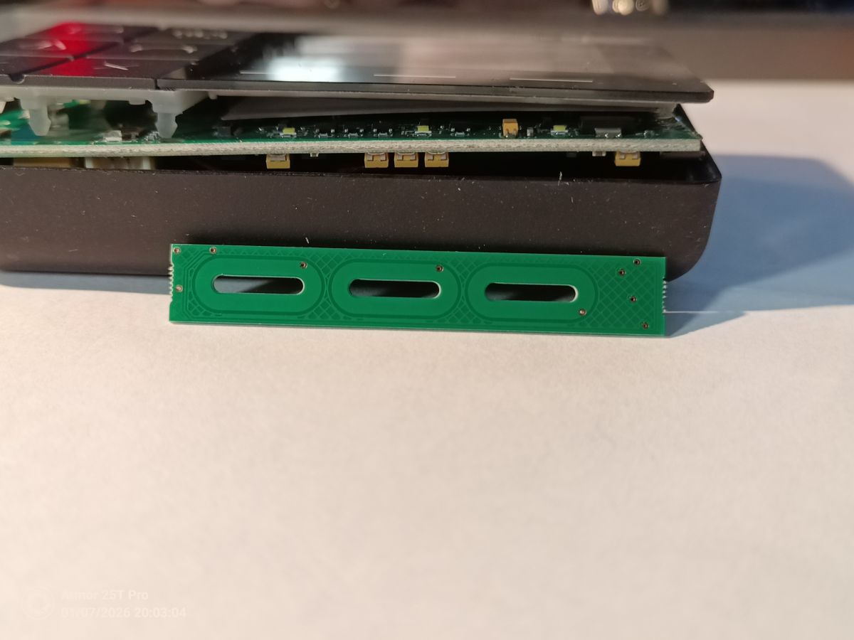

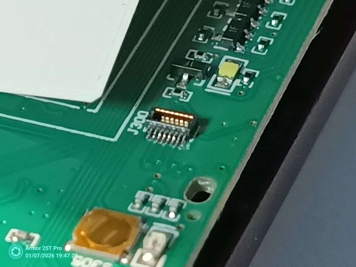

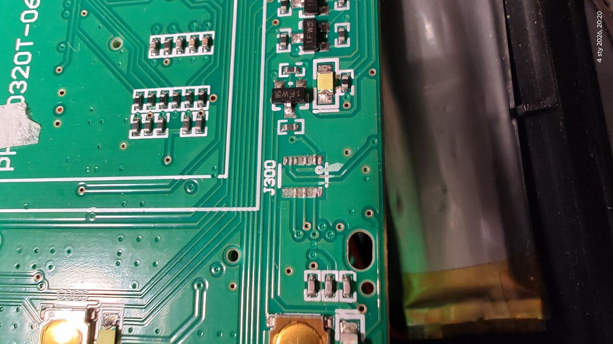

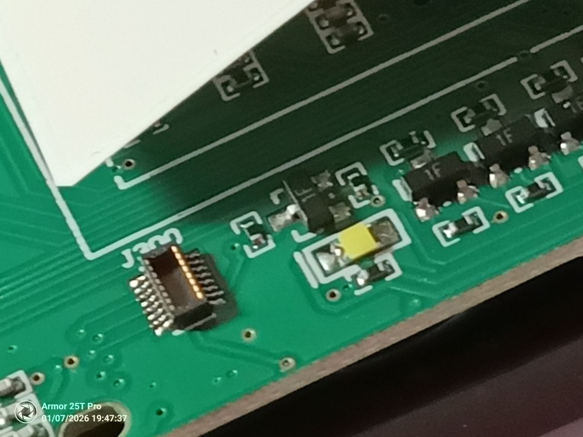

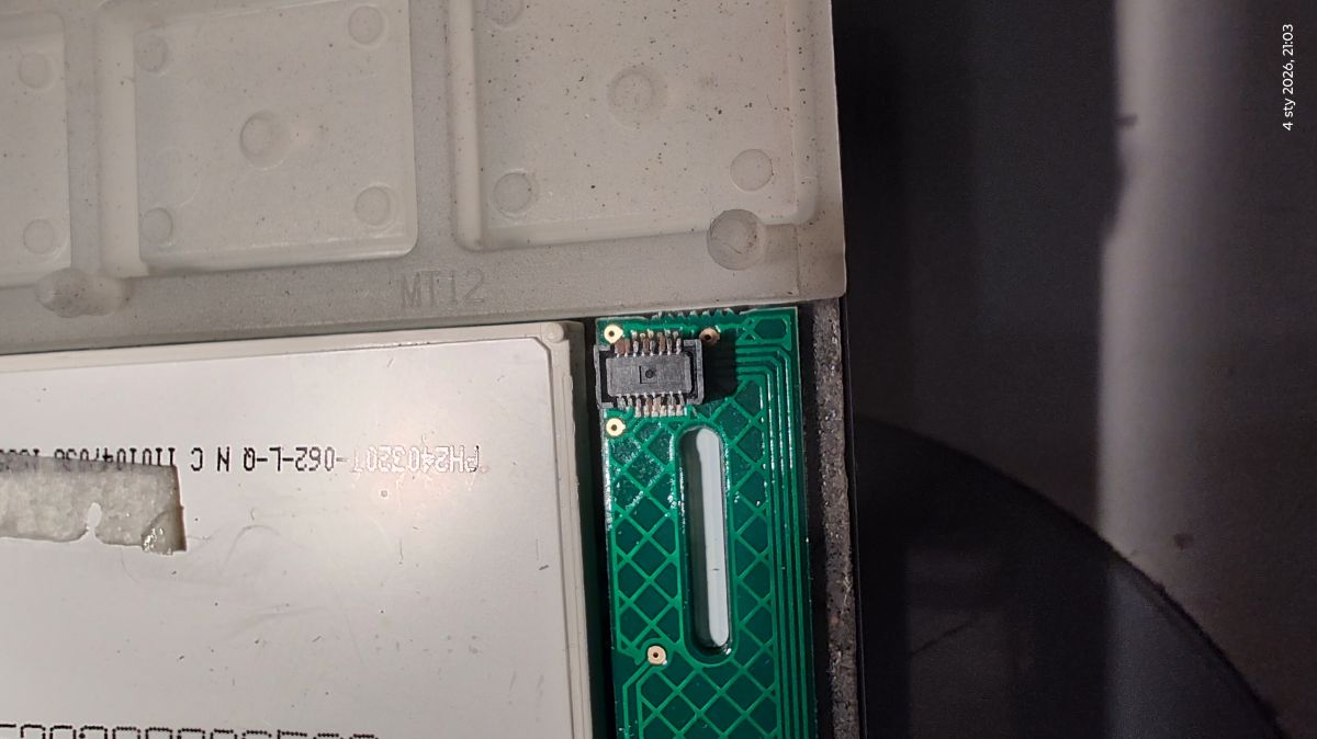

    I'm looking for a picture of the display side of the board, specifically the flex ribbon from the touch button connectors.
    I got my hands on a repair copy with the ribbon torn out, only that the ribbon is gone, only a trace of the ribbon torn "alive" from the board and the fastener was left.
    Part of a green PCB with exposed solder pads at connector J300
    Added after 1 [minute]:
    Close-up of flexible ribbon cable connector on a green printed circuit board

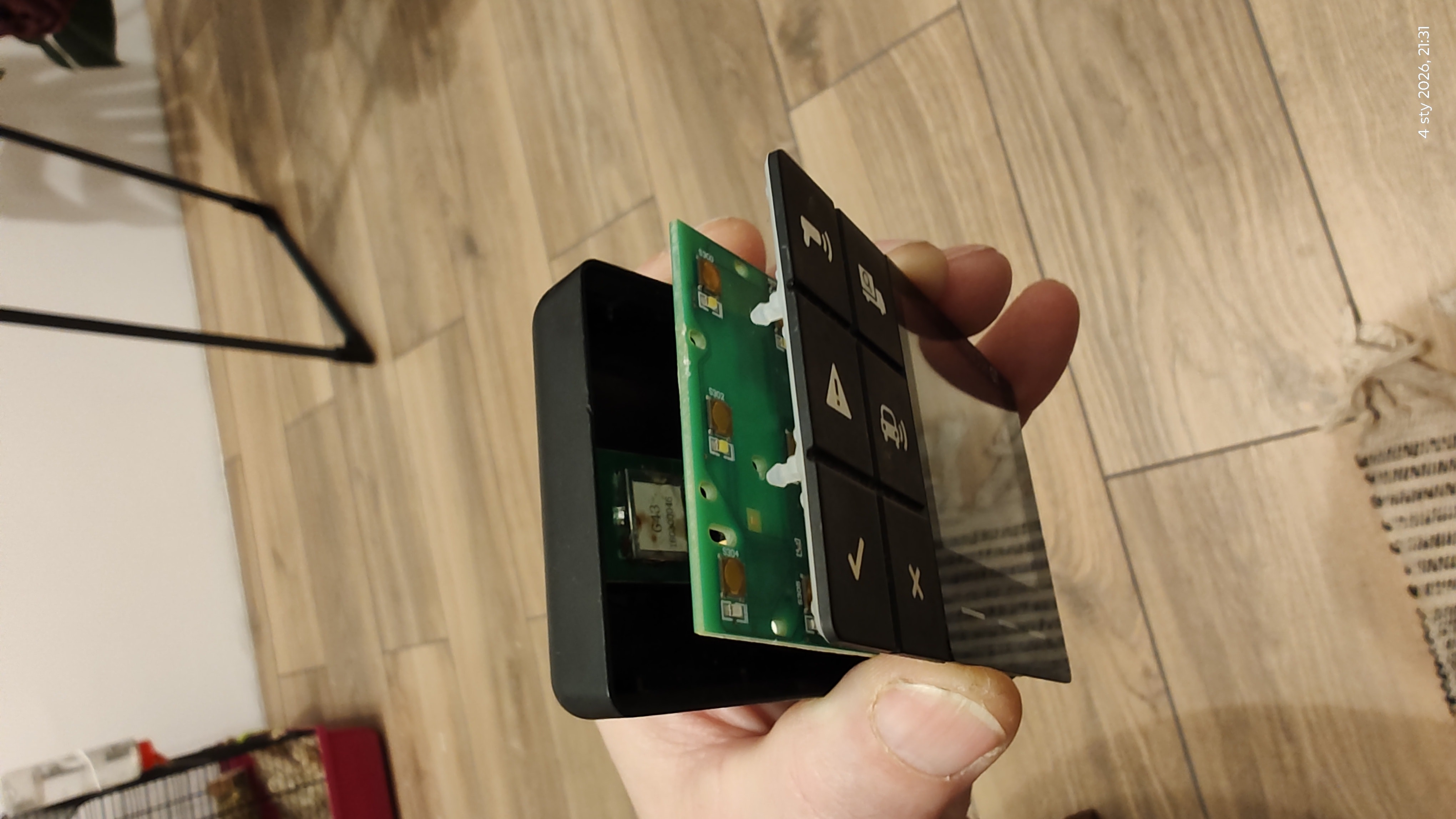

    But how do you take the GT apart without wrecking it? Describe it somehow with pics so someone dares. A manual like this.
  • #34 21798980
    asustan
    Posts: 45
    On the keyboard side, start levering from the front, as you can see in the photo, the keyboard and display are fastened with rubber clips, it is easy to lever, then lever the motherboard from the same side (left). Do not lift from the right side, because there is a tape from the display, it is easy to tear it.

  • #35 21802140
    breshnew
    Posts: 76
    Rate: 28

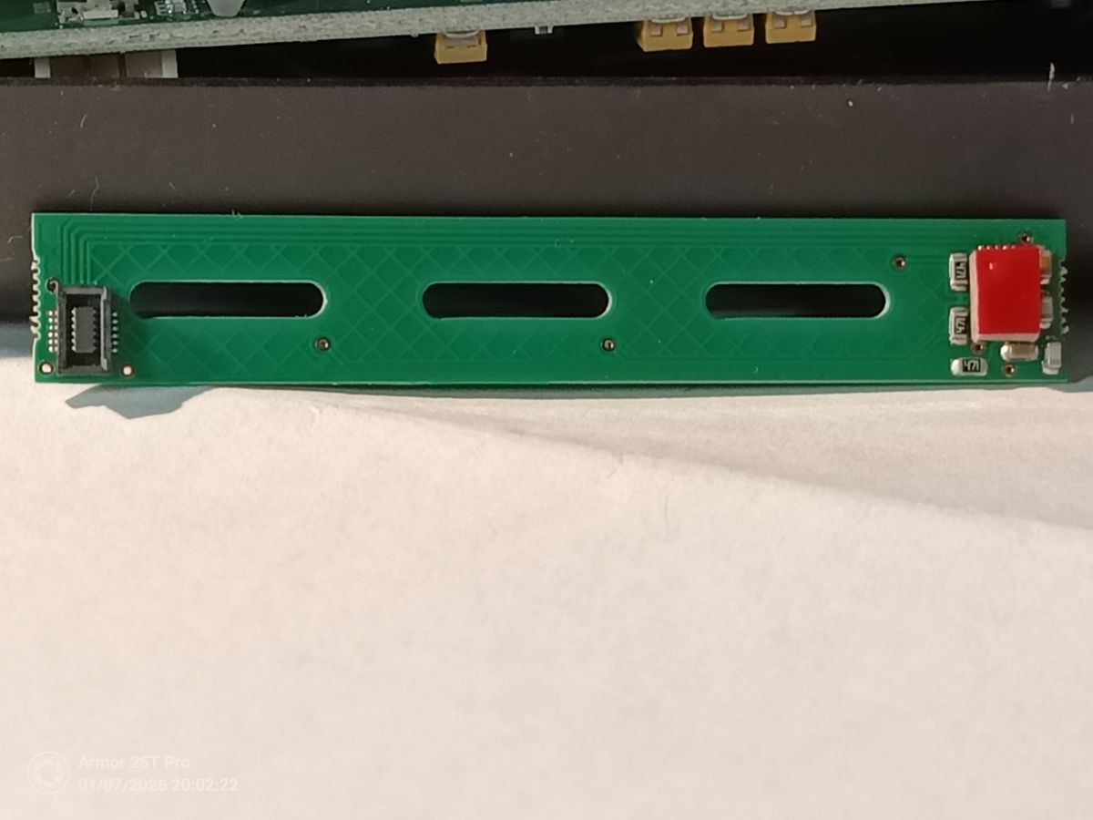

    Close-up of a green touch panel with a connector and two rectangular openings Close-up of J300 connector on green PCB with electronic components Close-up of a green PCB with J300 connector and surface-mounted electronic components Green touch panel with slotted holes and red component on the right Close-up of green touch panel beside the casing of a disassembled electronic device Close-up of green touch panel beside the casing of a disassembled electronic device
    It's not actually a ribbon but a touchpad
  • #36 21802204
    asustan
    Posts: 45
    Awesome, thanks for the pics, they have brightened my mind:-) . Obviously it's not the ribbon, it's just that in my copy the plug is torn out and sits in the socket.
    Thanks again.
