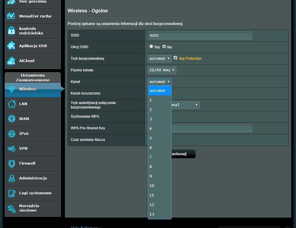

  • #12 17020072
    fido100
    Posts: 29
    I don't know if that is possible. I can set one specific channel.
    ASUS DSL-N14U Router Not Detecting CANON iP7250 WiFi Printer Despite Correct Settings
    maybe something to do with "channel band"?
  • #13 17020082
    AxelNext
    Posts: 4622
    Help: 265
    Rate: 454
    What's under there? Extended channel ?
  • #14 17020083
    hermes-80
    Posts: 12014
    Help: 1177
    Rate: 743
    Channel band on 20MHz and channel 6 and try.

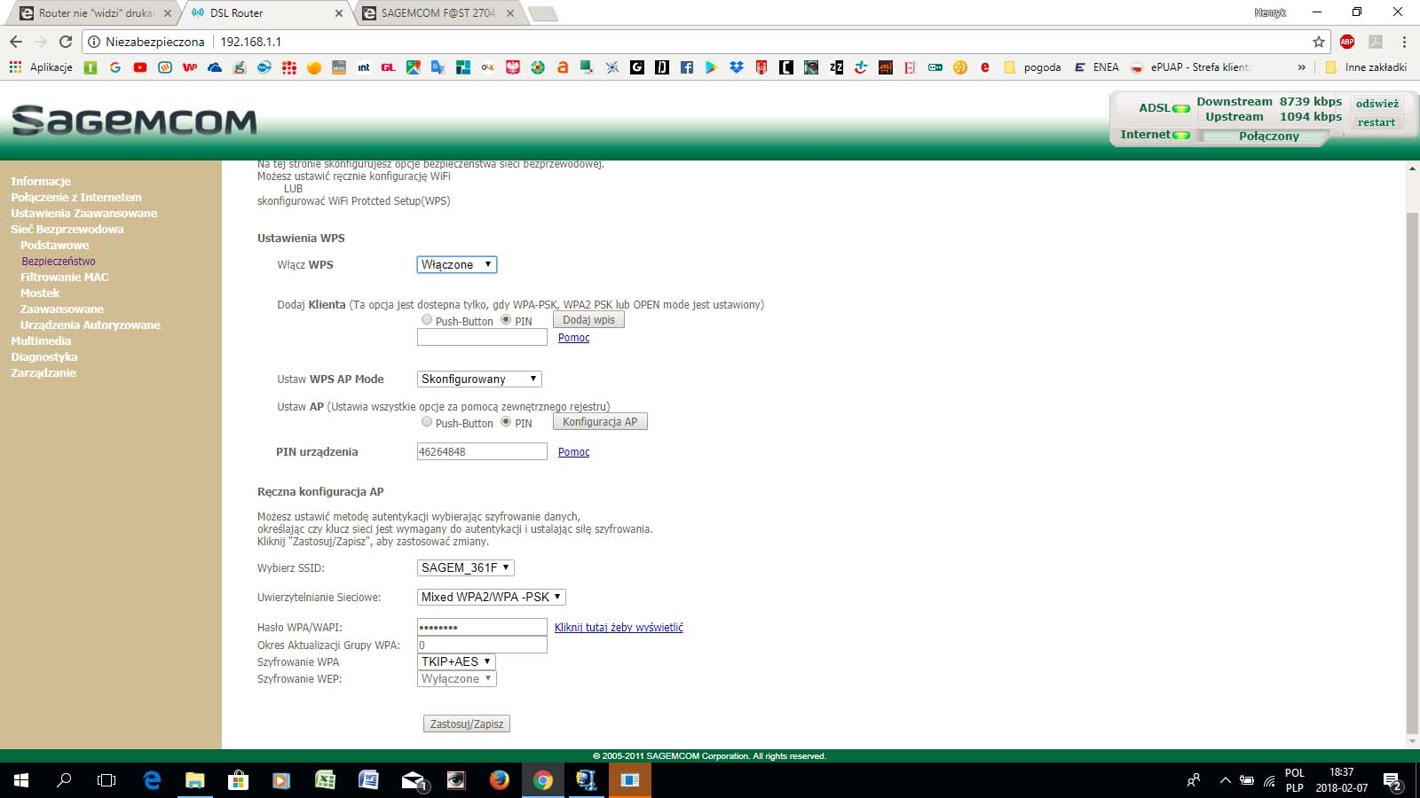

  • #16 17020254
    fido100
    Posts: 29
    These are scans (for comparison) from the old router on which the printer works.
    ASUS DSL-N14U Router Not Detecting CANON iP7250 WiFi Printer Despite Correct Settings ASUS DSL-N14U Router Not Detecting CANON iP7250 WiFi Printer Despite Correct Settings
    I'm letting go of the WiFi installation. I will install it with a USB cable straight to the router. I don't like it because it blocks my only USB port.
  • #17 17020288
    AxelNext
    Posts: 4622
    Help: 265
    Rate: 454
    Your old router was set to work on the auto channel, but from what you can see it worked on channel 11, so set the Asus to channel 11, save and the printer should find the Asus SSID.
  • #18 17021017
    fido100
    Posts: 29
    Changing to channel 11 did nothing. For now, I let it go, and if I need a USB port on the router for flash memory, I will return to trying to install the printer via WiFi.
    But if any of you come up with a brilliant idea, please write.
