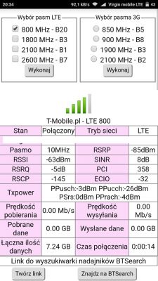

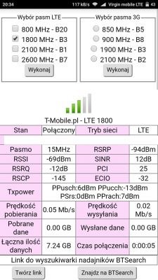

    here I have a measurement from T-Mobile from the cheapest router in the room and I have only 3 lines on 5 possible ranges. So it should be good with a dipole antenna.
    and what bands will I write will only connect via wifi.
    Antenna Choice: ATK-LOG ALP LTE MIMO vs POWER STRONG DUAL 50dBi vs DUAL TAJFUN 20dBi for Router
    I measured the bandwidth and works only on 800 and 1800. Although the router is at home and it is not so bad, but with the antenna will be more stable. So what antenna do you suggest, because I'm still of the opinion that the one from Dipol will be the best solution. Only if one polarization is enough or to be sure of the other. Or buy such a miracle link
    Antenna Choice: ATK-LOG ALP LTE MIMO vs POWER STRONG DUAL 50dBi vs DUAL TAJFUN 20dBi for Router Antenna Choice: ATK-LOG ALP LTE MIMO vs POWER STRONG DUAL 50dBi vs DUAL TAJFUN 20dBi for Router
    Combining both belt also made a lot of difference.

    Very good range, but if you want to improve something, take the one from Dipole, because the allegro is a linden tree. According to the specification, this cybertech antenna has a narrower band with 5db gain, identical gain. Both of what I see dual. Take what you like more, both will work rather on each band, as if you have run 2600. They will serve very well as a slight signal amplification and moving the signal pickup point outwards.
