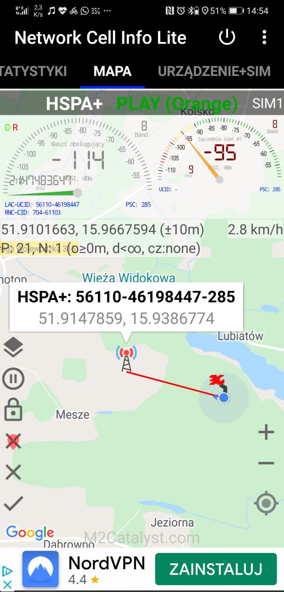

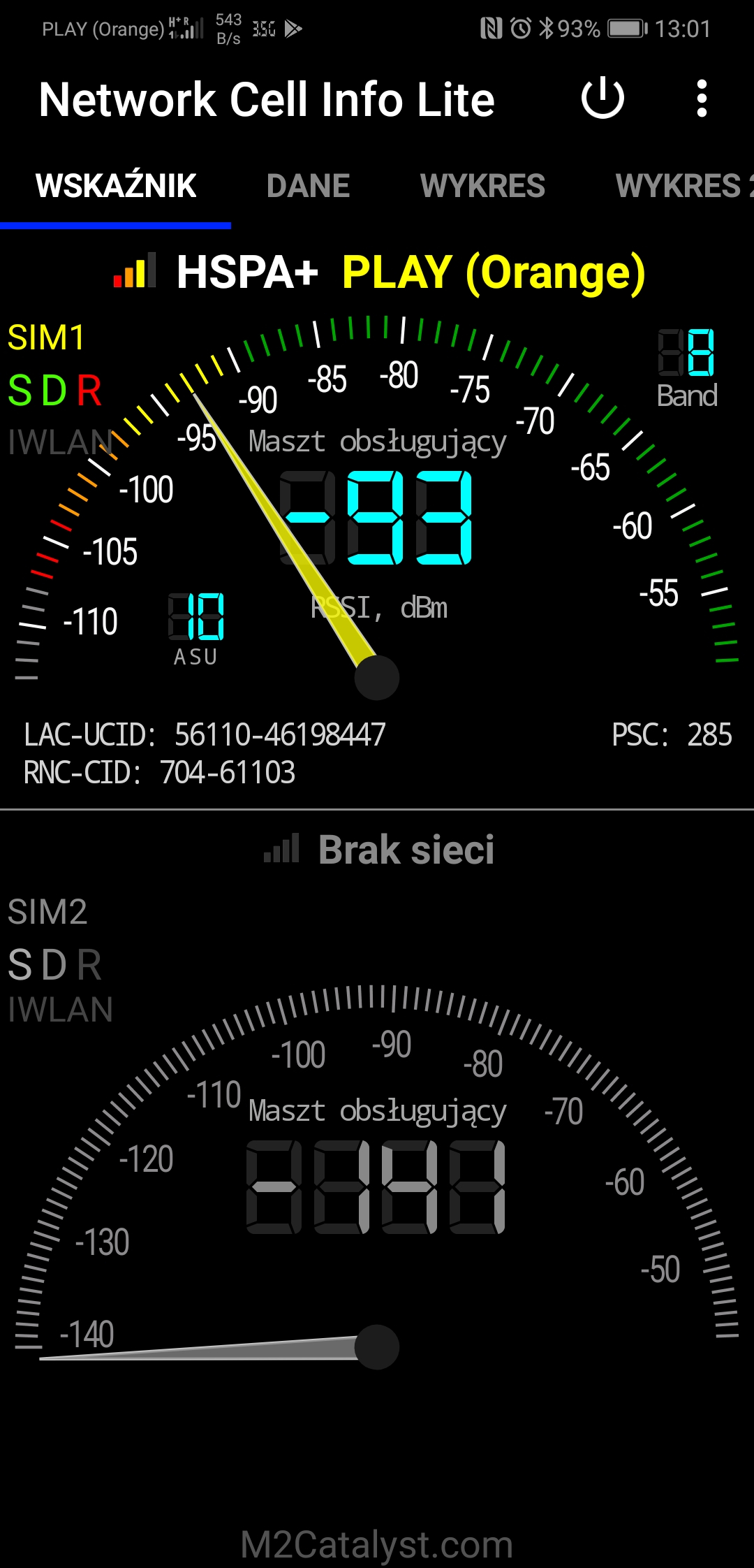

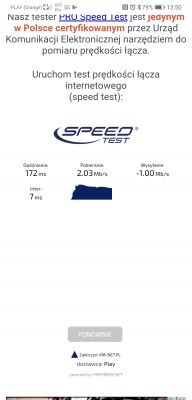

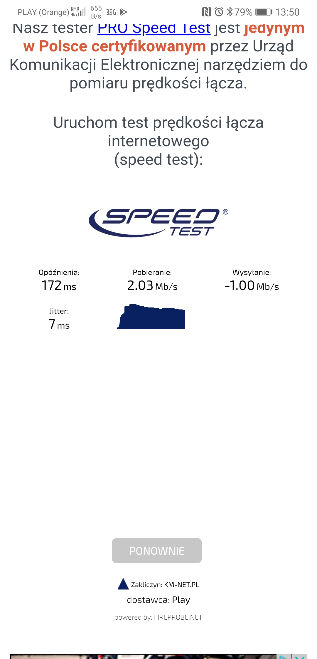

  • #10 18168832
    radojan
    Posts: 144
    Rate: 32
    ATK504 vs ATK-LOG ALP LTE Antennas: Differences, Price, Compatibility with DWR921 & Forest Coverage ATK504 vs ATK-LOG ALP LTE Antennas: Differences, Price, Compatibility with DWR921 & Forest Coverage ATK504 vs ATK-LOG ALP LTE Antennas: Differences, Price, Compatibility with DWR921 & Forest Coverage
    [img-0]
    Sent from the parcel but after an hour of fighting. The opening of the pages borders on a miracle.

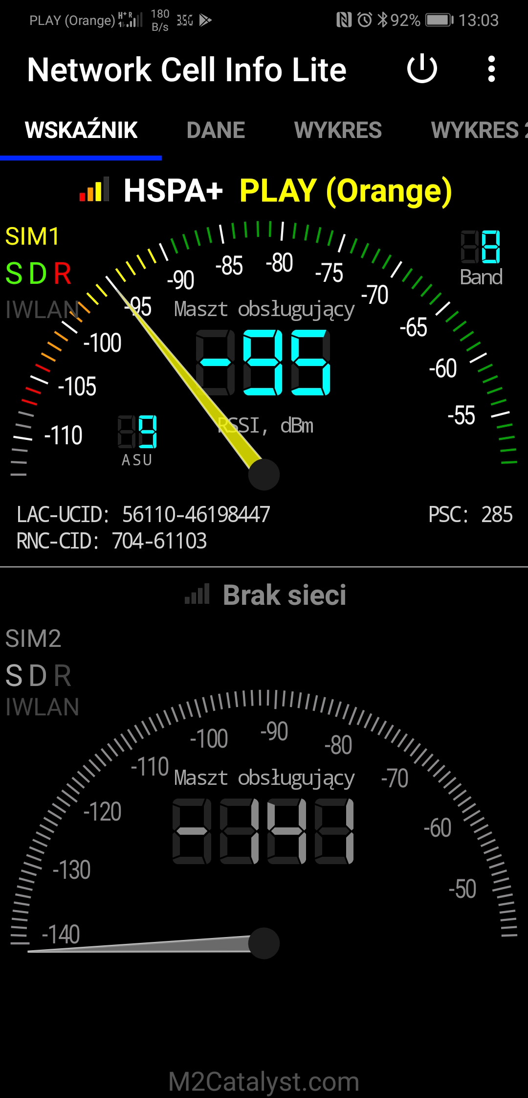

  • #11 18168876
    matek451
    Posts: 31278
    Help: 4356
    Rate: 5816
    Tests in RK on the 3G Orange network say nothing about Play's coverage in this place. Turn off RK on your phone or use Play internet card, this one has no access to RK. In domestic roaming, Play's voice card connects to BTS NetWorks Lubiatów on 3G UMTS900 Orange, signal is weak and DL is limited to 3Mb/s anyway. On this BTS Orange and T-mobile each have their own LTE1800 and LTE2100, BTS is refarming and this is good news. Konotop only with LTE800. Plus has LTE1800 and LTE900 in Lubiatowo and only LTE900 in Konotopa. Play launched BTS Konotop on LTE1800, LTE2100 and LTE1800. And it is from this BTS that the range for internet tariffs should be.

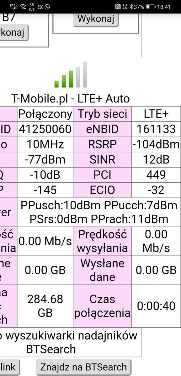

    Hello, back to the topic. Is it possible that the atk 504 antennas are faulty? On the huawei b525s 23a router with internal antennas and atk 504 outside there is no difference. Transmitter about 2 km through the forest and lake. 2-3 range LEDs are on on the router, no matter which antennas. Photo tests. ATK504 vs ATK-LOG ALP LTE Antennas: Differences, Price, Compatibility with DWR921 & Forest Coverage
  • #18 18672093
  • #19 18672717
    radojan
    Posts: 144
    Rate: 32
    In the router settings, I change to external antennas and physically screw the wires from the antennas. I have a problem with adding photos with tests. I'll try to resize the file later.

    Thanks for the instant reply. I have a multimeter at home and I will bring it over the weekend and check it next week. Photos with tests on the first with external antennas, the second internal. One more speed is at 15 mega. Like Lte +, but I did tests on each of the bands and rather these 15 are for 800. 1800 and 2100 are about 10, but they do not connect them together. I also bought an orange card and the range is the same but the speed is already 40. I would prefer to be on t-mobile because it is more beneficial for me. Strange because the transmitters are on the same mast. ATK504 vs ATK-LOG ALP LTE Antennas: Differences, Price, Compatibility with DWR921 & Forest Coverage ATK504 vs ATK-LOG ALP LTE Antennas: Differences, Price, Compatibility with DWR921 & Forest Coverage

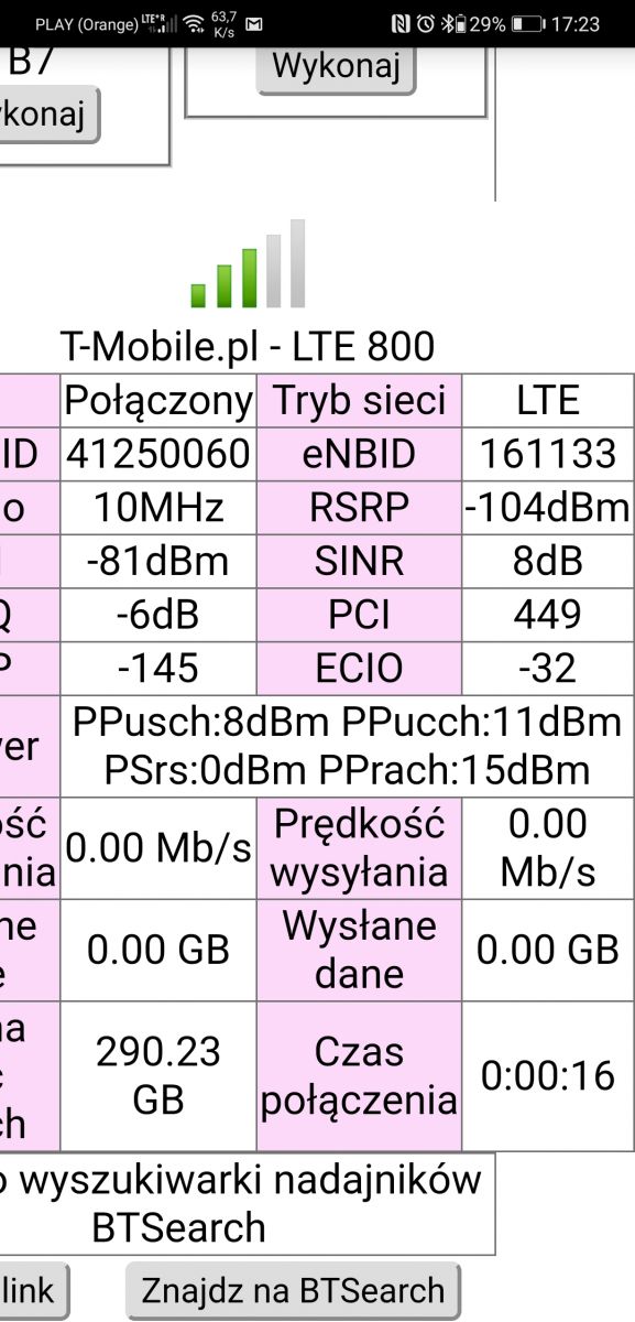

  • #22 18674496
  • #23 18674914

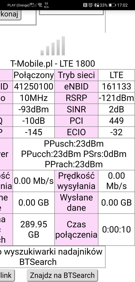

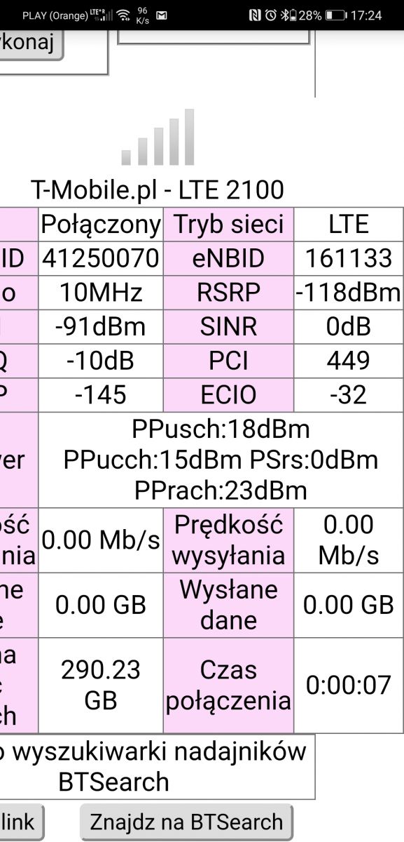

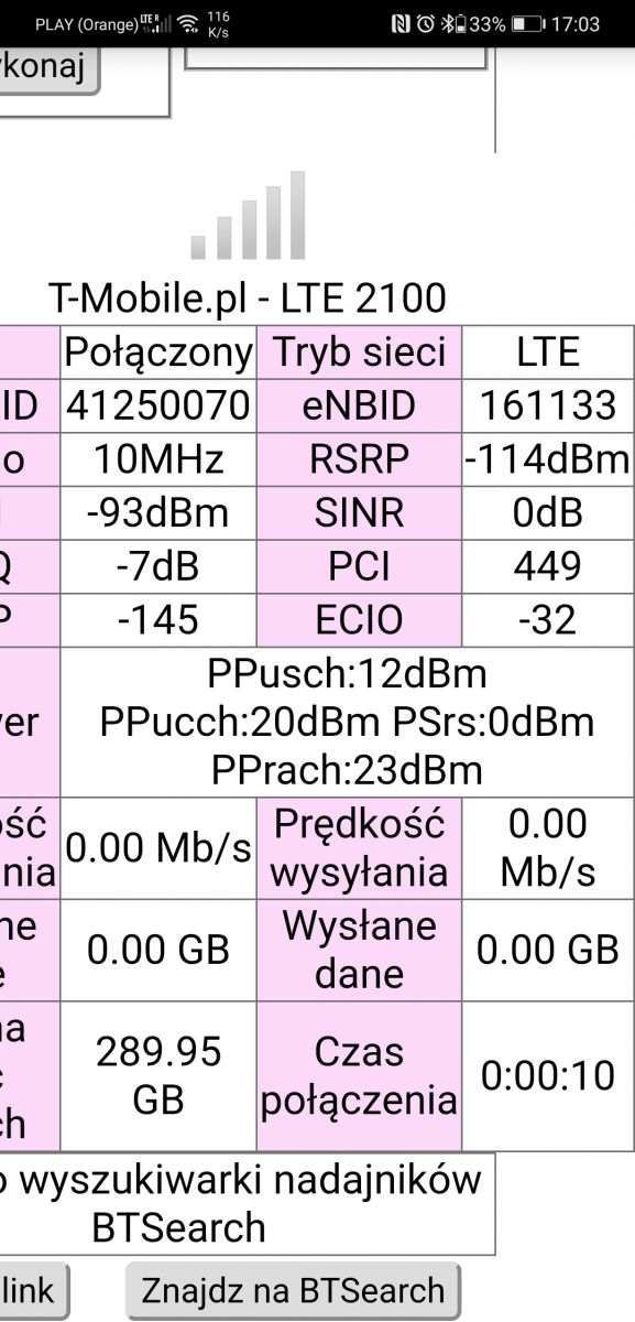

    radojan
    Posts: 144
    Rate: 32

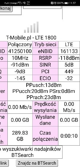

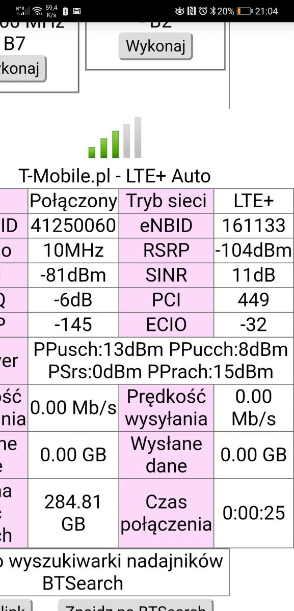

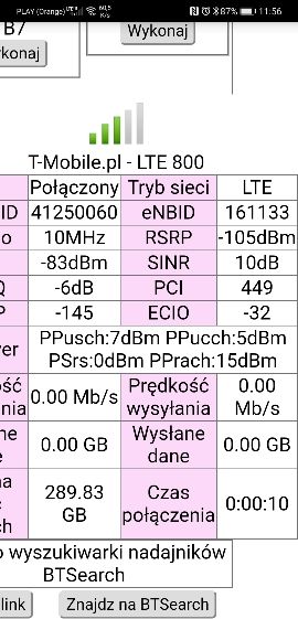

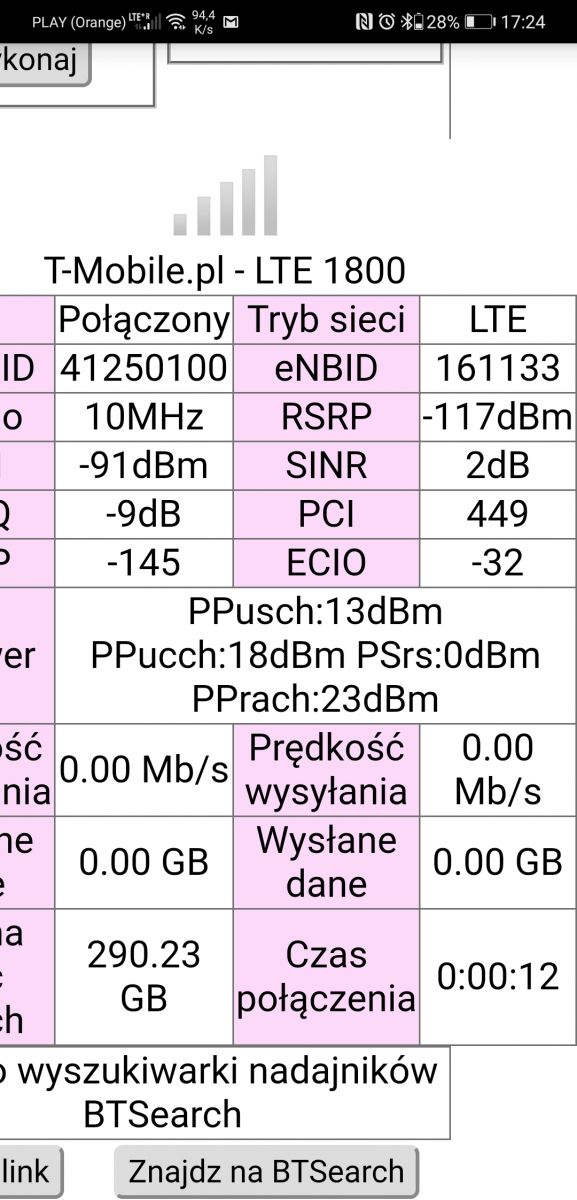

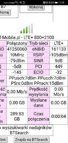

    I wrote that I did tests on single bands, but it doesn't matter. Nothing changes except that no diode from the range is lit on the 1800 and 2100 bands. Tests with or without aggregation is the same as speed and power on 800. Later I will post a photo.
    Added after 3 [hours] 55 [minutes]:
    I did the tests ATK504 vs ATK-LOG ALP LTE Antennas: Differences, Price, Compatibility with DWR921 & Forest Coverage ATK504 vs ATK-LOG ALP LTE Antennas: Differences, Price, Compatibility with DWR921 & Forest Coverage ATK504 vs ATK-LOG ALP LTE Antennas: Differences, Price, Compatibility with DWR921 & Forest Coverage ATK504 vs ATK-LOG ALP LTE Antennas: Differences, Price, Compatibility with DWR921 & Forest Coverage ATK504 vs ATK-LOG ALP LTE Antennas: Differences, Price, Compatibility with DWR921 & Forest Coverage ATK504 vs ATK-LOG ALP LTE Antennas: Differences, Price, Compatibility with DWR921 & Forest Coverage
  • #24 18675592
  • #25 18676274

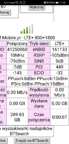

    radojan
    Posts: 144
    Rate: 32
    Tests with ATK504 vs ATK-LOG ALP LTE Antennas: Differences, Price, Compatibility with DWR921 & Forest Coverage one outdoor and one indoor antenna. ATK504 vs ATK-LOG ALP LTE Antennas: Differences, Price, Compatibility with DWR921 & Forest Coverage
    Two inside. ATK504 vs ATK-LOG ALP LTE Antennas: Differences, Price, Compatibility with DWR921 & Forest Coverage ATK504 vs ATK-LOG ALP LTE Antennas: Differences, Price, Compatibility with DWR921 & Forest Coverage ATK504 vs ATK-LOG ALP LTE Antennas: Differences, Price, Compatibility with DWR921 & Forest Coverage

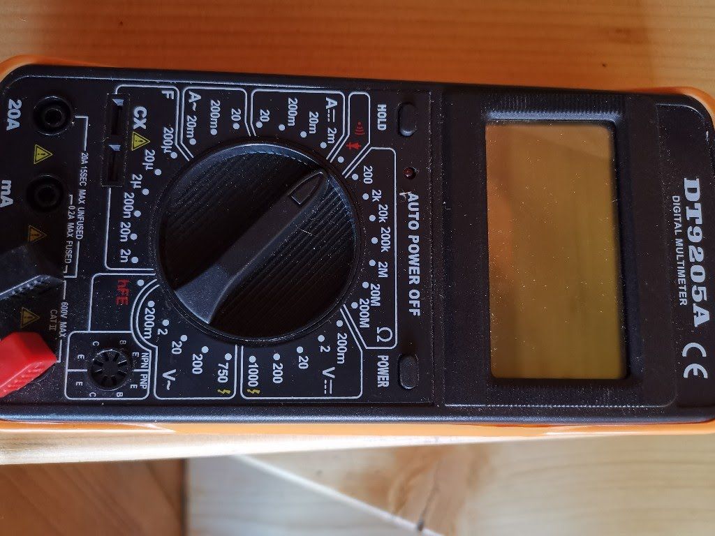

    Hello, what's up with this short circuit on the antennas. I have a multimeter but I don't know how to check for a short circuit?

  • #30 18687208
    radojan
    Posts: 144
    Rate: 32
    Thanks for the explanation, but I still don't know how to check the DC short circuit with this multimeter. Please provide detailed guidelines. Thanks
    I checked the antennas on another router - the same. AT ATK504 vs ATK-LOG ALP LTE Antennas: Differences, Price, Compatibility with DWR921 & Forest Coverage router damage eliminated.
