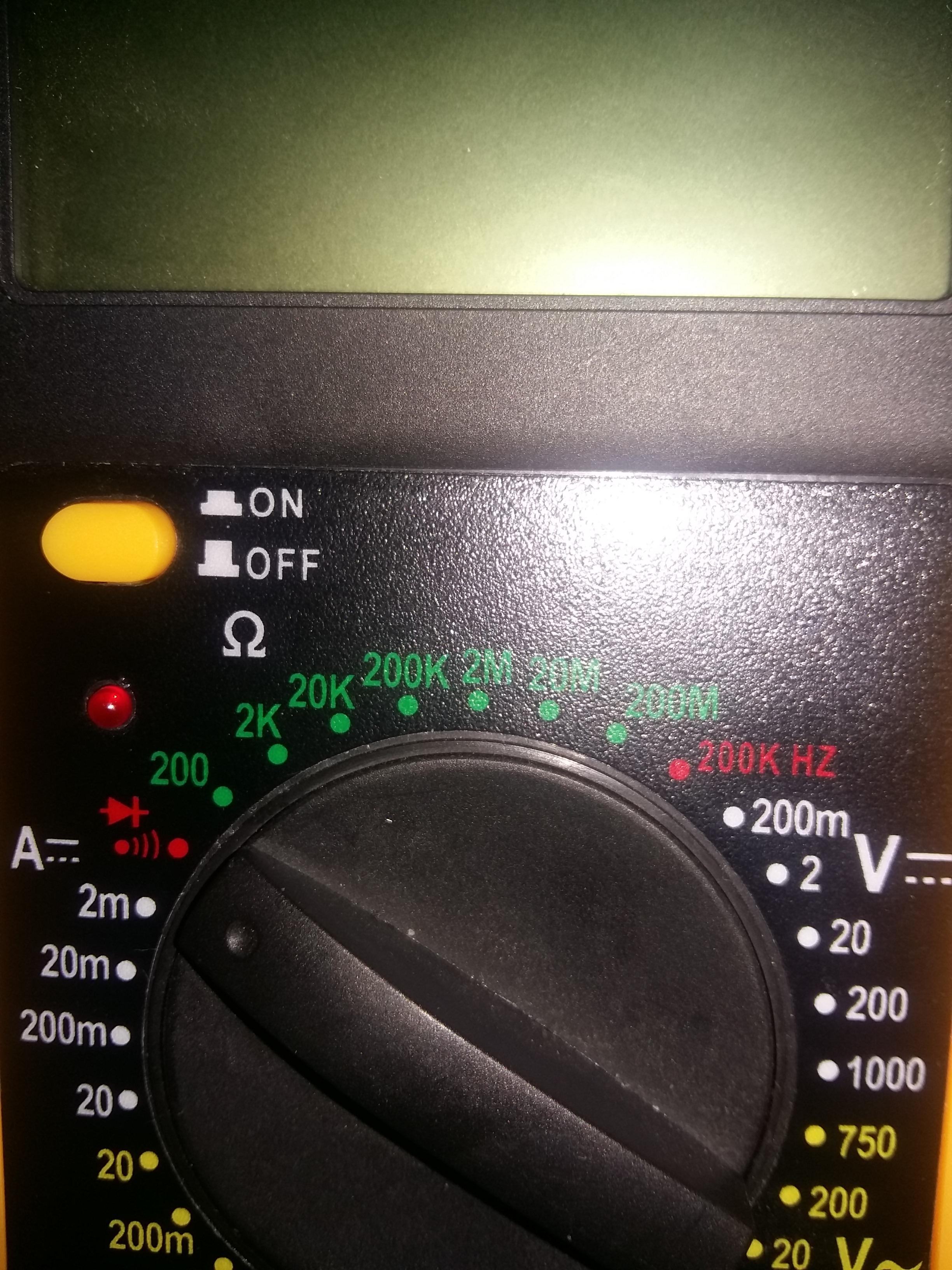

  • #9 17018507
    kaperox16
    Posts: 23
    I checked on this setting (attachment) for the diode test. It squeaks when the circuit is closed. This is also not appropriate?

    #10 17018517
    T5
    Admin of Cars group
    Posts: 12861
    Help: 1004
    Rate: 4182
    No. I still remember how a fellow mechanic in ML replaced parts with a few losing stakes. He came and checked the fuses with a meter. I replaced the burned one and the car started moving :)
    From then on, he checks with a light bulb.
