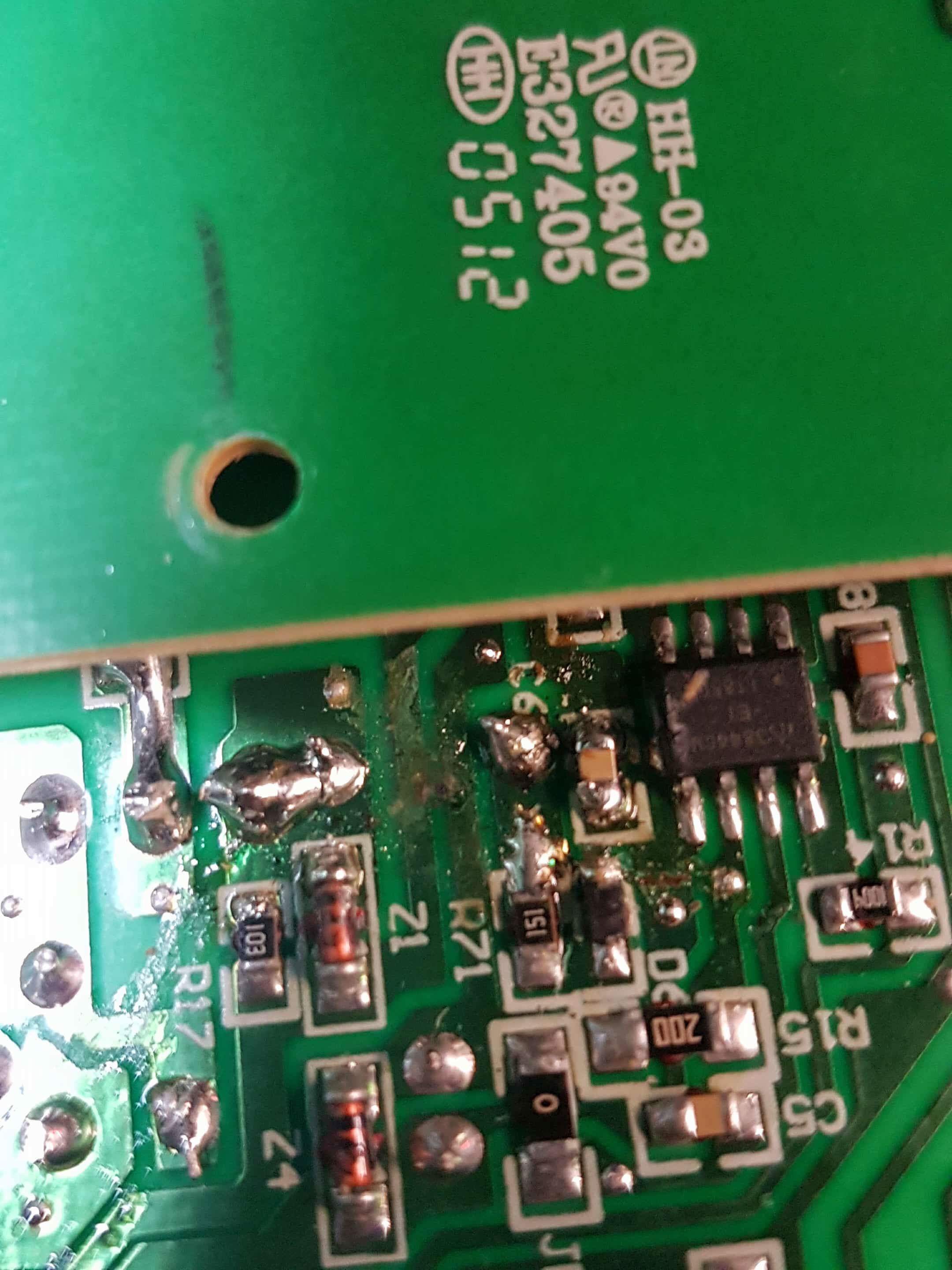

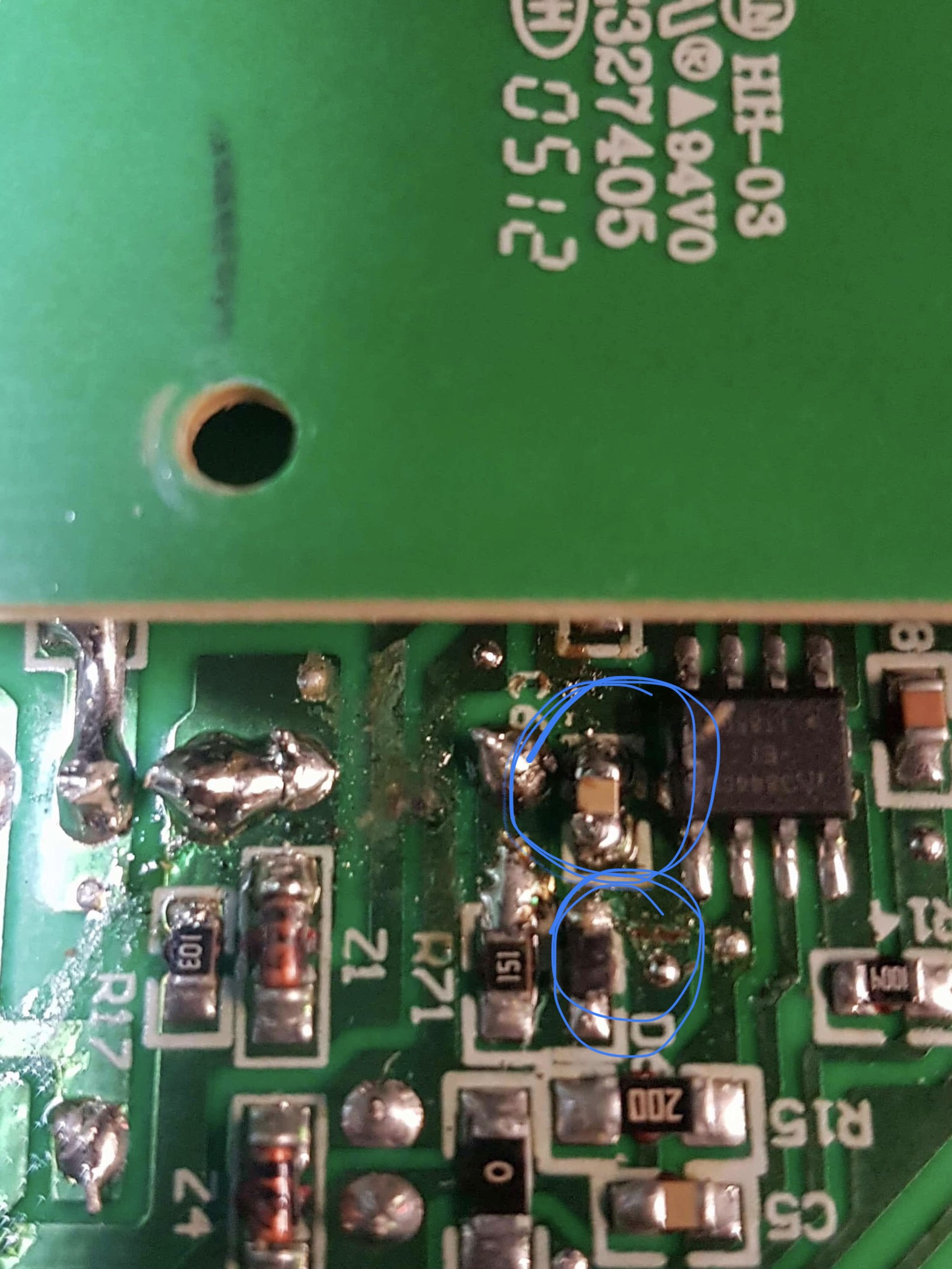

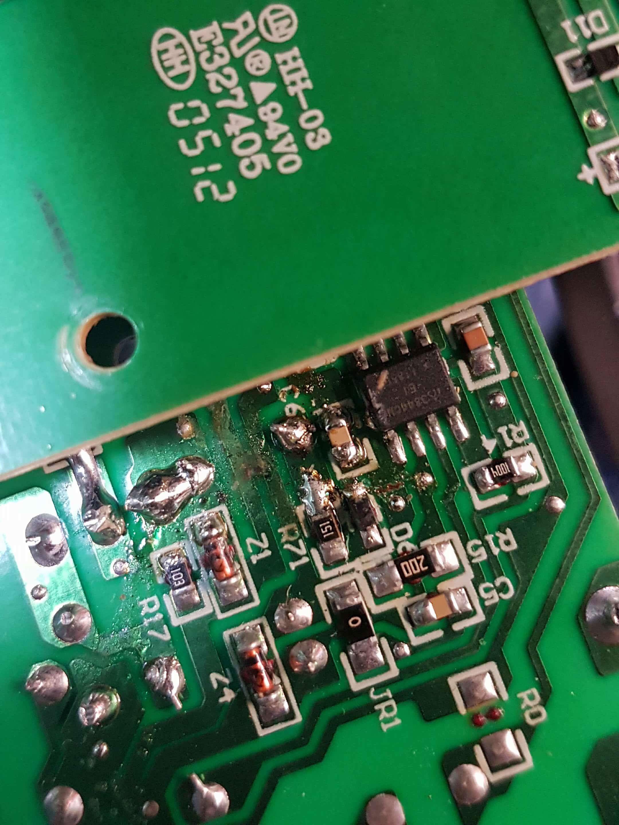

    Hello, I have a bosch c3, as if I bought a new one, I charged it with maybe 5 batteries, but today I wanted to connect and only the blue light on the battery is discharged does not want to detect it. I connected it to a second one in the car and it detected it. It bothered me and I dismantled the rectifier, which turns out a handyman was already sitting with it and did not put other capacitors or anything like that.

    Such chargers do not detect deeply discharged batteries, how much V does he have?

    Most switched-mode rectifiers, if they don't get the right voltage from the battery, won't start charging it, if you've had a heavily or completely discharged battery, it may not have detected you.

    Aku on the meter showed 9.98V so it is possible that the rectifier will not raise it below 10V as it is?
    Exactly.

    Charge it with a normal rectifier and connect to it later.

    In practice, the electronic ones require a voltage from 7 to 10 V at 12 V battery, so it may be.

    I'm digging up a bit. Does anyone know the voltage of the zener diode Z1 visible in these photos? I got a copy and someone put in the usual 1n4148.
