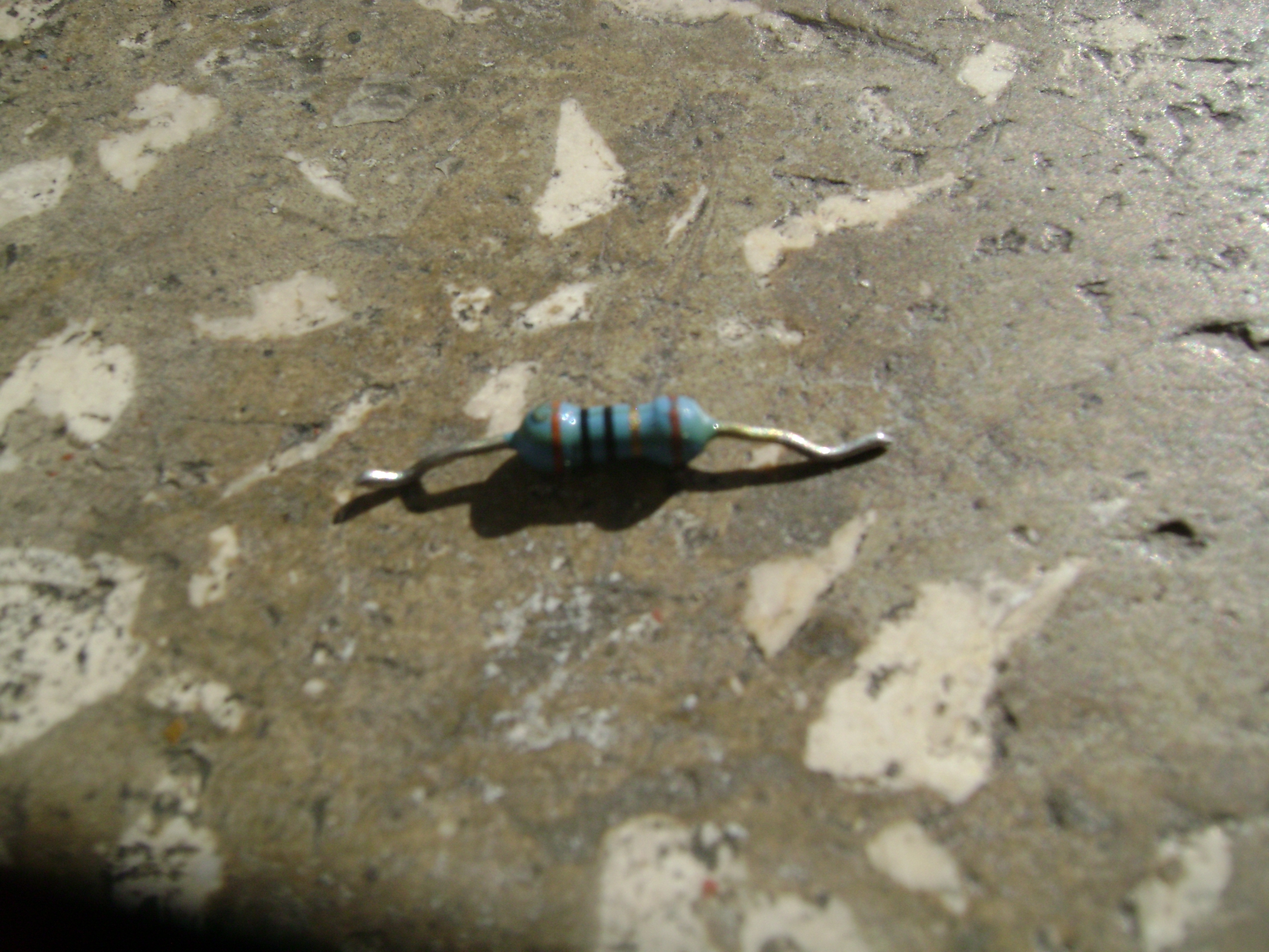

    I desoldered the resistor No. 1 from the photo:
    BOSCH AL 3640 CV - Short circuit after connecting the charger to the power suppl
    Bar code: red, white and the latter, I do not know if yellow or green, if yellow, it should have 290k Ohm, if green is 2.9 Mohm, measure it with a 2M ohm meter and it closes the meter, I do not know how many Ohm it has.
    I desoldered the diode No. 2 and 3 from the photo, they have about 2 k Ohm in one direction, after desoldering these parts, there is still 54 Ohm in the UC3842B power line.
    Without a fuse, I only connected 1 time at the very beginning.

    I desoldered UC3842B and there is already high resistance on the power line of this IC. There is a resistance of 54 Ohm on the power supply legs of the IC, does that mean that the UC3842B needs to be replaced? How can it be instead of its UC3845 or some other replacement because I do not know if they will have such a part in my electronics store.

    As for the resistor, it should probably have 290, at least this is the result of the datasheet of this scalak, as for the scaler, it is certainly to be replaced with the same, it is said that it can be replaced with UC3843, but I only read it and never did it, let my colleague measure it other resistors because they can also be damaged and replace the UC chip.
  • #19 13551048

    I already have a new chip, but I don't know what to do with this resistor.
  • #20 13551299
    cezarjak
    Level 19  
    Posts: 206
    Help: 34
    Rate: 25
    It can be soldered at most, the system will not start because it is a starting resistor.

    I put in this old resistor and the UC3842B power supply was 1V and I changed it to 390 Ohm (I did not have 280 ohms) and the power supply was 15V but the diode does not light in the charger and after inserting the battery it also does not work.

    I don't know the starting resistor anymore:
    It is next to the 10k Ohm resistor which has stripes: brown, black, black, red, bronze
    and the latter brown strip looks almost identical to the first strip of the starting resistor, while the third strip of the starting resistor looks green. So either 190k Ohm or 1.9M Ohm?
    The second resistor goes from the transistor's gate to the leg output UC3842B:
    It lies next to the resistor which has a value of 1.37k ohms and has stripes: Brown, orange, purple brown, green, the second strip, i.e. orange, is almost identical to the first strip of the resistor that goes to the gate of the transistor.
    Is it really 10 Ohm and not 30 Ohm?
