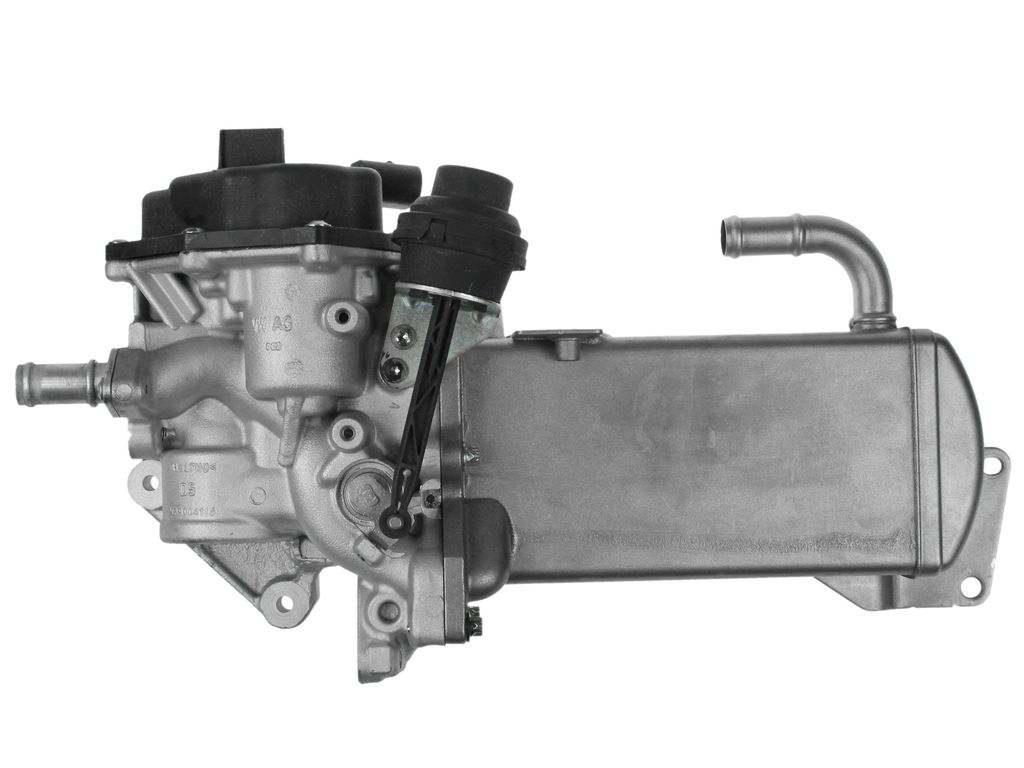

    Check the egr I had a sealed cord, which is pushed by such a rubber pear to which the tube goes from the top. The CCioner moves a flap that flows exhaust gas into one or the other channel. Now the car heats up very well and the valve is back in its original place. The fact that it loses temperature after a stop is a normal phenomenon, unless you take a longer piece as furious, then the engine with oil heats up more and gives off heat for a longer time.
    This is the element pushed below by a plastic link made of a rubber bulb at the top.

    It was not needed .... It is a shame that even ASO or other mechanics do not know about it, but just need to look for yourself. I will tell you that in the previous configuration, however, the downhill was a bit more agile, because the egr would not work, but the engine heating was worse in winter. Who likes what, I have to hide the car a second time out of curiosity to see what I will show.

    How did you start this stuck cable?

    I did it on Tunap 133 but I think some kind of damper cleaner or wd40. I wanted to unscrew the 3 screws on the other side of the string because there is the other side of the shaft, but I did not manage to detach this small lid after unscrewing the screws. Unfortunately, you have to play with it for an hour to get it started. Only when it starts to bounce, it means that it is good, i.e. the spring bounces inside.

    But he will kill himself with carbon deposits again. Only replacing the EGR will do the trick

    He will probably kill himself as it happens in diesel.
    Unless I am doing the car route and it is burned out, it should last longer.
    When it comes to cleaning such lubricant residues, a chimney cleaner is a good and cheap option.
    However, with this egr, did you clean it inside or outside?

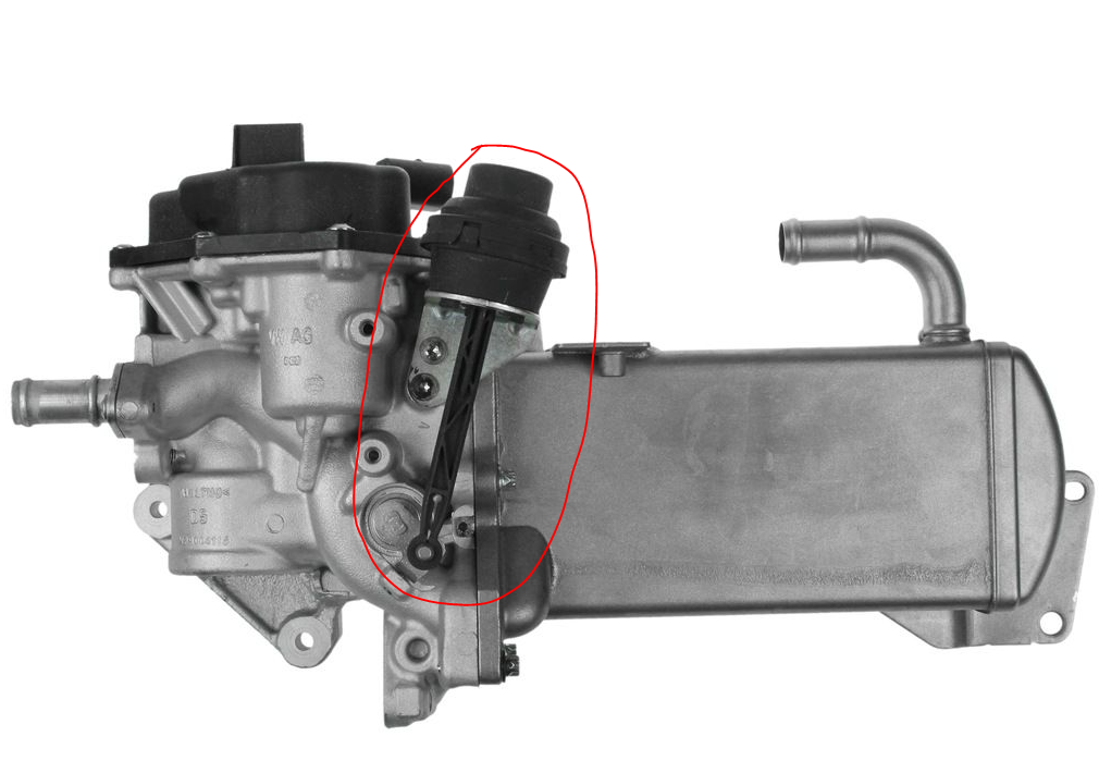

    You mean the item I marked
    2.0 TDI CR CJCA A4 B8 - The engine does not maintain the temperature of 90 * C

    This is how the selected item is concerned. I separated the egr from the radiator and opened the flap. I did not clean it completely because mine was in good condition and there was no need to clean it.
