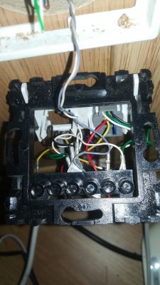

    Probably someone during cleaning got stuck harder on the can with telephone sockets on the wall and stopped flashing Orange DSL Internet. The problem only occurs in this can, because in a nest in another room is ok.
    Generally, there are two sockets in a can, but I want at least one to work, because only one has ever worked.

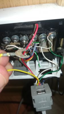

    Four cables come out of the socket:
    - yellow
    - red
    - white
    - green
    Title: Troubleshooting DSL Connection Issues: Damaged Telephone Socket, Cable Colors & Wiring
    There are 6 screws on the top of the can:
    counting from the left:
    - yellow cable is not connected anywhere (probably culprit)
    - red goes to screw number 4
    - white to screw No. 5
    - green to screw No. 6

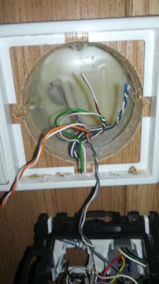

    gray and white cables are connected from the wall:
    - gray to screw No. 4 (together with red)
    - white to screw No. 6 (together with green)
    All that remains in the wall looks like this:
    Could anyone help how to connect it to get it working again?

    Try to open a working can and then compare how it is connected there, then you will do the same in what does not work.
    - yellow
    - red
    - white
    - green
    Red and green are the right pair. The middle two pins in the socket. A meter could be used. On the ADSL pair entering the house there is usually a constant (DC) voltage - tens of volts needed for a possible telephone. It would help.

    There are so-called phones system, secretary-director, etc. using 4 wires, and this is a telephone socket. A regular telephone and ADSL modem work on two middle pins.

    Same as above. In fact, it looks like it's well connected.
    It would be useful to check where the cable is separated into cables for individual rooms.

  • #9 17034683
    LucekB
    Posts: 995
    Help: 143
    Rate: 137
    From the photo you can see that the signal comes in white-gray pair. connect this pair into a socket with green and red veins (middle pins).
    After connecting the modem should speed.

  • #11 17035699
    jprzedworski
    Posts: 5373
    Help: 758
    Rate: 828
    sylweksylwina wrote:
    That's how it's connected.
    Well, it looks like something previously damaged. As I mentioned, a meter would be useful. Not the colors are conductive, but the copper wires. If someone broke, we will not solve the pictures.
