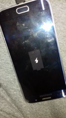

    I have a problem charging my phone. The phone does not charge, not even looking for a device on a laptop. I connected 3 other cables for the Samsung charger adapter and nothing else. I also tried to emphasize with a cable and when I turned on the landing, it turned out and after a second it went out. The phone was not flooded or after any accident. I cleaned the usb socket with compressed air also did not give anything. How do you think it could be a charging slot or something else?
    Added after 3 [minutes]:
    I will add to this that when I turn off the phone and connect the charger shows charging and after a while it will go out ... In addition, it shows 17% of battery and goes out

    Damaged battery charging controller.

    Check on your phone what voltage is on the contacts after connecting the charger. The battery, USB socket or the charging system itself may be damaged in the phone.

    At 10% it shows me 3.650V when the battery is discharged.

    You need to replace the bottom tape with the socket. A subject known to me. However, to do this you need to pull the LCD.

    This morning I met with an identical-looking problem as in the picture.
    At my beginning, I cleaned all contacts using a thin needle and spraying them with perfumes (you can use another alcohol), then after connecting to the charger as the battery showed up, I pressed the buttons to restart it and after that it started to charge normally. Evidence of this is the glowing red LED from charging.
    The reset buttons are:
    - on and off button
    - button for broadcasting
    they should be pressed simultaneously and held for a few seconds.
    I hope that you will need such a simple treatment.
