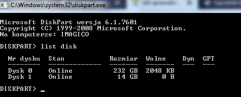

    There is a chance that the bios will not read the GPT partition, which makes the drive invisible. If there is an MBR then you will have to look from another side.

    Where should I look if I have an MBR or GPT partition? What do these shortcuts mean?

    In the link that I gave you can check whether and what type of partition is created. If it is GPT it may not be compatible with the BIOS, which will not be visible.
    So according to your link I have the MBR as I expected.
    Connecting Samsung Pro 256GB SSD & HD253GI HDD to GIGABYTE GA-G41MT-ES2L with Limited PSU Sockets
    What does it mean? Good or bad?
