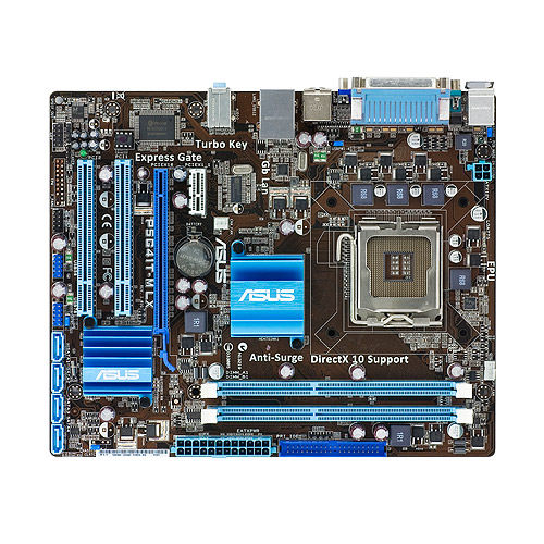

    Hello everyone.
    I decided to speed up my old computer and bought a ssd for it. System installed, everything works fine. I also decided to connect the old hard drive (seagate 250G) and this is where the problems begin. After booting, the computer freezes at the asus splash window and hangs like that.
    After entering the bios in the boot tab, there is no longer a ssd, there was, of course, previously, there is only a hard drive with no name and a cd-rom.
    After disconnecting the old disk, the computer starts normally and there is a ssd in the BIOS.
    Where is the problem and how to fix it?
    -system windows 7 32bit
    -asus P5G41T-M LX board
    -4GB memory
    - GeForce GT200 128bit 1GB graphics card
    Thanks in advance for your help.

    Recently I have been working on exactly the same situation with the Asus board (model P5KPL-AM).
    When both drives were connected, there was no way to force boot from SSD.
    Changing SATA ports, replacing SATA cables, nothing worked.
    After disconnecting the HDD, it starts up without any problem.
    Unfortunately, it ended up transferring all data to SSD from HDD.

    These boards had problems handling disks, and boards with the G41 and 43 chipsets - often with memory support as well. While the DDR3 support was a broader problem that also affected other manufacturers, I am inclined to blame everything else for Asus BIOS. The update / version change usually did not solve any problems. Another thing is the quality of laminates and soldering joints. Asus already often had faults consisting in unstable operation, which very often, after being sent back for warranty, resulted in the failure to find a fault. I have already encountered problems with recognizing disks and memory support with boards on the i945 and i965 chipsets. In this case, it is even difficult to say whether this type of behavior should be treated as an inefficiency or as an incompatibility of the disc with the basic standards.

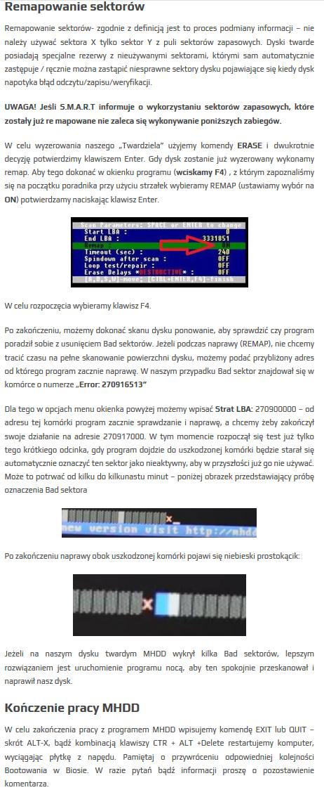

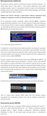

    This you are talking about you have a reading problem. And you can do bad sector remapping as described in MHDD?
    Info. http://www.korepetycjenowysacz.edu.pl/mhdd-diagnostyka-i-naprawa-dysku-twardego/
    How To Remove Bad Sectors?
    If you have any information on the disk and you don't want to lose it, just REMAP
    Remap - a very important option that can be set in two modes On and Off. If Remap is set to Off, we will only test the hard disk and see what condition it is in (if the number of Bad sectors is large, it is not worth repairing such a hard disk, and the repair process itself can be greatly extended). Remember, working on a disk with several or a dozen or so bad sectors is very risky and we should back it up as soon as possible. On the other hand, the On function will try to additionally repair the hard drive. If so far we have not performed the test with the MHDD program, it is worth setting this parameter to OFF, because we want to check the condition of the disk at the beginning, but if there is something wrong with it, we will change the option to ON by making additional changes.

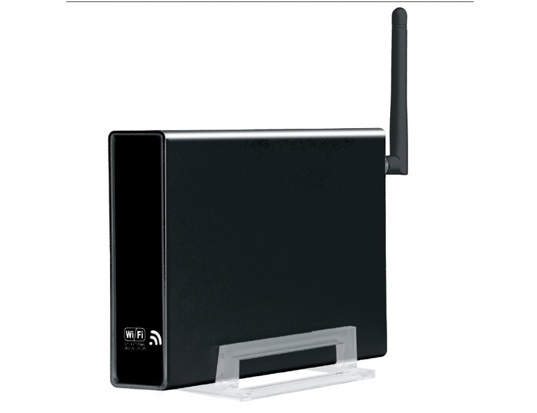

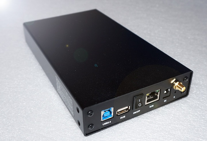

    @ Piotr520
    Maybe a point with a disk and data via WIFI or via a USB cable / RJ-45 port
    HDD enclosure TRACER Wi-Fi / USB 3.0 HDD 2.5 "/3.5" SATA
    Producer: Tracer
    Model: TRAOBD45280
    ASUS P5G41T-M LX: PC Freezes at Splash Window After Connecting Seagate 250G HDD ASUS P5G41T-M LX: PC Freezes at Splash Window After Connecting Seagate 250G HDD
