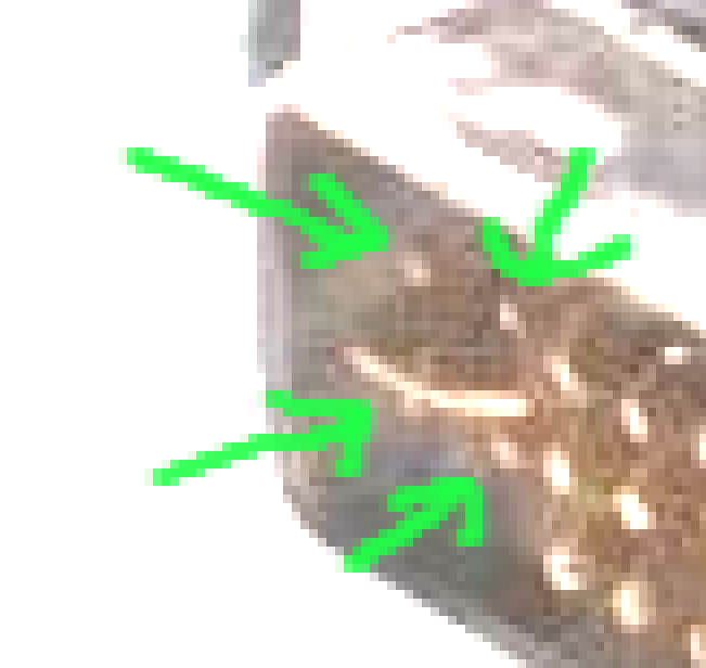

    The media grommet won't work, it won't even go into the DVI-D connector. All in all, you already have one such DVI-I adapter ;)
    After a closer look at the MM vias, boost of brightness and contrast, 4 needles can be seen around the flat pin in the DVI connector. DVI-D has no place for these pins.

    No, it only looks similar at most. If it works with DVI-D then it must have electronics converting the digital signal to analog.
