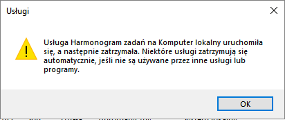

    Hello, for some time I have a problem with the task schedule in win 10. When enabling the task schedule, I get an error message (screenshot 1). And when the "task schedule" service is started, a message appears (screenshot 2)
    Windows 10 Task Scheduler Not Working: Errors & Service Issues (Screenshots Included) Windows 10 Task Scheduler Not Working: Errors & Service Issues (Screenshots Included)
    I will be grateful for any help.

    Unfortunately, this method did not fix the problem
  • #4 17088393
    user3381
