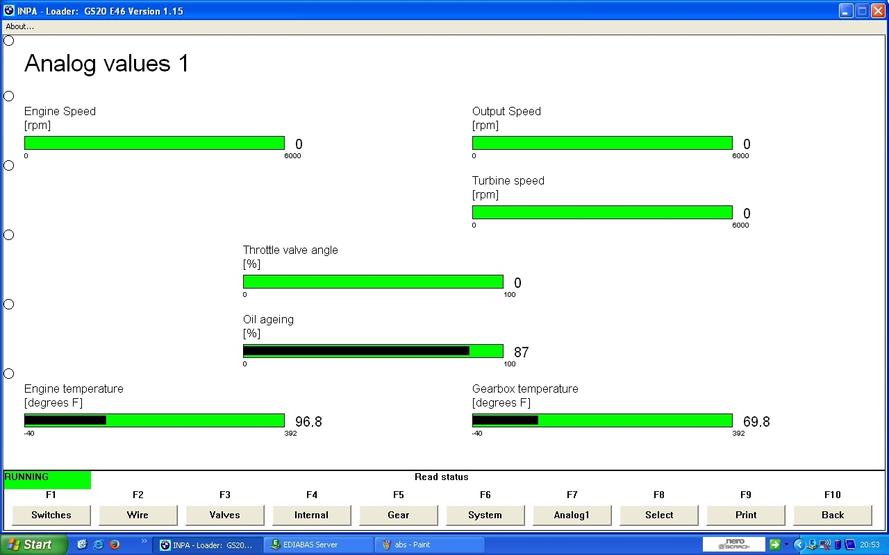

    I have one more question for you. INPA shows me such a gearbox parameter as "Oil Age" and I have 83%. And I don't know if more is better or less is better?

    I have such an indicator in the '' analog '' tab and it's called OIL AGEING and it shows 83%. I'll throw a screen, maybe tomorrow it will work.

    Spring came, I decided to clean up the ABS. The replacement of the right front sensor and the improvement of the contacts in the right rear caused that for several days not a single ABS error and not a single transmission error. Thanks very much to romuald-f for pointing you to the right path.
    Regarding the "age of oil" I am throwing a screen (87%, not 83% as I wrote):
