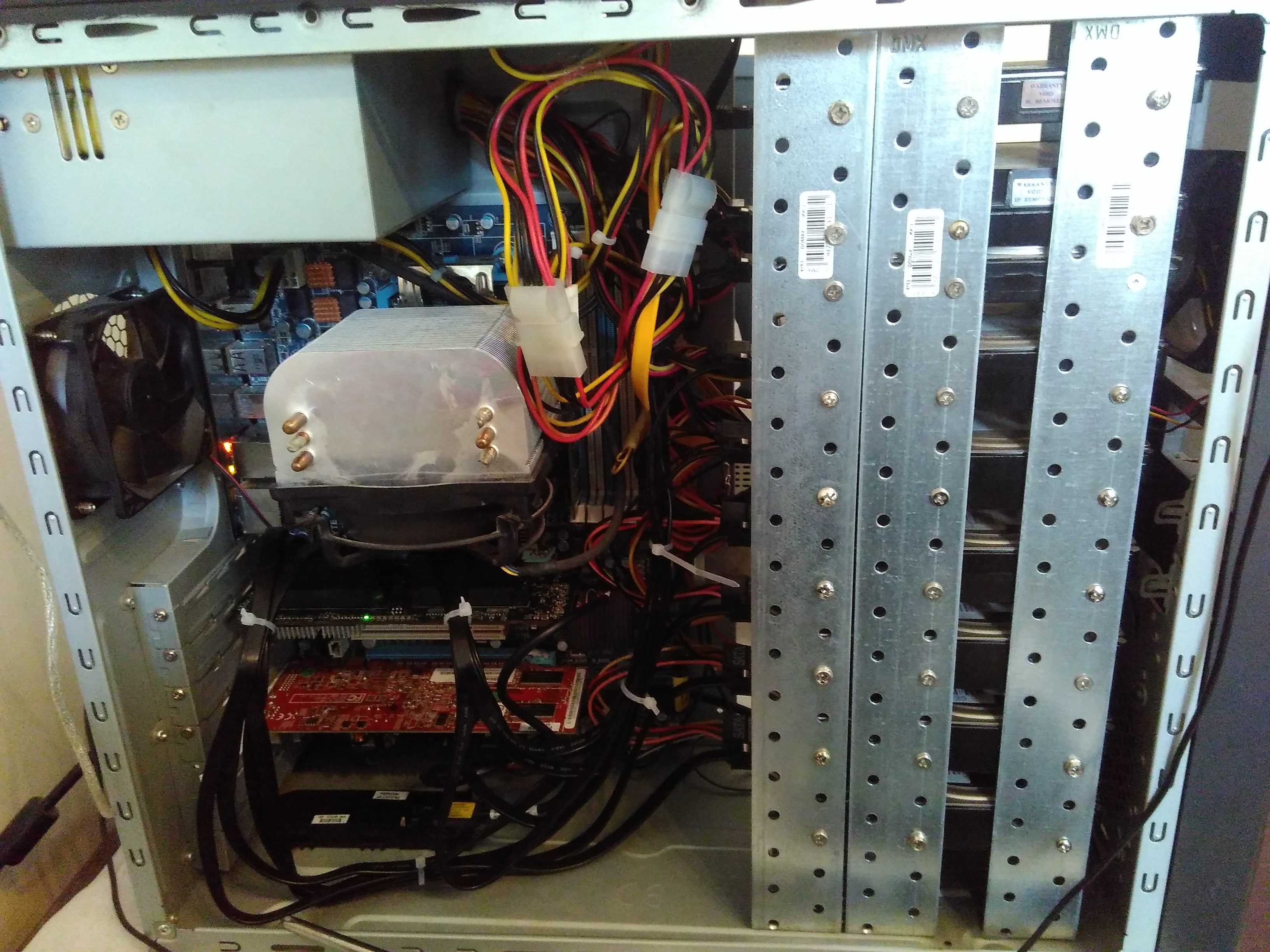

    Mine is an Athlon II X2 250 foldable, but it has an HP P400 server RAID card.
    Debian stands on it.
    Mixing Different HDD Brands in RAID6 for Reliability: Pros and Cons?
    Previously, I used a more energy-efficient i3 550, but the board did not like the RAID card (it freezes when loading the RAID card BIOS).
    At the beginning I had two disks that were damaged out of nowhere.
    One dropped reallocated after undergoing a full surface scan at MHDD.
    7 hours for a 2TB drive, so it took me two days to check the whole thing.
    Then RMA two disks. One dead (bad sectors immediately after booting) and the other reallocated.
    I have a 3-year warranty on them, so I use them.
    Many people with such arrays first perform long-term tests before connecting them to a computer. Pads will usually immediately throw away the reallocated sectors.
    This is a method of screening out the weakest links.
