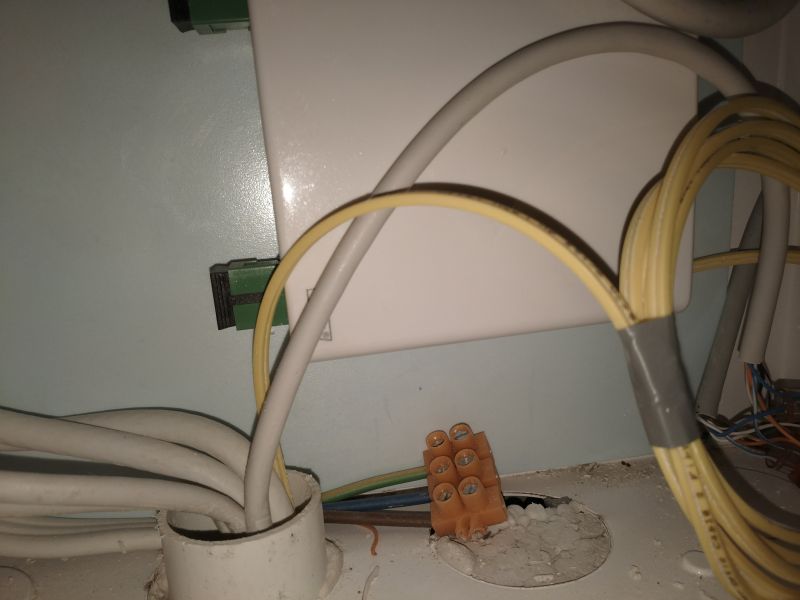

    I bought a flat from the developer. I have 3 ethernet sockets in the apartment and outside the apartment - in the staircase - I have a teletechnical box in which there are 5 ethernet sockets, fiber optics, concentrators for TV / SAT. I would like to make a LAN in the flat and I have a problem how to do it.
    Is it normal to install the router in a staircase so that I have a network in every outlet in the apartment? I do not know what the practices are because I encountered something like this for the first time.
    Is it better not to give anything to this box and instead establish a point in the apartment, which will be the focal point, release WAN from it to the box and then put the router in the apartment at this point and pull cables to all rooms from it?
    Below photos of this mailbox:
    Setting Up LAN in New Apartment: Router Placement and Ethernet Socket Utilization

    Is this mailbox publicly available or locked? Do you have internet or will you have through this fiber ???
  • #3 17105410
    maczkus
    Posts: 9
    Rate: 7
    Lockable box. Each flat has its own inbox. As for the net, I don't know yet how it will be connected because there is currently no supplier in the building.
  • #4 17105429
    jimasek
    Posts: 35287
    Help: 3783
    Rate: 2681
    As closed it is not a problem you can configure in different ways.
    By buying, for example, the Internet from an LTE provider, you mount your router on your switch cage and you have access to the Internet in all outlets in the apartment.
    By buying the internet from this fiber optic provider, mounting the modem / router in the box on the cage and you continue to separate the internet with a switch on the sockets. In the apartment, you can connect an additional wireless router to one of the sockets to have a good wireless coverage in the apartment.

    It depends how the supplier and what he gives out to customers. You often get a modem with a wireless router but you can also get an ONT or fiber optic module where you must use your router with a WAN port. With this cable / network configuration, you can always come up with something you just have to decide on a specific Internet provider.
