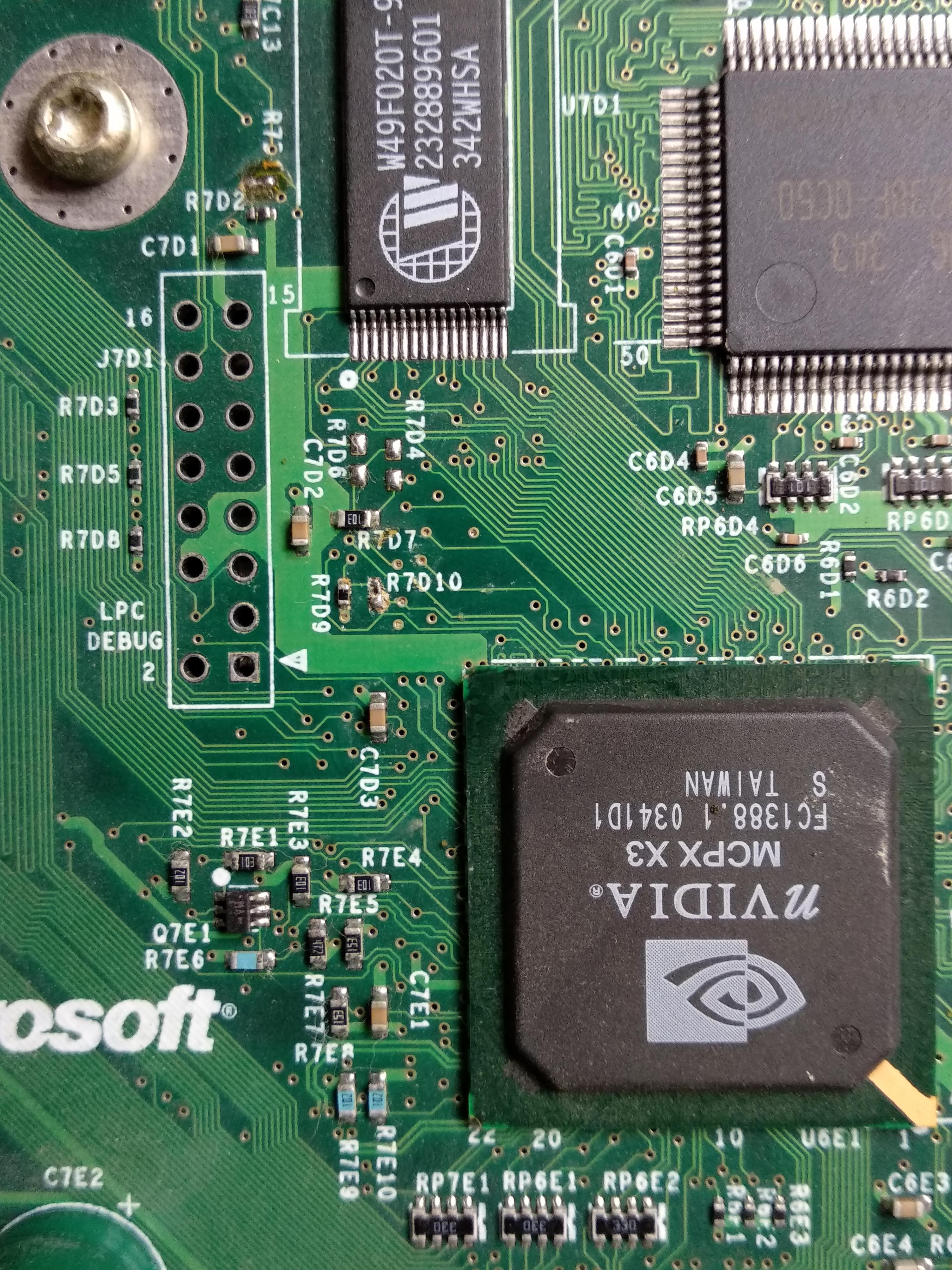

    I recently bought an old Xbox 1 console. The console worked but was very loud. After a few days, it stopped working and now, after switching on, the orange and green LEDs flash alternately, and after a while only the red LED flashes and the console does not start. There is no picture. The console was modified once, but I don't know how, because I already bought one. I unplugged the drives and it was still the same. PS now the console is not making noise. Maybe it's a hard drive?

    Unplugging the drives gives nothing because without them the green and red LEDs continue to flash. Can I give an IDE cable to the disk and drive from my computer? They are the same? The fan works perfectly and is quiet so a loud noise must have been generated by the hard drive and now it may have completely gone. There is no picture, and when you turn on the console, you can only hear a puff in the speakers for a moment. Should the console show any image after unfastening the drives?

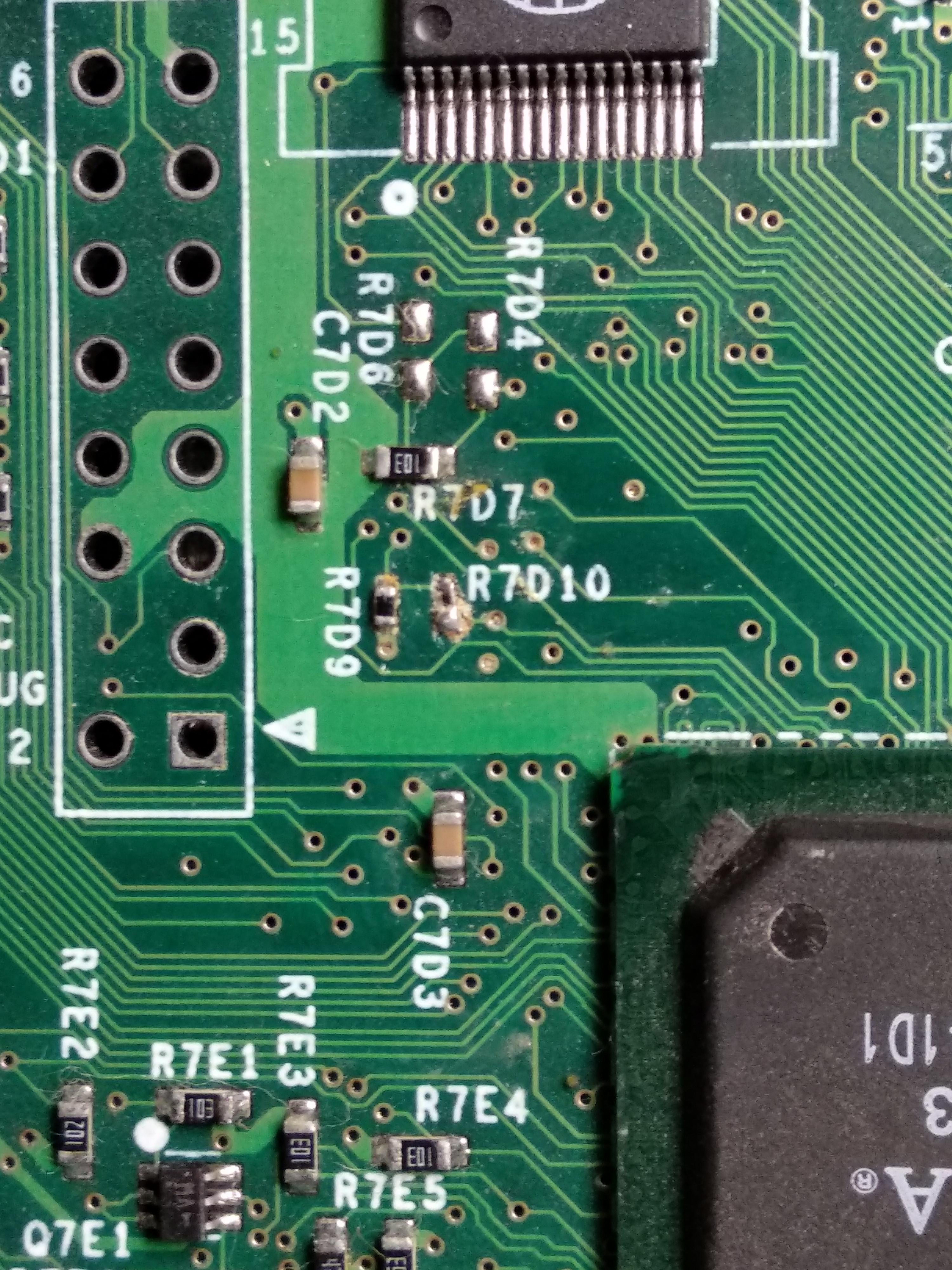

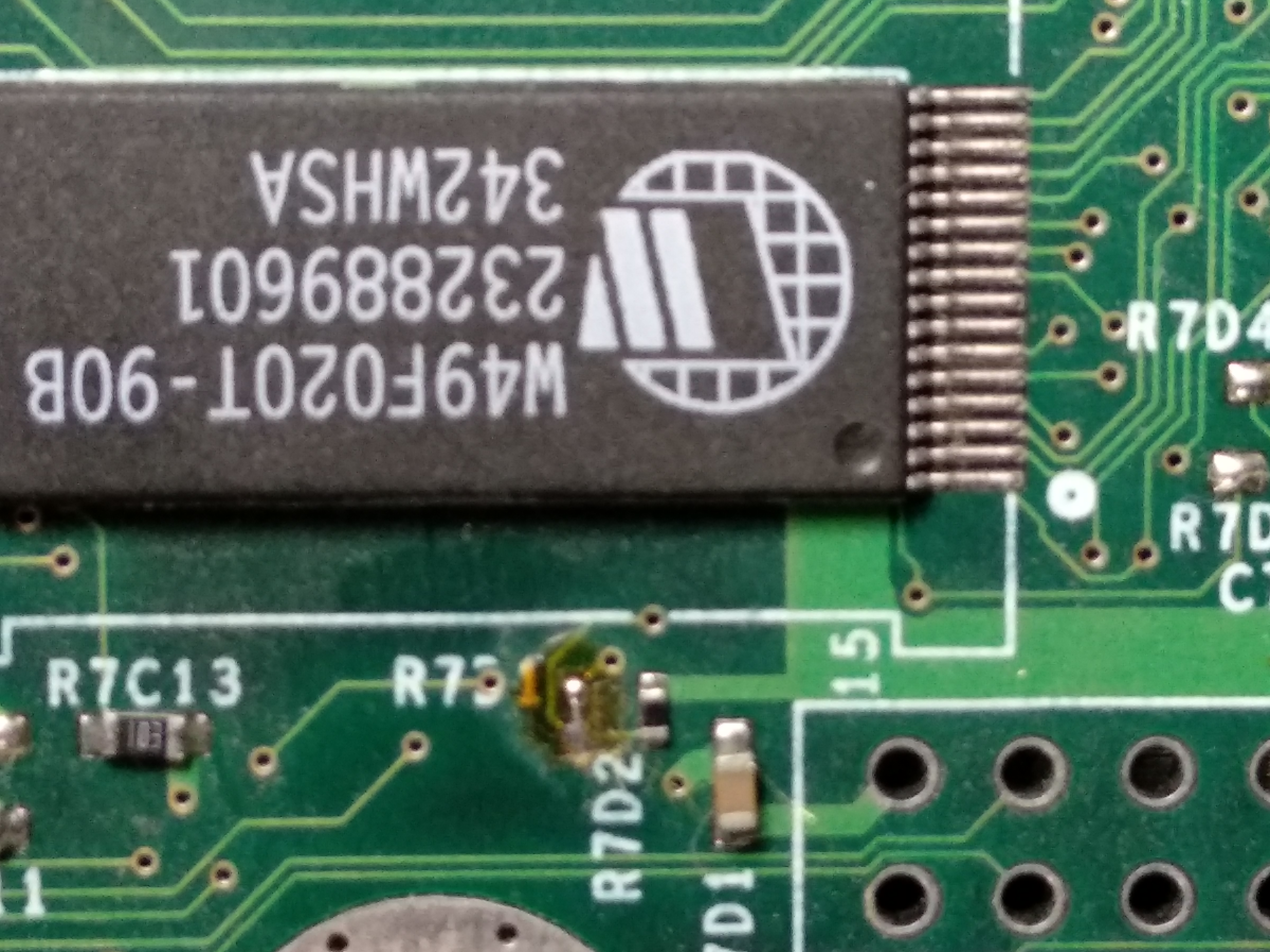

    After examining the motherboard, I found a strange stain like rosin on one of the resistors near the NVIDIA processor. After cleaning it looks quite suspicious. It is a resistor number R7D10. The R7D1 resistor located a bit further is also suspicious. I attach photos of these resistors.
    • Xbox 1 Console Issue: Alternating Orange & Green LEDs, Red Flashing Light, No Picture, Loud Noise IMG_20180320_082113.jpg (1.76 MB) You must be logged in to download this attachment.
    • Xbox 1 Console Issue: Alternating Orange & Green LEDs, Red Flashing Light, No Picture, Loud Noise IMG_20180320_082103.jpg (1.24 MB) You must be logged in to download this attachment.
    • Xbox 1 Console Issue: Alternating Orange & Green LEDs, Red Flashing Light, No Picture, Loud Noise IMG_20180320_082243.jpg (3.11 MB) You must be logged in to download this attachment.

    R7D1 and R7D10 are connected, someone before you was playing in reworking the TSOP, that's why he soldered the points where there were no resistors originally.
    After these points, I also know that you have a motherboard between V1.2 and V1.5 :)

    Eeprom malfunction. The photos you took were TSOP bridges, someone took them poorly. I have for sale working motherboards with a power supply after Tsopa, priv. Best regards.
