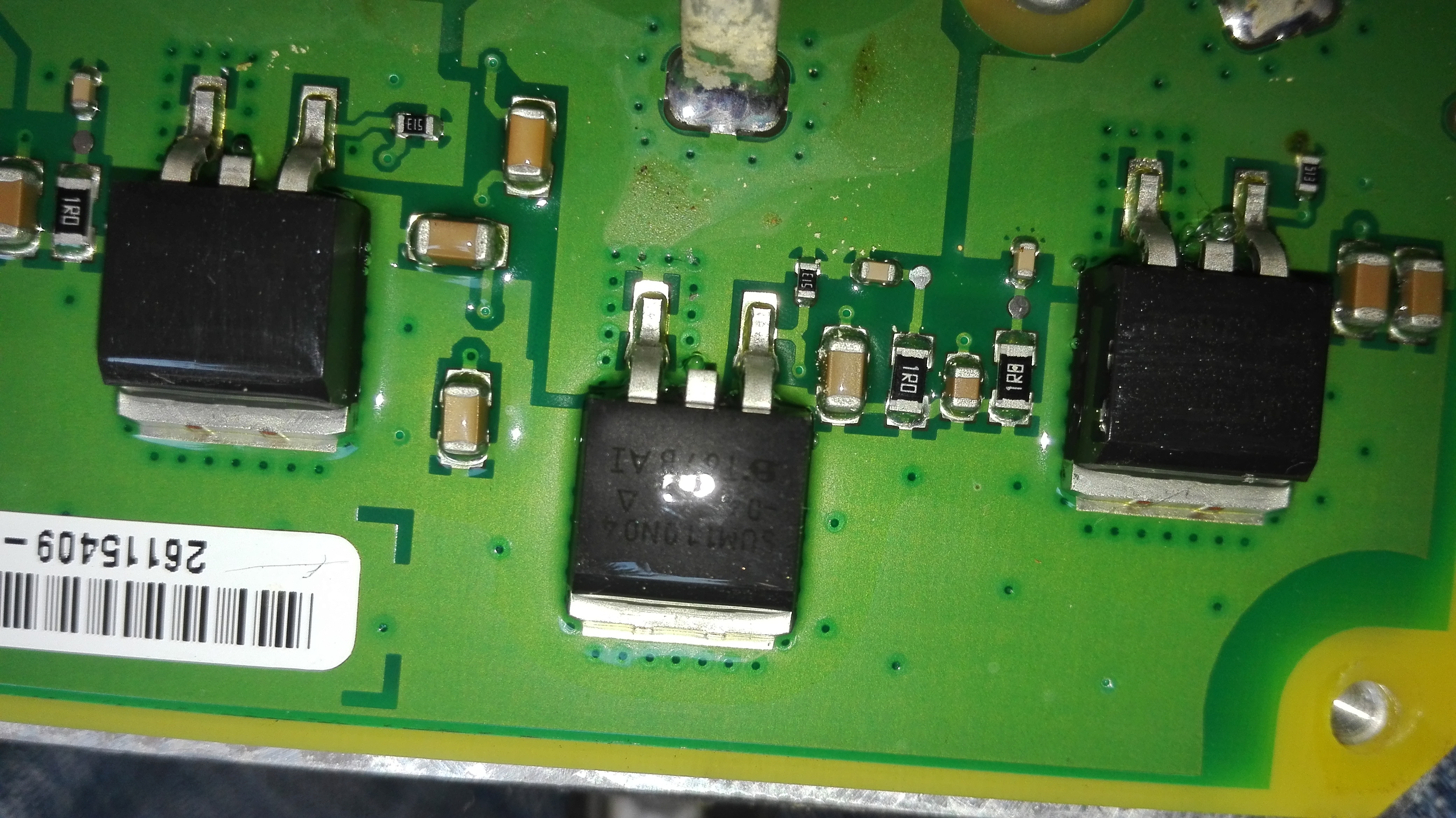

    The case looks like this:
    Car electronics said the eps sensor was OK, suggested a problem with the engine or its control.
    When spinning the steering wheel you can hear a delicate sound as if rubbing metal on metal.
    I undressed eps and I was wondering if there were no control mosfets, probably engine speeds.

    A basic note to your electronics. EPS (just like the whole car) is diagnosed with a tester by reading error codes. I would suggest doing this instead of divination with ... This crackling in your Corsa may be due to a malfunction of the Angle / Torque Sensor causing jerking of the rotation motor Sometimes the whole body can shake. Tester. Errors. Diagnosis.

    The electronics technician diagnosed the power steering error using the TECH 2 tool. The new programming of the swivel sensor does not help. The steering wheel does not harden while driving. The sensor readings are correct.

    Tech is a factory tester. No error codes? To check the parameters during operation.

    Support replaced with a stimulant (functional from another Corsa).
    Works without turning sensor calibration.
