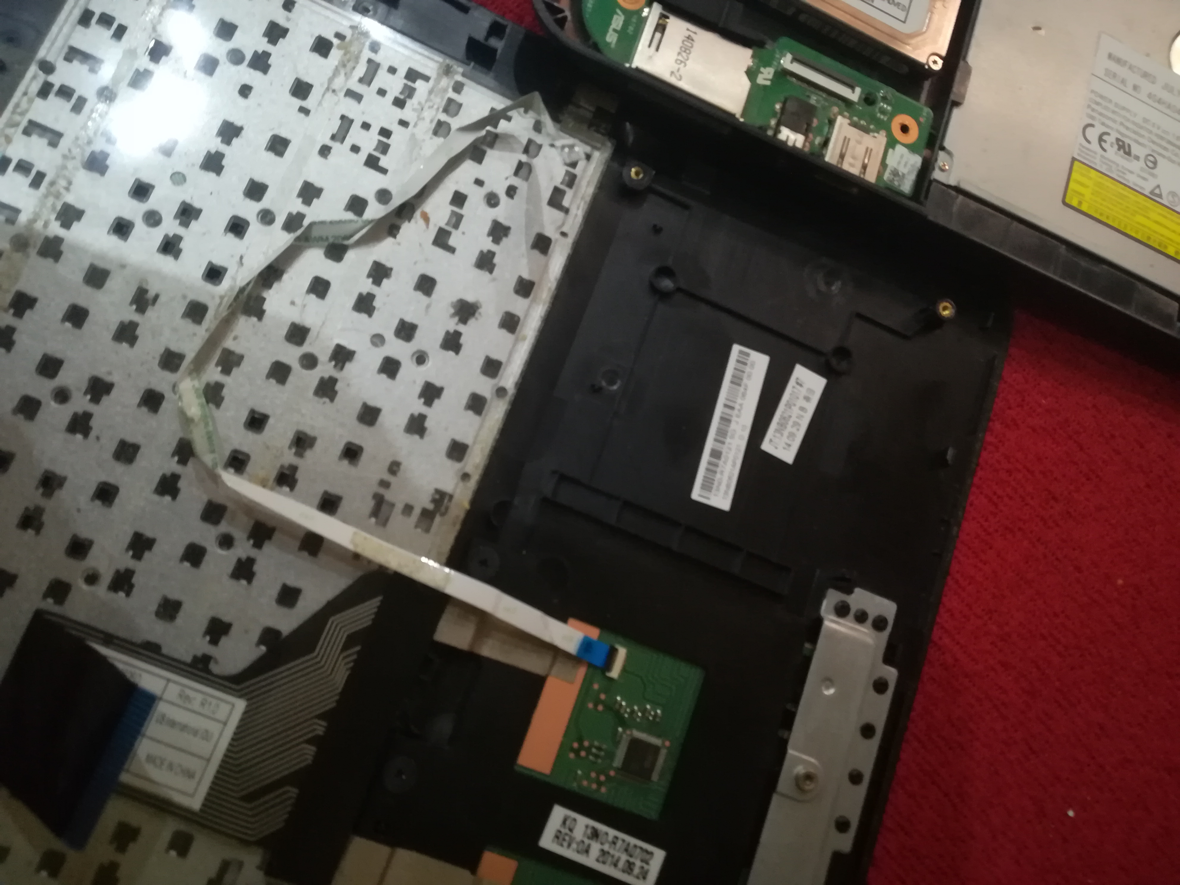

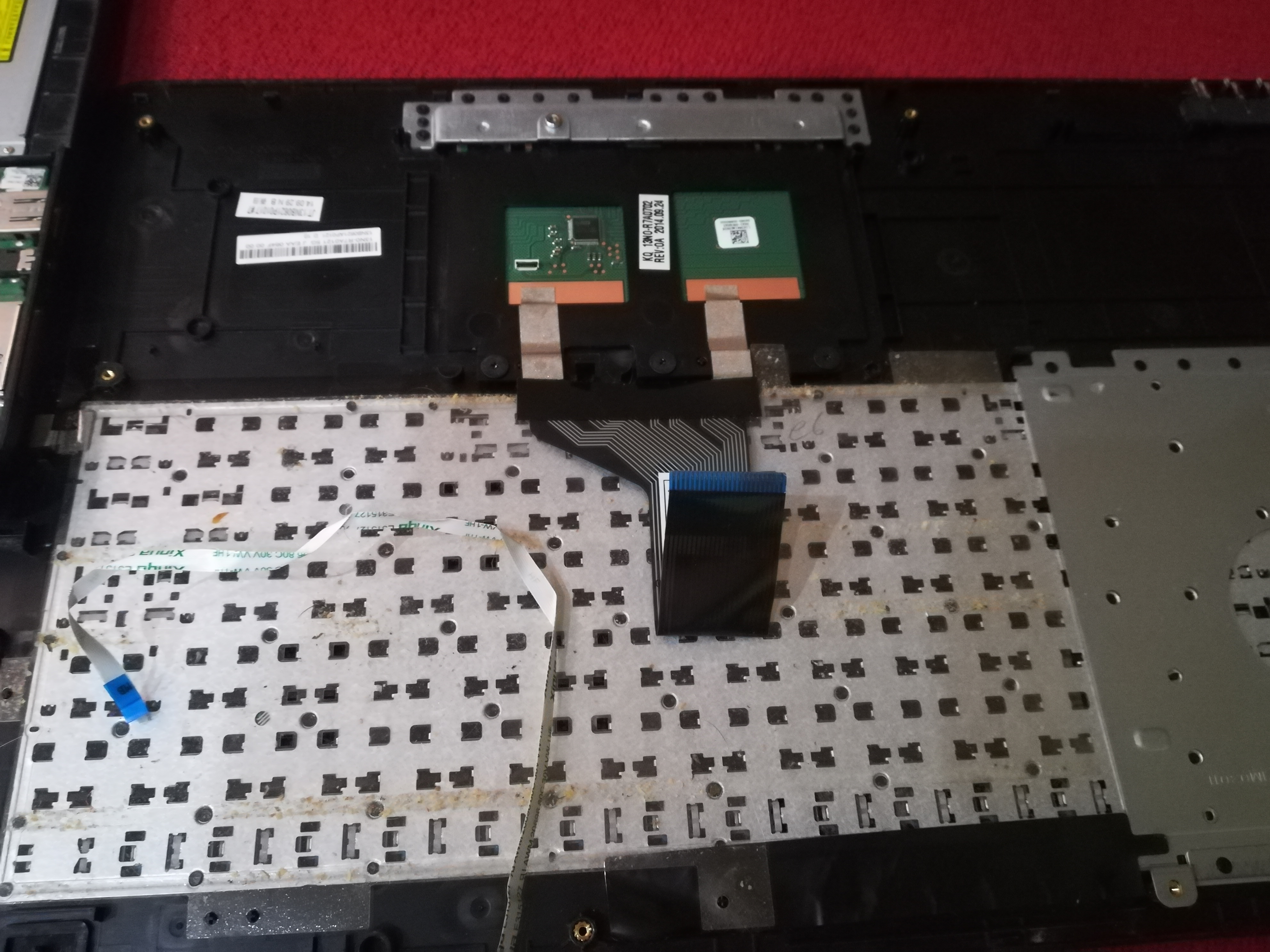

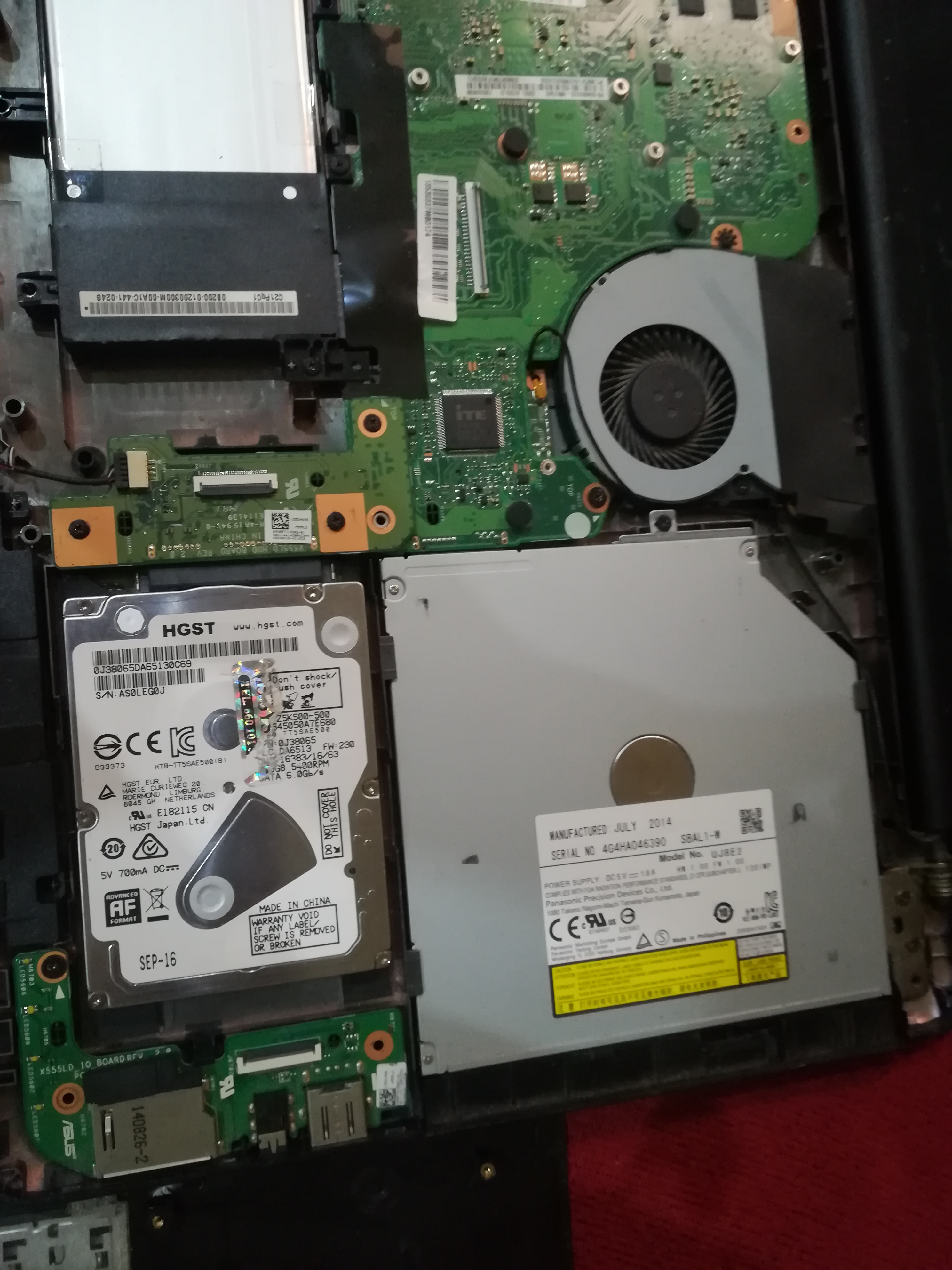

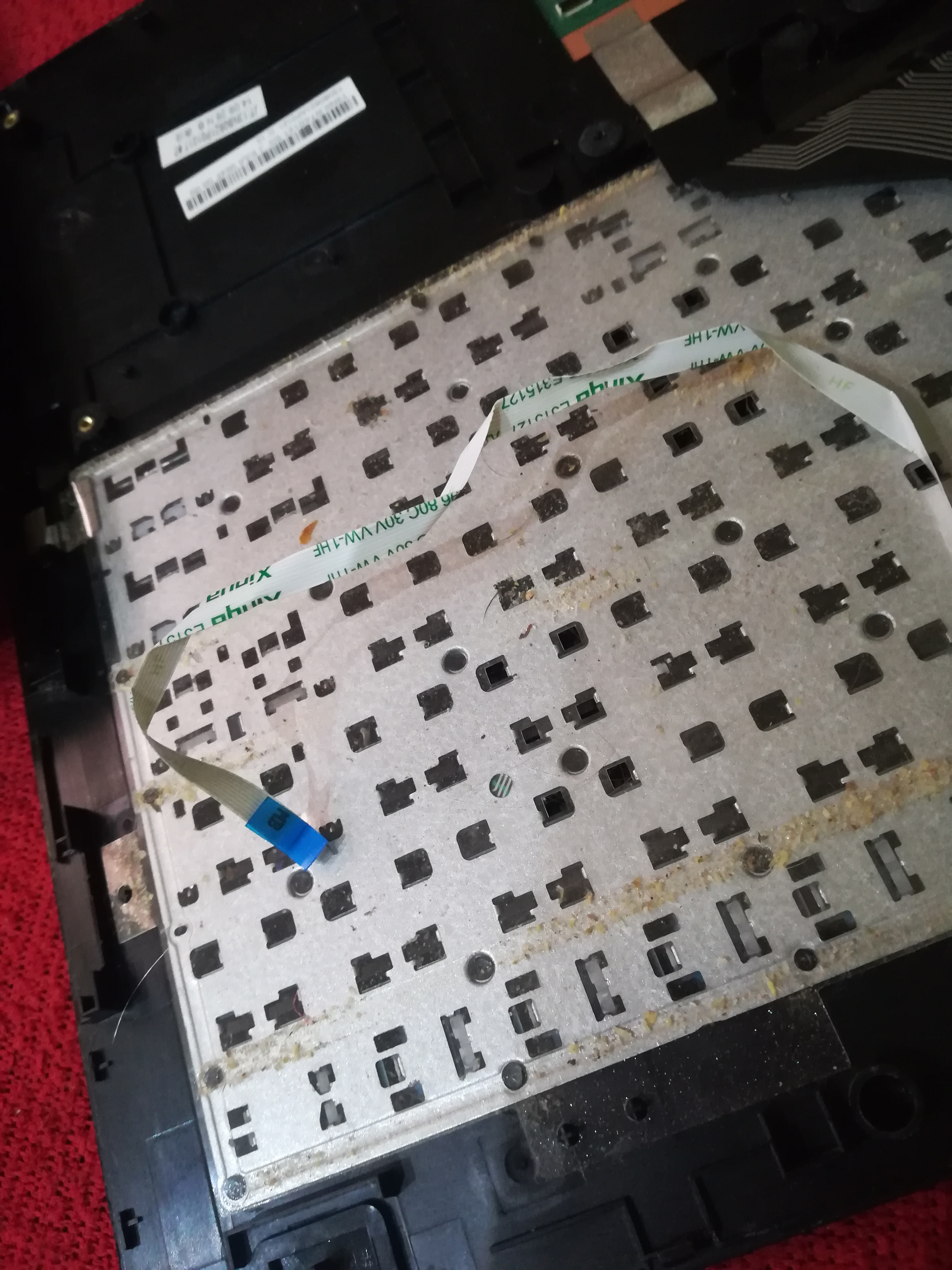

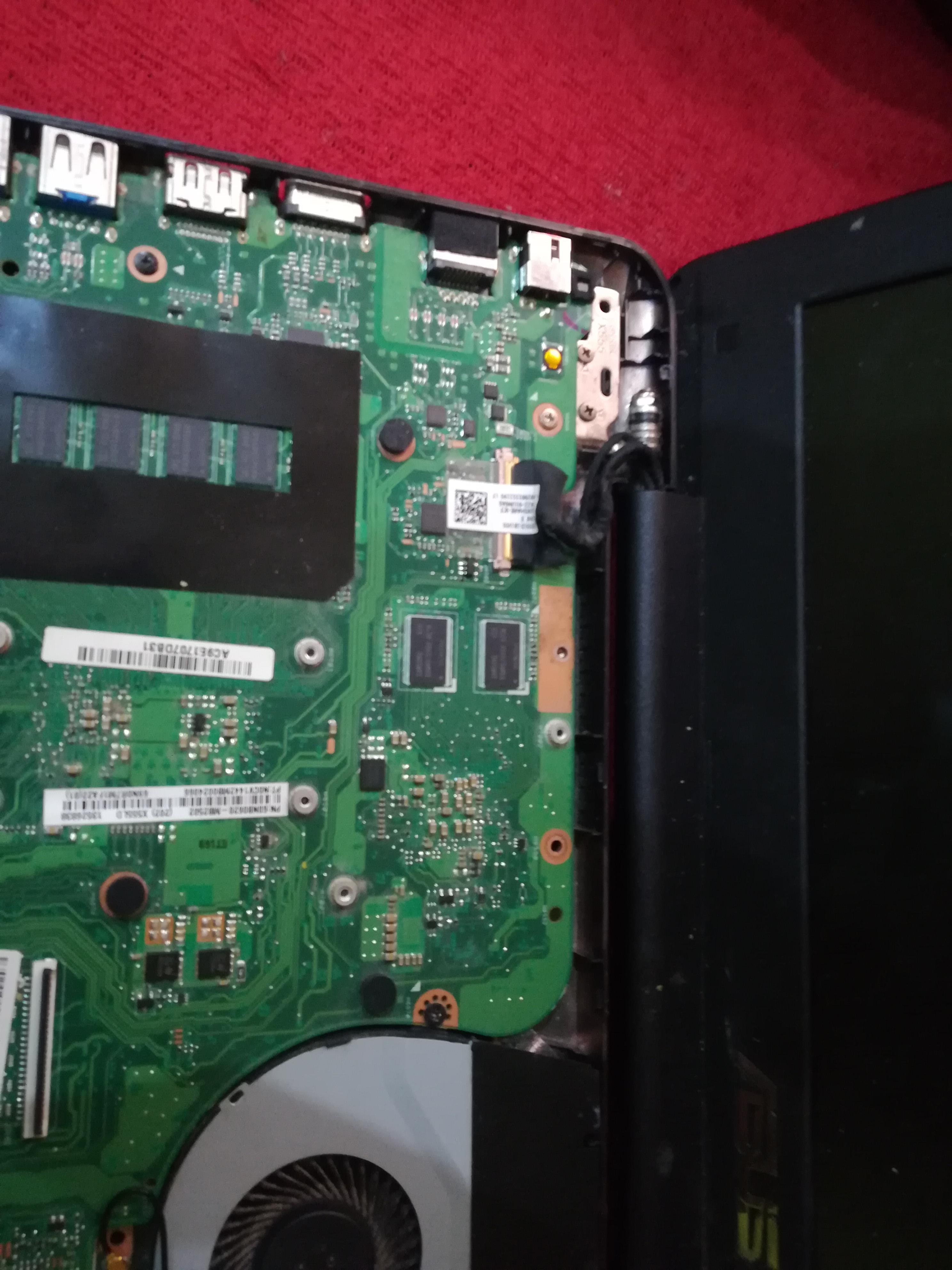

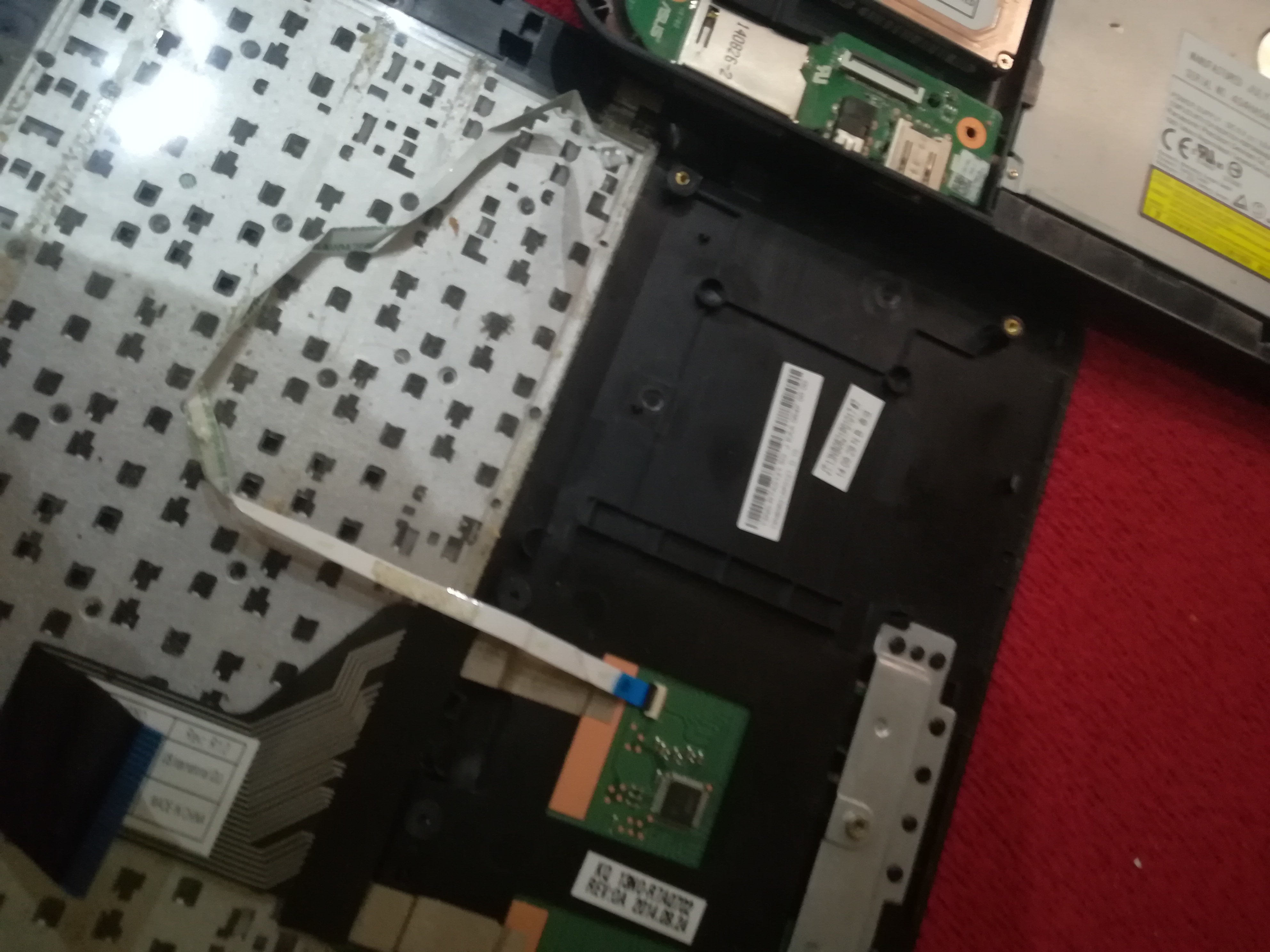

    in fact it damaged the tape which i don't have anymore, and i will give a picture of the inside
    Added after 6 [minutes]:
    here are pictures of the computer from the inside there should be a burned tape on the disc

  • #12 17133036
    michal1250
    Posts: 37
    Rate: 9
    maybe the component responsible for turning on the system is defective, after all, if the graphics were defective, the screen would already be on, and only after some time the computer turns on

    1.
    michal1250 wrote:
    this is already happening for a year or more
    2.
    michal1250 wrote:
    And sometime when I connected the charger, the smoke flew from the laptop and the ribbon burned out.
    The cause-and-effect relationship can be seen with the naked eye.
    First of all, the ribbon did not burn directly, because only the "signal" current flows on these ribbons and no supply voltage or current is connected there. The ribbon burned indirectly, i.e. the smoke went somewhere on the record and the ribbon was damaged as a result, but this is apparently the power section on the MOBO has broken.
    By the way ... I wonder how this could have happened (balloon after connecting the charger). :| The charger was original or did the Chinese give it free to the ordered dish?
    I exclude damage to the GPU, CPU and RAM. Or HDD (less likely but still possible) either MOBO (more specifically - the power section). Especially since you yourself admitted that "the bubble went" ... Not interesting.

    #14 17133049
    icosie
    Posts: 1908
    Help: 298
    Rate: 239
    The keyboard does not work all the time or just when there is no picture. If all the time it can be a ribbon cable (the bent one), a socket or damage on the disc.
    Turning on over time suggests graphics card damage. When it heats up, it starts.
    Do you have where to connect the disk to check SMART?
    Write down where the ribbon was burnt. (at which end and on which side of the ribbon, i.e. from the drive side or on the other)

  • #16 17133072
    michal1250
    Posts: 37
    Rate: 9
    I checked the disk on another computer, it worked fine

    #18 17133083
    Kaliber PC - Service
    Level 22  
    Posts: 495
    Help: 50
    Rate: 69
    Then everything points to the motherboard.

  • #19 17133098
    michal1250
    Posts: 37
    Rate: 9
    i.e. I have to replace the motherboard, and its cost is about PLN 500-600
    Added after 27 [minutes]:
    I consider the topic closed. Thank you all for help in diagnosing the problem
