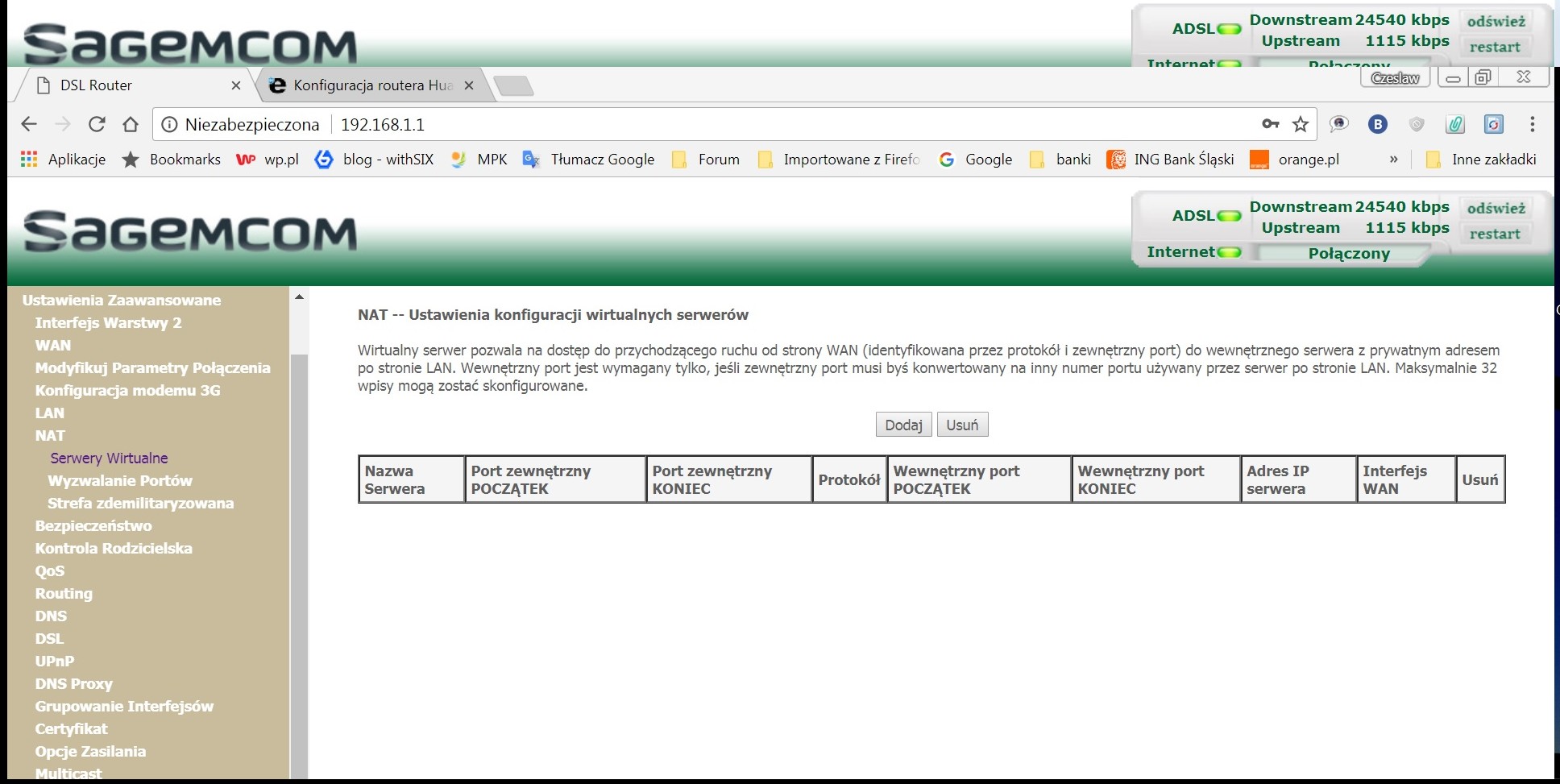

    Show a screenshot of where you tried to redirect this (hope you can handle it).
    It should be the Virtual Servers tab. In WAN port you enter this range, LAN port is the same and IP is the local IP of your computer, you can check them in cmd under the ipconfig command.

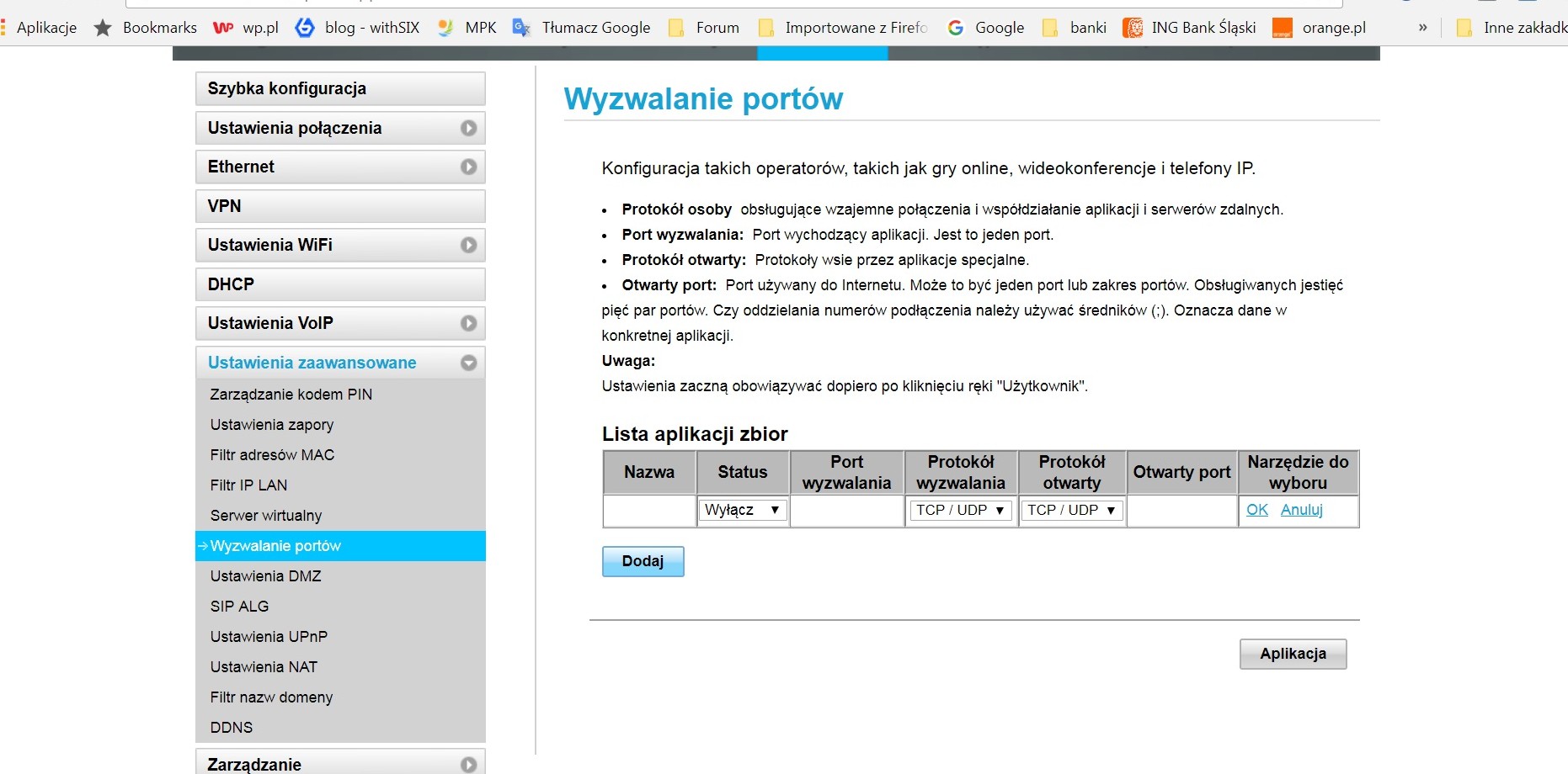

    Mother, what is this translation? Do you have automatic translation turned on in your browser? Turn it off because understand nothing goes. I don't know if UPnP is enabled because this translation is nonsense.
    As for the redirection, I am based on what I found on the internet.
    You can see what it looks like on Sagemcom F @ st 2704 in these tabs.

    Set English in B525 and see what the UPnP and port triggering tab looks like then.

    Forward the 2302-2305 UDP ports (WAN and LAN are the same) to your computer's IP and see if it works. I can't think of more because I don't play this game. There is nothing interesting in the screenshots from Sagemcom.
