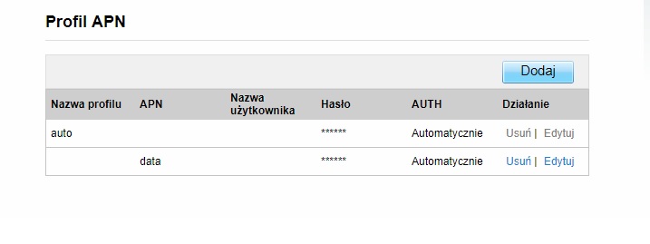

    I'm trying to fire up a public IP address, the operator theoretically included public IP in the business tariff, I set the APN as recommended, but does any of you know how it works in GSM networks,
    a different IP is given to me by the operator, on Wan, I have a different IP with the status,
    reading on mojeip.wp.pl I also have a different IP,
    on the link that I use on a daily basis from www.airamx.pl I have a public IP, which is the IP of my router, to which I can simply log in remotely, and on the router and redirect the ports that interest me and there is no problem with it,
    however, there is a problem with t-mobile, unfortunately they have no knowledge on the hotline.
    earlier this Huawei router works in a plus and there was no problem after logging into the camera public IP behind the router.

    I took another dedicated tmobile modem,
    I have set the APN Data
    (earlier I also gave the date on the plusgms modem and it probably didn't work because of it)
    now on modem
    huawei b525s-23
    already shows me on yourip.wp.pl
    correct public address, such as I am supposed to have,
    but this mod, no DMZ option, this version from tmobil
    and in turn, how do I redirect
    specific port and ranges, it does not work from the outside anyway.

    and in turn on the modem where I have DMZ
    while the APN cannot be set to date
    there is one that I can not delete automatically
    and it keeps having different IPs after every disconnect
    huawei b593s-22 (with plus gsm here on it like an e-mail card with plus worked for me remote logging in, or maybe the apn can not be changed because fv made under plusgsm from their apn, although the internet itself on this modem works with the t card -mobile, but the public ip cannot be obtained due to the inability to change the APN name)
    • Public IP Address in T-Mobile Business Tariff: APN Setup, GSM Networks, Huawei Router & Issues apn.jpg (25.67 KB) You must be logged in to download this attachment.

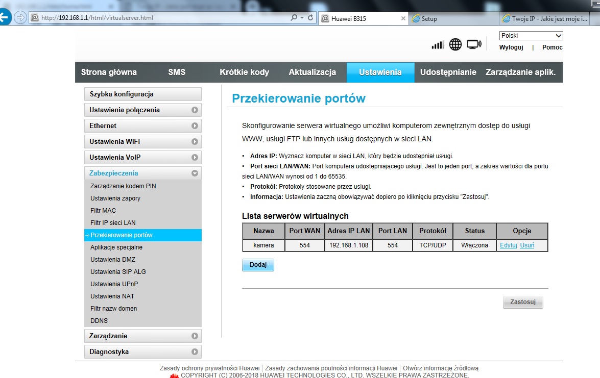

    I have the impression that in the tmobile huawei modem, when I look at the menu in the original firmware and at the tmobile, which is very poor, I have the impression that this is a deliberate action, maybe for security, because few people have Public IP and probably that's why redirects do not work, and when I take a modem from a plus with a card from tmobile, where everything in the plus works as it should, it is not possible to change APN to date (public IP support), probably that's why even public IP does not work, so I just have to either throw in either the original firmware (some combination) or get another unbranded modem I guess.
  • #14 17693182
    makosuu
    Posts: 2984
    Help: 369
    Rate: 370
    T-Mobile does not block any redirects in the software. These options do work :)
  • #15 17693233
    didotom
    Posts: 315
    Help: 7
    Rate: 21
    Interesting, it still does not work on the next router, ideas are slowly coming to an end, Public IP in line with what the websites will show, e.g. yourip.wp.pl
    the gateway on the camera is like the router address, the redirection of the rtsp 554 port on the camera as in the attachment, works locally, externally does not work, someone may have an idea?
    • Public IP Address in T-Mobile Business Tariff: APN Setup, GSM Networks, Huawei Router & Issues kamera1.jpg (200.16 KB) You must be logged in to download this attachment.

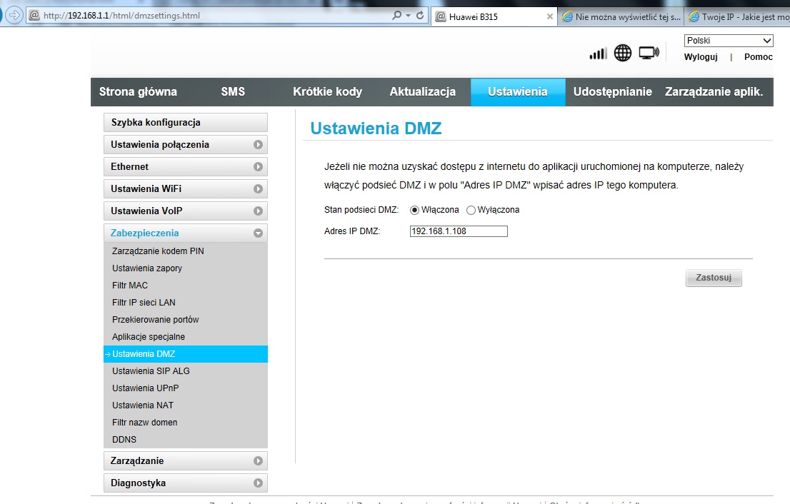

    With the DMZ itself, i.e. all traffic directed at the camera inside, there is also no access to the camera on the various http ports, so the DMZ does not work.
    this router is b315
    but I can see others had a problem too
    http://forum.jdtech.pl/Watek-huawei-b-315-zdalny-dostep-ze-swiata
    either tmobile is blocking the ports or DMZ and redirects do not work in these routers, which I rather doubt.
    • Public IP Address in T-Mobile Business Tariff: APN Setup, GSM Networks, Huawei Router & Issues kamera2.jpg (132.21 KB) You must be logged in to download this attachment.

    And did you read the post above? These Huaweies have very weak soft and do not need NAT Loopback.
  • #20 17693330
    didotom
    Posts: 315
    Help: 7
    Rate: 21
    but I do this remotely via team viver, so loopback has nothing to do with it
    makosuu wrote:
    Are you checking from a different network or from inside?
    I'm sure I check from another one :) whether it has a loopback I also checked locally, there is no.

    Routers were a problem, replacing unbranded ones helped
    topic is closed
    thank you greetings

    I don't know if it's the same problem, but I was able to find the cause for myself.
    I have three TMobile branded routers - Huawei 5G CPE Pro 2, B529s-23a and the older B525. They all have the same problem.
    I have a fixed IP address service at T-Mobile dla Biznesu.
    If the device's internal IP address has a different ending than ".1", then port forwarding does not work (eg 192.168.1.2).
    I need to change the device's IP address to one, e.g. 192.168.1.1 and then port forwarding works perfectly.
    It has to be some kind of BUG in the routers firmware or it shouldn't matter.
    I came to this solution through trial and error.
    I hope this solution will help you or other people who find my post.
