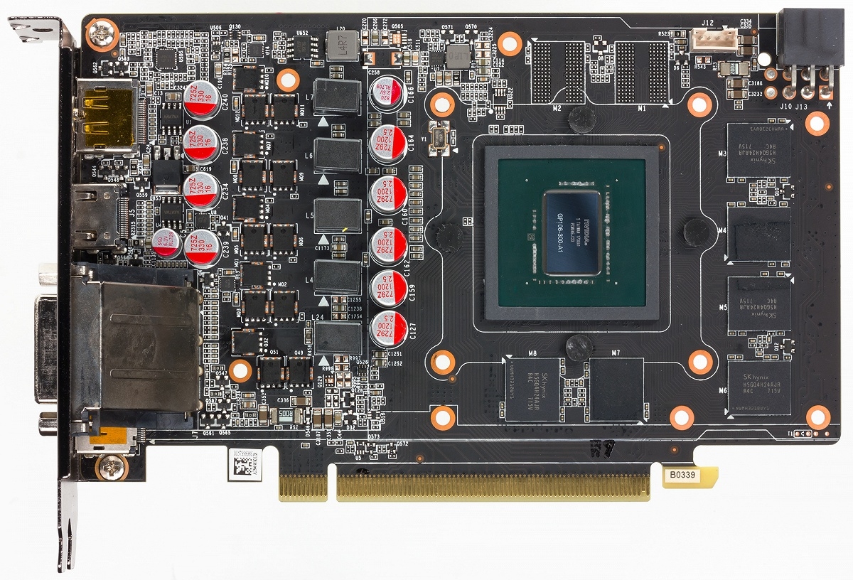

    I have a problem with DP ports not working. I have a GTX 1060 card and thus - 3 DP ports and one HDMi, I bought a DP -> HDMI adapter to connect two TVs.
    GTX 1060 Card: Display Port Input Issues with HDMI Adapter for Dual TVs - Possible Solutions
    However, when connected, there is no picture on tv. The computer sometimes detects one TV, sometimes two, but even if it detects it, the TV has no signal. 5 tested cables - the same for each. Adapters checked on another computer - working.
    Once, with the same adapters, everything was ok.
    What could be the reason for this? Because probably 3 Dp inputs didn't break at the same time?
    1. New, bought?
    - did you have it from the beginning, did you use (worked) on HDMI / eDP> only now you have bought an adapter to connect TV to HDMI
    2. What gpu card was used before?
    3. what motherboard?
    This card needs a PCI Express 3.0 x16 + 6-pin Power slot.
    _______________________________
    Ver. org.NV (standard) is 1xDVI-D, 1xHDMI and 3x DisplayPort.
    Other producers (Asus, Palit, MSI, Zotac, ...) change the number output. signal
    e.g. ASUS PH-GTX1060-3G (i.e. 3GB GDDR5) / ASUS Phoenix GeForce GTX 1060 3GB
    - NVIDIA GP106-300 / GP106-A1 Pascal chip (GP106-410), then
    1 ? DVI-D ((Dual-Link / HDMI))
    2 x HDMI 2.0b
    2 ? DisplayPort 1.4.

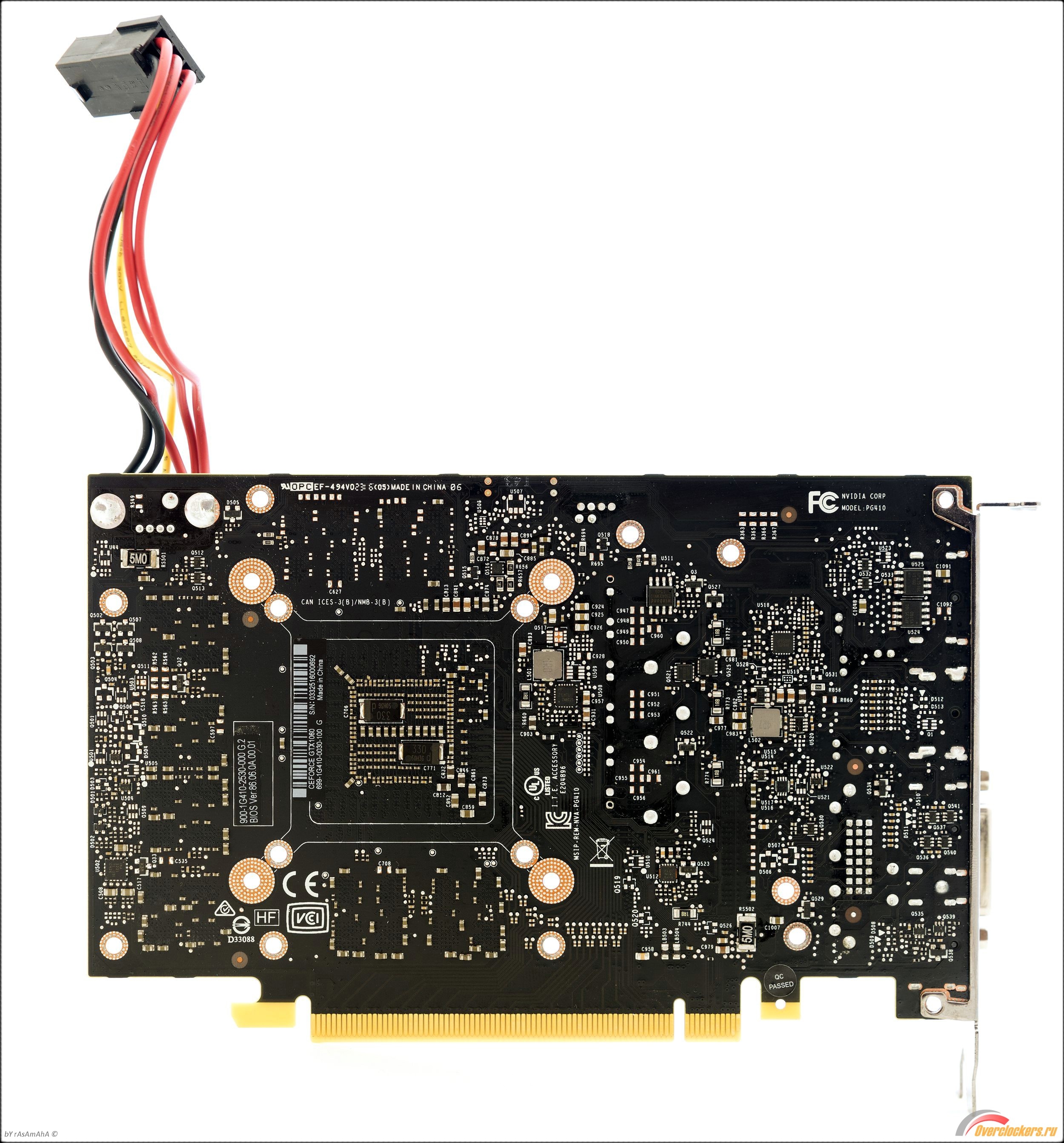

    GTX 1060 Card: Display Port Input Issues with HDMI Adapter for Dual TVs - Possible Solutions GTX 1060 Card: Display Port Input Issues with HDMI Adapter for Dual TVs - Possible Solutions

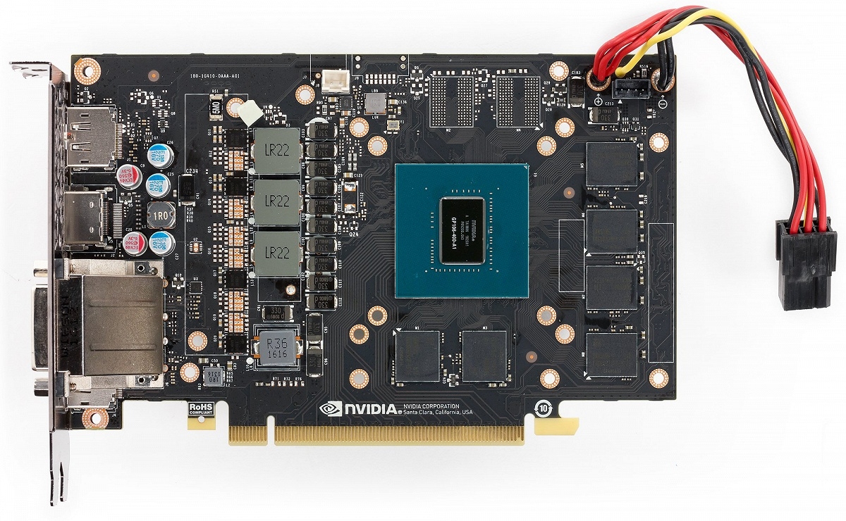

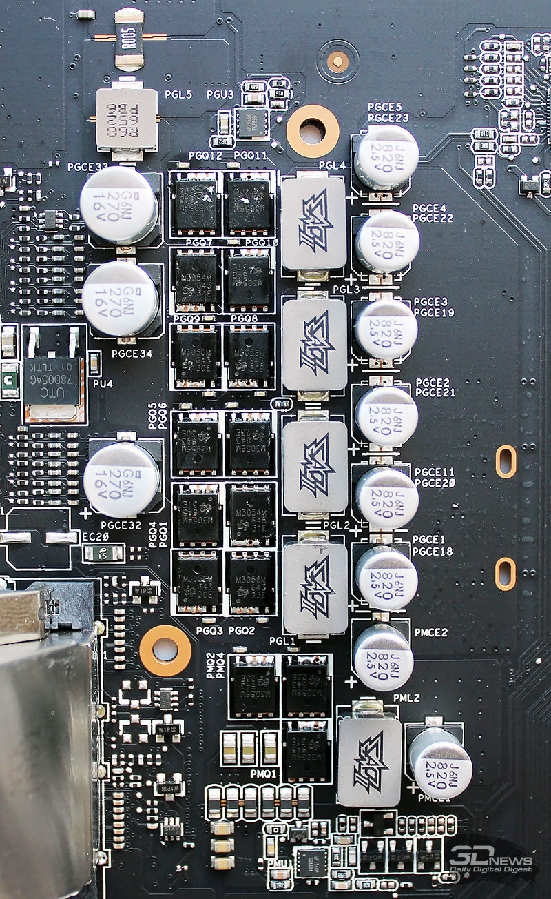

    there you have 4-phase power supply (3 + 1) NV chip with up9501P / uP9511Q + fieldbus controller
    :idea: It is not excluded that you "beat" the ports ... e.g. U501 (left corner _top)

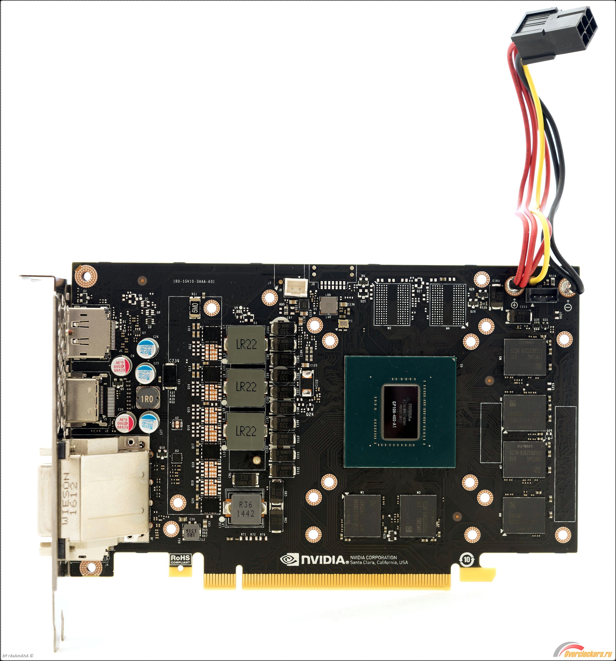

    ** below is a standard card from NV, based on it others ... create theirs with modifications

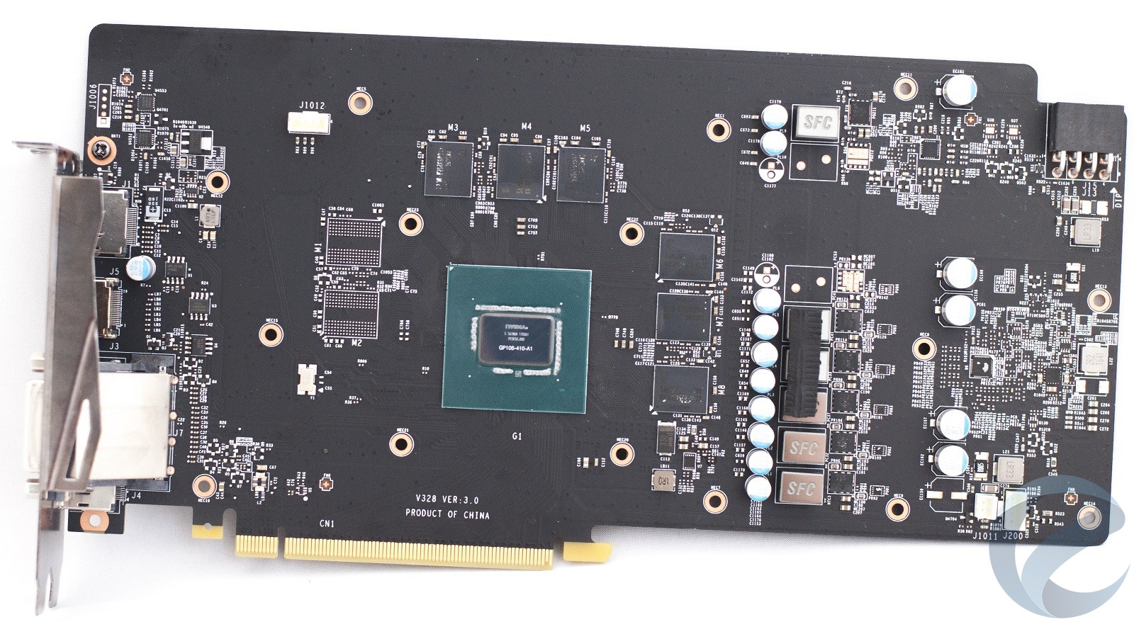

    ** below from MSI

    I bought a new one, about 1.5 years ago.
    I recently bought an adapter to connect a tv. About 4 months ago, the same adapters worked.
    Msi Mortar b150
    And what did I say "free" them
    E.g. connecting the TV to the card on "hot:> with both devices turned on!
    ps
    There may be an option that the TV (their HDMI) are broken.
    - connect a DVD player / TV tuner with HDMI output under the TV and see the effect.
    If there is no picture on the TV (with this connection), there is a defective circuit for HDMI on the TV

    when I connect the TV as a monitor, the picture on TV is - but it's HDMI - HDMi
