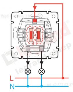

    Good morning.
    How to control the terrace lighting in such a way that it is activated by a motion sensor, with the option of manually forcing it to stay on continuously or not reacting to the motion sensor?
    Connecting the motion sensor itself is not a problem, I have used it many times for halogen lamps, but how to do it so that independent control is possible?

    Use a two-key switch (candlestick)? With the first section you power the motion detector and with the second section its output, i.e. lighting...

    No, type "candle switch" into Google... one that can switch on two circuits independently, one, the other or two at a time...
    Controlling Terrace Lighting: Manual Override and Motion Sensor Activation
    Instead of the second circuit, you add a motion detector and connect its output to the first circuit... and with one button you turn on the lighting on the detector and with the other button permanently...

    Well, two at a time, probably not good when the phase from the switch activated manually meets the phase from the motion sensor at the same time? Does it matter?

    I edited the post... your idea is also good, but I meant that you want to control the wall switch...

    Ariel N. wrote:
    It's probably not good when the phase from the switch activated manually meets the phase from the motion sensor at the same time? Does it matter?
    After all, you connect the same phase there, so everything will be fine. Do as he suggests tomek_wlkp. This is the simplest solution to implement and to maintain later.

    It turns out that the tomek_wlkp method is actually the easiest

    So don't look for an I-0-II switch on the wall because I haven't seen one like that before... Buy a normal candlestick one and do as I suggest. :)
