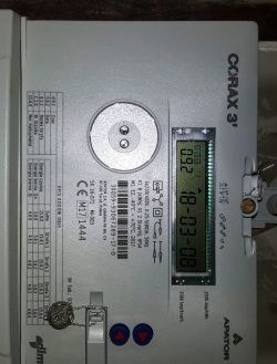

    Well just no. The counter counts in both directions. Does not add 1.8.0 to obis
    I explained everything earlier in the post
    shrek565 wrote:
    I have the same problem and I don't know what to do.
    When starting the installation, the counter at position 1.8.0. if 1.8.1 (3866.3) stops punching despite running washing machine, heat pump and dishwasher.
    At position 2.8.0 or 2.8.1, he starts punching the kilowatts supplied to the net (11.5).
    And in item 1.5.8.0 it sums up the energy taken from the grid plus the energy given to the grid (3,877.8).
    With Energi there is still no message that the received instance, although everything works as if the meter was already reprogrammed to receive energy. I'm in despair too, and I don't know whether to run or not .......
    I have real settlements turned on and I always enter the status on the page from 1.8.0, which means that it would not reach this status ...
    below photos
    Norax 3 Photovoltaics: Is 3kW Installation & Energy Meter Suitable for Donated Energy? Norax 3 Photovoltaics: Is 3kW Installation & Energy Meter Suitable for Donated Energy? Norax 3 Photovoltaics: Is 3kW Installation & Energy Meter Suitable for Donated Energy?

    Norax 3 Photovoltaics: Is 3kW Installation & Energy Meter Suitable for Donated Energy? Norax 3 Photovoltaics: Is 3kW Installation & Energy Meter Suitable for Donated Energy? From what I see, it is a 1-way counter and it must be replaced.
    These photos, what I put in, is a 2-way counter.
  • #37 18635141
    janekk77
    Posts: 29
    I have the one from the first photo and unfortunately it is unidirectional. In total, it shows the direction of energy (transferred-consumed), but still counts to the input. So it probably all depends on how they program it.
  • #38 18635204
    derekk
    Posts: 17
    Unfortunately, the Corax 3, despite being bidirectional, is not suitable for PV. This is the position of PGE (I talked about) now they assume a new one with the module. As for this super-intelligent meter that counts direct consumption, I had a conversation with Apator's service (producer) and they said that it counts "absolute value" or something like that and the meter will not stand still when the panels are working. Maybe it's programmed that. Starting PV installations is pointless because I gain nothing and the energy company earns. All that's left is to wait for the favor of PGE.

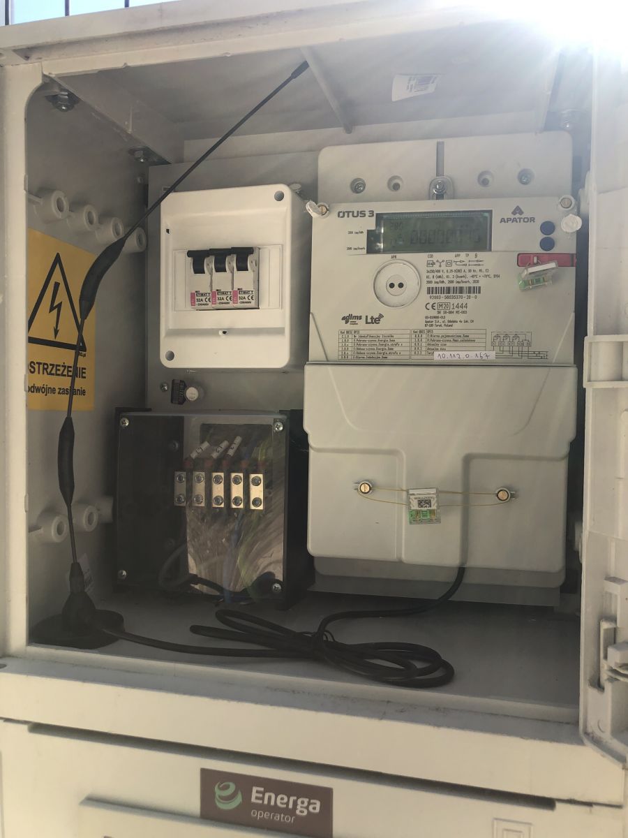

    If it is OSD Tauron, it is nothing to use, only ask for a certificate of assembly, needed for the application "my current"
  • #41 18640333
    slaslo
    Posts: 185
    Help: 24
    Rate: 56
    After all, you can see the Energa Operator sticker in the photo.

  • #43 18769942
    and_you
    Posts: 40
    Rate: 7
    I have NORAX 3 and I'm not complaining, it measures in both directions rather correctly. [G12 tariff]
    It was replaced a year before the PV, but after the installation was installed, they came and reprogrammed it. [I stayed at the G12]
    These meters count internally and record data in both directions, but may possibly add up the energy input as consumed before being reprogrammed. I heard that some of them had reprogrammed values on the energy abacus.
    It seems to me that the counter is ok - maybe there is still a question of what operator will program it.

    czaczus22 wrote:
    Hello. I have an exclamation mark in a triangle, in the Norax 3 bidirectional counter, what? He marks. Nowhere to find this marking, what kind of error it is.
    This is the terminal box cover open alarm. This means that the cover was opened since the last deletion or it does not fit well and jumped off itself (there is a pin that should fit well when it stretches somewhere, then it is like that later). In fact, the installer should check it before closing the replacement order.
    Added after 3 [minutes]:
    and_you wrote:
    What is the new OTUS3 - hmmmm - I have mixed feelings - remote reading is not everything ... because it has, for example:
    - Built-in contactor allowing for remote disconnection / connection of current paths
    - Power limiter with local control or DSM / DSR signals
    - Remote replacement of non-measurement software
    The built-in contactor is for remote disconnection if you do not pay the invoice.
    The power limiter is to block you from getting more power than contractual
    Remote software replacement is simply an update of the OTUS 3 meter software, it is such a small computer that has great possibilities.

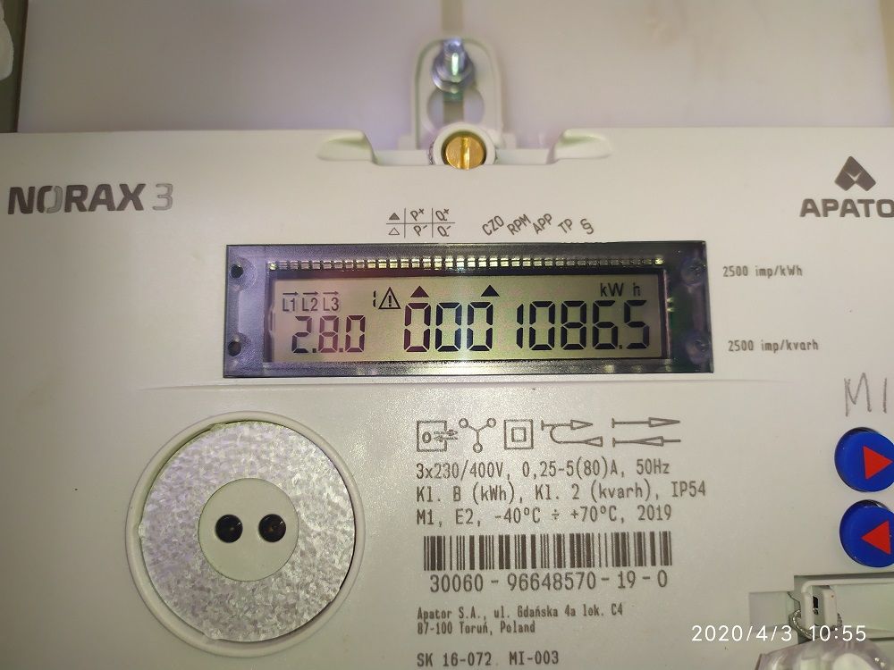

  • Norax 3 meter shows 32 kWh exported
    #45 20714827
    lampowiec
    Posts: 185
    Rate: 221
    Good morning!
    Well, now I think I'm going to bend everyone's mind...
    Hybrid photovoltaic installation, power source switches, 100% inverter output not connected to the grid.
    The Apator Norax 3 - 2.8.0. meter indicates 32 kWh of energy given up - unfortunately I don't know if this has changed since the installation was installed, I just checked it now.
    Is everything according to you correct?
    Greetings,
    Damian

    This counter is not programmed for bi-directionality - by default, it is manufactured in such a way that it can count supply and consumption. It all depends on which registers are read by the collector and settled by the DSO.

    bakupl wrote:
    I.e. - what is the best way to check (switching off power receivers is not an option) whether the power output from photovoltaics is not counted as consumption?
    1.8.0 active energy consumed
    2.8.0 active energy released
    If you don`t have 2.8.0, it means that donating counts as conscription.
    I had NORAX 3 and a test run on-grid: the transfer was counted as a consumption. I did not have the 2.8.0 code on the display
    After reporting the micro-installation to Tauron, I had the meter replaced with one with a SIM card.
    Norax 3 doesn`t seem to have remote reading capabilities.

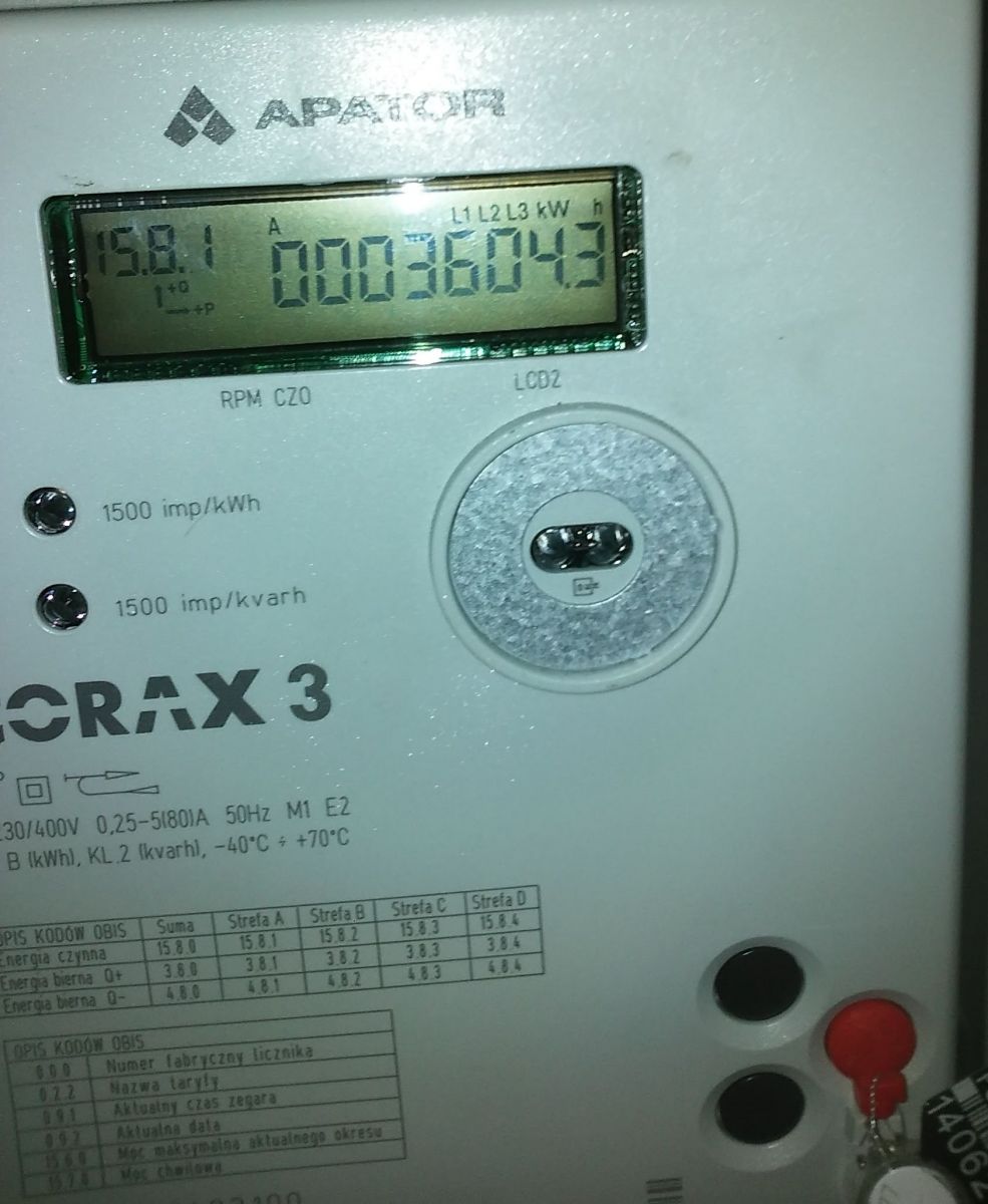

  • Check Norax 3 bidirectional registers 1.8.0, 2.8.0, 15.8.0
    #49 21043712
    k_pec
    Posts: 1772
    Help: 271
    Rate: 562
    bakupl wrote:
    The question is as follows - how can I most definitely check the correct programming of the Norax 3 meter for bidirectionality? That is, what is the best way to check (switching off power consumers is not an option) whether the power output from photovoltaics is not charged as a consumption?
    Check and compare registers:
    • 15.8.0 - total power counted by the counter (in both directions)
      1.8.0
      2.8.0
  • #50 21046022
    bakupl
    Posts: 43
    There are registers 2.8.0 and they are counted.
    Production is not included until 1.8.0
    15.8.0 - is the sum - and that's how it should be, but the clue is here: It depends on which registers are read.
    I think someone knows that it is supposed to read 1.8.0.
    Despite this, the installation is disabled for fear of being penalized.
    That's right - Norax 3 does not have a remote reading option

    bakupl wrote:
    That's right - Norax 3 doesn't have a remote read option
    Is a colleague sure about this word -.-- " agrees "?
    I have had this meter since 2020 and never in 4 years has there been a collector or anyone from PGE.... AND I can download from the PGE website my data every 5 minutes...
    Interesting....
    Electricity meter with a display showing 1086.5 kWh consumption. .
The discussion revolves around the suitability of the Norax 3 energy meter for measuring energy produced by a 3kW photovoltaic installation, particularly in the context of energy donation to the grid. Users confirm that the Norax 3 is a bidirectional meter capable of measuring both energy consumption and energy exported to the grid. However, concerns are raised regarding its programming, as some users report that the meter may not accurately reflect energy exported if not properly configured. The importance of notifying the grid operator about the photovoltaic installation is emphasized, as it may affect the meter's functionality and the user's ability to benefit from net metering. Additionally, users share experiences with different energy companies and the challenges of accessing remote readings and data from the meter.

What is 15.8.0 and why is it higher than 1.8.0?
15.8.0 records absolute energy flow (|import|+|export|). It will always exceed or equal 1.8.0 because it adds both directions [Elektroda, piwalek77, post #18584945]
Edge case: Can the meter count PV generation as consumption even with 2.8.0 present?
If programmed for “absolute” billing, the DSO may read 15.8.0 instead of 1.8.0, charging you for both flows; one user reported this mis-billing risk [Elektroda, theo33, post #18634346]

Does Norax 3 support remote disconnection?
Only OTUS 3 carries a built-in contactor for remote cut-off; base Norax 3 models lack this feature [Elektroda, and_you, post #18769942]
