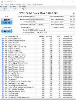

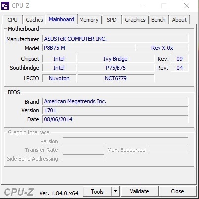

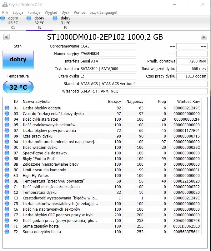

    Hello. I uploaded a new original Windows 10 pro 64 bit and after updating and uploading the programs I needed, I had to leave for two days. I arrived today and some applications are not working in the system. I will add that sometimes I have that when turning on the computer I have to turn it off on the power supply because I have a black screen and the second time the system starts up correctly. I don't know what's going on. Below is the computer specifications.
    Asus P8B75-M motherboard
    The power supply is Corsair VX450W
    Silicon Power S55 120GB SATA3 SSD
    The processor is intel core i7 3770
    32GB DDR3 memory
    I will add that I did scans DR.web, malwarebytes, AdwCleaner, but nothing was detected. I will add that all of this has gone away.

    Insert all 3 SMARTs from disks with partitions C: E: and F :.
    Place the CPU-Z tab.
    Describe the visual condition of the capacitor tips on the motherboard - whether they are swollen / cracked.

    Personally, I see 2 problems - cold start and maybe infection or error in OS.
    Ie. you turn on EXE and nothing happens?
    Post logs from FRST:
    https://www.bleepingcomputer.com/download/farbar-recovery-scan-tool/
    As for SMART disks, there are no serious problems, but the SSD to improve the signal cable, or to replace it with a 100% functional / new due to on (C7) - for monitoring.
    Elder Seagate - to monitor (BC) - did not answer the command once.
    In general, if there is a problem with the cold start, immediately compare the new SMART with the old one.
    Power supply to measure:
    https://www.elektroda.pl/rtvforum/topic1199202.html
    at cold start with focus on + 5V PG / SB.
    The power supply can also be replaced with another branded one.
