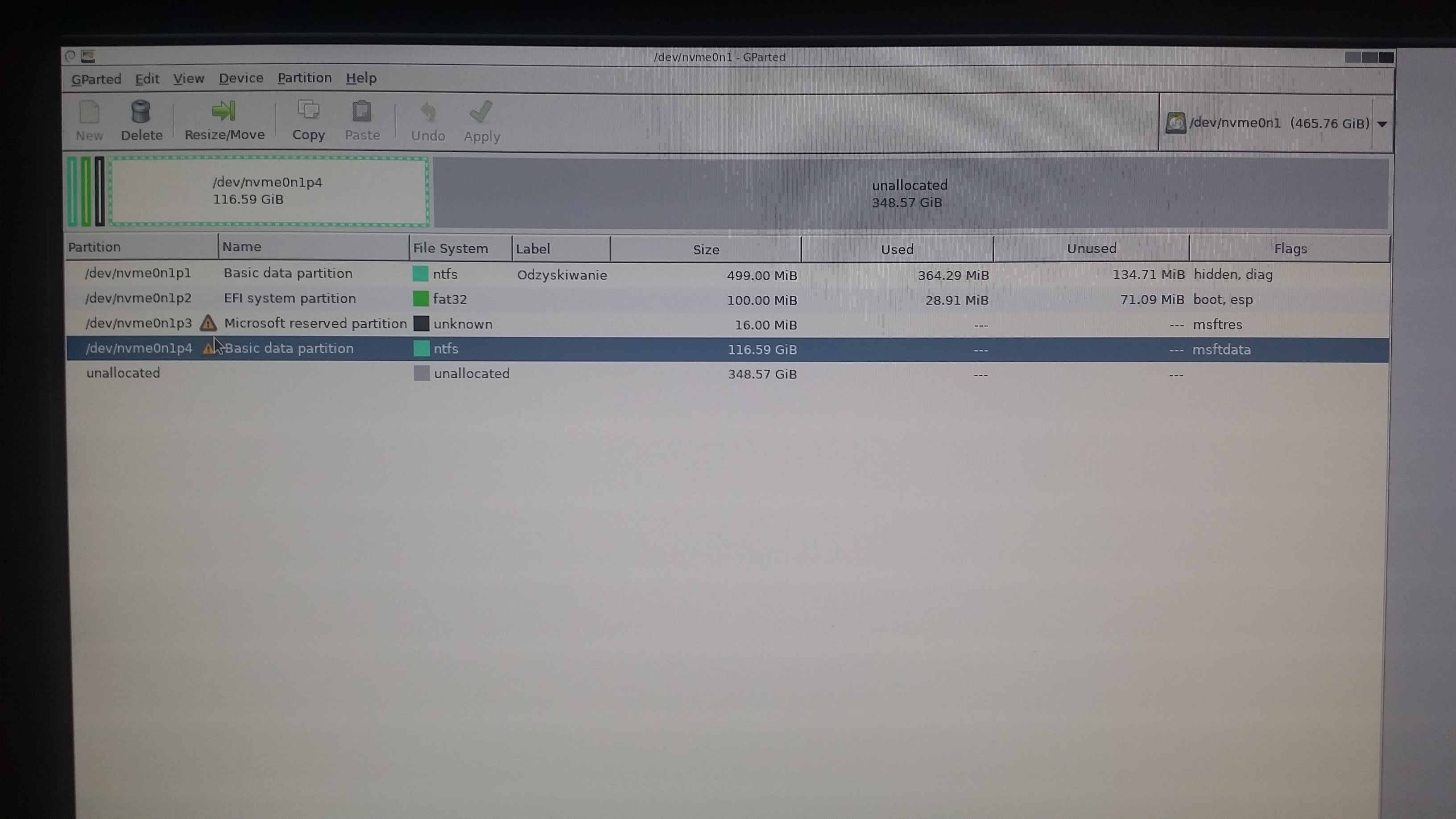

    The gentlemen picked up a new computer from the store and turned off the electricity when installing the W10.
    Computer specification:
    Case SilentiumPC Gladius M35 (SPC128)
    Asus PRIME Z370-A motherboard
    SilentiumPC Supremo L2 550W (SPC139) power supply
    CPU cooler SilentiumPC Fera 3 HE1224 v2 (SPC144)
    Corsair Vengeance LPX memory, DDR4, 16GB (2x8GB), 3000MHz (CMK16GX4M2B3000C15R)
    Samsung 960 Evo 500GB M.2 PCIe SSD (MZ-V6E500BW)
    Intel Core i7-8700K, 3.70GHz, 12MB, BOX (BX80684I78700K) processor
    Graphics card Asus GeForce GTX 1060 6GB GDDR5 (192 bit) 1x DVI-D, 2x HDMI, 2x DisplayPort (STRIX-GTX1060-6G-GAMING)
    When firing, I have these situations:
    Error 0xc0000428 after loading
    I choose instalke from UEFI - crashes error 0xc0000428
    I choose 64x in - windows \ system32 \ boot \ winload.exe + error 0x0000225
    installs in 32 (copies files) - after reset (copying files) crashes error 0xc0000428
    Only at 32 the installation window pops up. In case of 64 standard rules in 3 points ... put cd, choose language etc.
    Question no:
    1. How to fix error 428?
    2. Isn't it better - faster to do the ssd format (I think there is the main problem here) from the usb level and starting the computer.
    I am with computers from 10 years back so I am asking for detailed guidelines ;)

  • #17 16927301
    Bullitt
    Posts: 134
    Rate: 8
    Board Language: polish
    Windows 10 Update Interrupted: Error 0xc0000428, Intel Core i7-8700K, ASUS Prime Z370-A & GTX 1060
    From here it was exactly on the usb .. but okay. I'll try. Maybe the cd will start .... it is possible that the disk has died? you can see him normally .. partitioning ... only has a problem with windows. Maybe something in Bios rearranged? (standard settings)
    I also fired up the partitioning program and I see exclamation marks - what is it?
    It is possible that the partition that you need is not booting?
    After expanding the exclamation mark, I have:
    unable to read the contents of this file system!
    Because of this some operations may be unavailable
    the cause might be a missing software package
    Nowadays:
    I did a re-format, but I did not set anything (partition and file system), the installation from usb does not go (this downloaded znetu - hal.dll file is missing) are damaged during installation?
  • #18 16927433
    marcinadd
    Posts: 481
    Help: 69
    Rate: 86
    Hmm .. Interesting case. Recently, I have switched to a computer with a very similar specification, even with this disk, but I did it like that. Download some Linux for yourself (I don't know if this GParted will have it installed, or it can be installed). I recommend downloading Ubuntu.
    1. In GParted you create New Partition Table-> GPT
    2. You have free space at your disposal. You create a new partition -> FAT32 Capacity for example 512MIB aligned to cylinders
    3. You create another NTFS-formatted data partition (Reserve Partition, I can't remember whether it will create itself or not, but in any case it is not required).
    4. You go into Terminal and type sudo cfdisk / dev / nvme0n1
    5. You select this FAT32 partition and set TYPE to EFI Partition (or EFI System I don't remember exactly). Write and you're done.
    6. You boot Windows and select that empty created partition and it must spin :D
