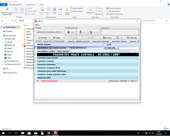

    I recently purchased an ISD-02 interface.
    When configuring CD-2502 I cannot find the option to change or read the installer code via the interface.
    In the manual I read, among others:
    The administrator password can be changed in the [Parameters - grouped by functionality] tab.
    And in the description of the tabs -:
    Parameters - grouped by functionality -
    Parameters available in the control panel in the P-1, P-2 and P-6 procedures (change of the installer code), as well as the control panel identification parameters (serial number, control panel data type identifier, object identifier) grouped into function blocks.
    I sent an email to Laskomex a few days ago, but no one replies.

    Thank you for your answer. I know the procedure for changing the code "from your finger" very well, but I asked about changing / reading the code from the ISD-02 level.
    in the attachment there is a screenshot with the tab where it should be as in P-6, i.e. change of the installer code.
    • Laskomex cd-2500 Change of the installer code by means of ISD-02A test.png (117.98 KB) You must be logged in to download this attachment.

    I must have already rewound everything, unfolded what was to be rewound :D
    I can change the serial number - there is no such possibility with my finger.
    Based on the serial number, user codes are generated (I also read that somewhere). Installer code if default is the same as serial number.
    I have tried this option. By changing the serial number, the installer code does not change to the default along with the serial number.
    So still nothing.
    For posterity: :D
    After talking to the Laskomex service, the nice gentleman admitted that there was a mistake in the manual.
    The installer code on EC2502 cannot be changed via the ISD-02 interface.

Not directly. Older boards without the 10‑pin ISD header need an adapter to reach memory via the processor port. Reading may still be impossible. Options include doing a RESET‑INIT or asking Laskomex for adapter plans and building it yourself. [Elektroda, Serwis_LX, post #19276340]
Does the ISD‑02 software include the adapter wiring plan?
No. The software will not show you which pins to connect. Laskomex can provide adapter plans upon verified request. Miswiring risks frying boards, so do not attempt trial‑and‑error wiring. [Elektroda, Serwis_LX, post #19277011]
How many tries would brute‑forcing the installer code take?
With a 4‑digit code, there are 10,000 combinations. At 30 attempts per day, you could hit the code within a year. This is a theoretical point and not a recommended practice for ethical, legal, and operational reasons. [Elektroda, Serwis_LX, post #19276340]
Where is the on‑panel procedure to change the installer code documented?
See the product documentation, section 8.6. If you don’t know the current installer code, check section 8. If no code was defined, the serial number functions as the installer code. [Elektroda, kocans1025, post #17179041]
Can I clone PINs/RFIDs from a damaged EC2502 using MLX or ISD tools?
An installer reported copying “PINs and RFIDs” from the 24C64 memory of a lightning‑damaged EC2502 using MLX. This can help recover resident access credentials before replacing hardware. Handle chips and dumps carefully to avoid further loss. [Elektroda, martin-76, post #19277760]
What does RESET‑INIT mean on Laskomex systems?
Laskomex uses “RESET‑INIT” to describe a full reset to factory settings. Use this when recovery via ISD‑02 or adapters is impractical, or when you need a clean start. Back up data if possible. [Elektroda, Serwis_LX, post #19276340]
Acting for a homeowners’ association, how do we get official access from Laskomex?
Laskomex can accept the unit and change the code to one you request, but they won’t disclose the changed code. They consider requests with an official letter from the legal owner on letterhead with signatures. [Elektroda, Serwis_LX, post #19278640]
