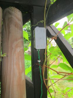

    @kriss032 16 Amp cam switch.....It made me ..twisted :cry: .... What current flows through this wire-antenna? You couldn't put a relay in there and even remotely control it?
  • Fake IP65 cam switches failed outdoors; 6-pin connectors worked

    I know that I overshot 16A is a bit too much, There are a few milwatts of Wcz current in the mower's wire. I needed hermetic switches to be installed outdoors in damp conditions and only such I found CAM SWITCH 16A 3F 1-0-2 IN IP65 HOUSING or CAM SWITCH 16A 3F P-0-L IN IP65 HOUSING. But ............ I installed the first connector the next day it broke I installed the second connector jammed in a moment I replaced it with the third connector also failed the connectors were purchased from different sellers it seems that the whole series is fake. The sellers returned the money without hesitation, they probably knew what they were selling. I wasted two weeks of time and connected the wires briefly 2x6 pieces 1 field in front of the house 2 fields behind the house plus dividing the second field in half. I learned it by heart. The mower from the description covers a field of 500 m2, there is no division of fields in the program, my lawn is 500 m2, it is not in the shape of a square, it is intricate and complicated, it has many niches. It needs a mower for 1500 m2. Later, I installed 6-pin right-left connectors for PLN 9 each and they work, they are not hermetic after winter, I will probably have to replace them.

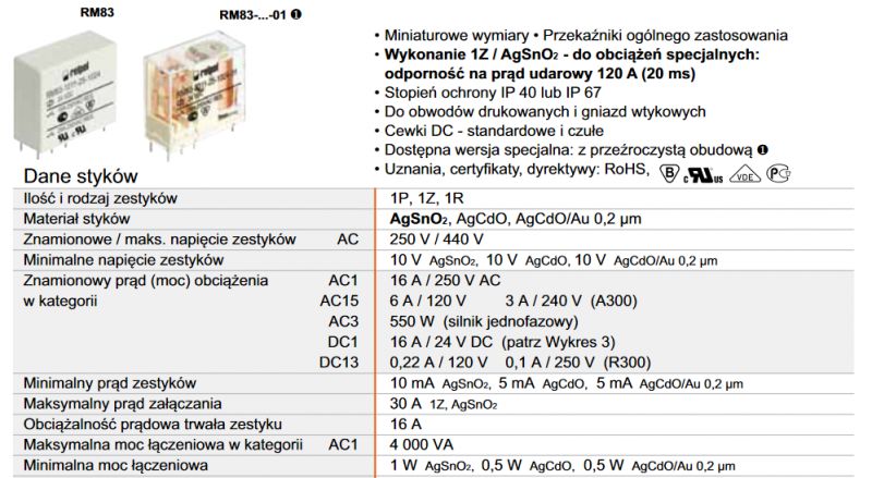

    Connectors physically blocked or stopped connecting?
    16A connectors have contacts designed for high currents.
    At milliamperes, there is no burn-in effect of tarnish on the contacts and the contacts must be gold-plated, etc.
  • Burnt switch contacts causing intermittent breaks

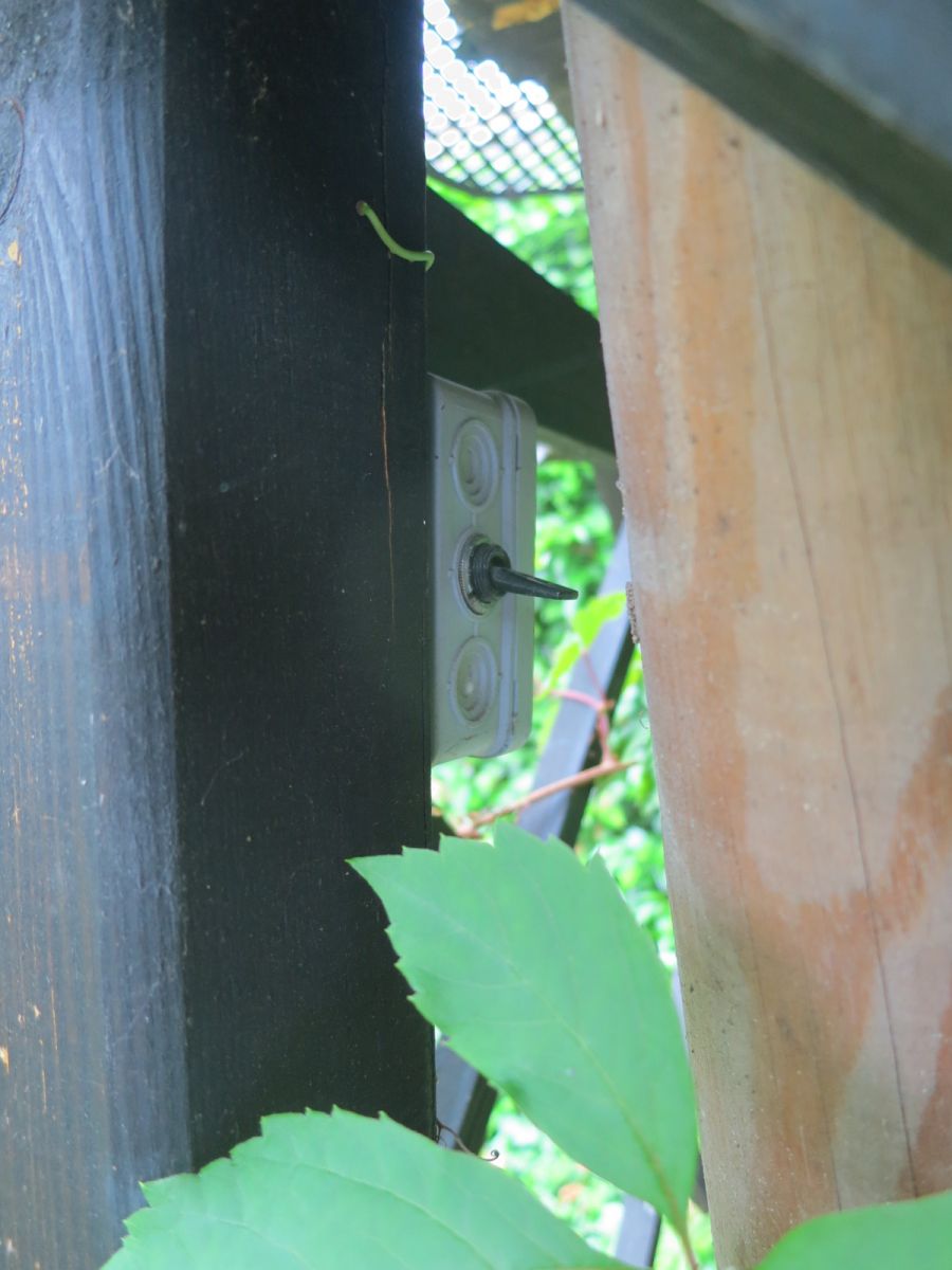

    One switch was jammed after installation, the other switch was also jammed, I turned it as if I could force it, but it started to jam and creak when switching, it made a sound as if the contacts had fallen apart, it walked with resistance. All connectors worked after installation and began to have contact breaks after an hour or a few days. Please write more clearly what the effect of burnt contacts means.
    Are these contacts not suitable for low Wcz currents in mowers?

    @kriss032 I don't understand it at all.16 A :cry: ..... any 12 volt relay, inserted into a hermetic can, if you absolutely want to bury it, e.g. and remotely switch it by applying voltage to the relay from even a penny power supply for LEDs. What about a simple rocker switch? There are also versions with a rubber cover.
  • Toggle switch used to exclude mower zone

    I have a similar solution, but I used an ordinary toggle switch in a plastic housing from the market. I have wires from the lawn led to the leg of such a gazebo and I exclude a certain zone from the operation of the mower. So far I haven't had any problem.
    Break in Robotic Mower Perimeter Wire: Finding & Repairing a 500m Cable with 3 Years of Use Break in Robotic Mower Perimeter Wire: Finding & Repairing a 500m Cable with 3 Years of Use
    It is in the down position - i.e. the excluded zone, the mower does not enter part of the lawn, I can put various objects there, e.g. cut branches.
    High-current contacts are made of refractory materials, which become covered with oxides after some time.
    These oxides are a break for low voltages, which burn out only at appropriate currents.
    In the better catalogs, the minimum currents are given, which ensure the burnout of the oxides:
