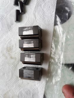

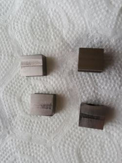

  • #9 17187871
    kritu100
    Posts: 174
    Rate: 35
    Hello. I dismantled the pump today, but I can't tell which parts are to be replaced. Can someone help me identify damaged parts? Replacing Delphi CR Pump on Focus MK1 1.8 TDCi (2003): Can a Bosch Pump from Focus MK2 Fit? Replacing Delphi CR Pump on Focus MK1 1.8 TDCi (2003): Can a Bosch Pump from Focus MK2 Fit? Replacing Delphi CR Pump on Focus MK1 1.8 TDCi (2003): Can a Bosch Pump from Focus MK2 Fit? Replacing Delphi CR Pump on Focus MK1 1.8 TDCi (2003): Can a Bosch Pump from Focus MK2 Fit? Replacing Delphi CR Pump on Focus MK1 1.8 TDCi (2003): Can a Bosch Pump from Focus MK2 Fit?
